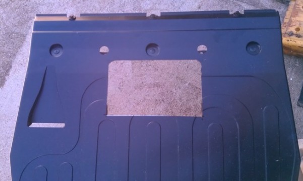

Cut an access opening where the oil filter is mounted, there will be no need to remove the "Front Under Cover" for oil changes.
