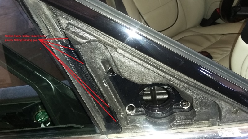

Okee dokee, finally have a fix at least for the door mirror housing wind noise
Took the car in to to Prestige today and took the door card off to investigate, I was correct, the door mirror housing area is where the wind noise eminates from.
Firstly and as pointed out previously, the external mirror seal is poorly fitted ( or so I thought ).....On checking several other cars of the same type, year etc they are all absolutely identical. I would therefore imagine that you all have the same poorly fitted seal on the exterior of your cars too.
Taking the door card off, then removing the mirror seal and finally the mirror itself, reveals the interior foam / rubber seal.
This also is poorly manufactured / fitted and leaves a substantial gap around the housing, hence the wind noise, see pics below.....
using black silicone sealant we filled this gap internally and then adjusted the seal as best we could and buttoned it all back up, reinstalled the mirror housing, seal and door card
We then added black silicone sealant around the exterior seal, filling the gaps there too for good measure.
Road tested ( at considerable speed, triple digits for good measure ) and bam, no wind noise from that area, now totally eliminated

Thanks Jim for tracking this down, my passenger side mirror has an issue but I haven't had time to take it all apart, this will give me a head start for sure. Funny, that (fitment) was something I noticed right away and told my wife it would be the wind noise issue. She drives the car 95% of the time and actually asked last week when I was going to get around to fixing it so this will push me forward now.

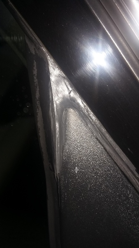

For those that this may affect, I finally got around to adding a couple of pics
These are of the external door mirror housing seal, unfortunately I have no before's of my drivers side ( which was the worst, but the passenger side isn't much better)
On aside note, having checked several similar cars they all look the same!!
Here's the passenger side..... Note the poor seal around the top apex of the seal set up!
Here's the drivers side after......note the use of black silicone sealant to get the best possible finish.
I suppose it's fairly obvious close up, but a few feet away it's totally invisible.
I still believe it was the interior seal fix that resolved the issue, however, perhaps this also had a part to play.

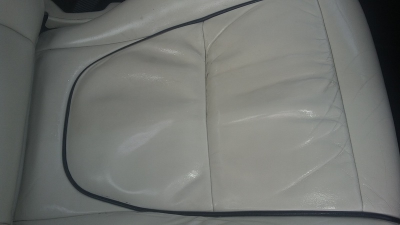

So, I was trying to remember if I actually had cleaned my leather or had just conditioned it, but checked back and saw this post.
The reasoning behind it
As I had done my mates X type a week or so ago, I thought I'd check mine and did a 50/50 on the front passenger seat, see below.....
Ok so it's not horrific or even a night n day difference, but I was surprised to see just how dirty it had become in a little over 18 months.
Autoglym leather cleaner and nail brush used, then wiped over with a clean microfiber. Then it was treated with Autoglym leather conditioner......did all the door cards, glove box etc too, so she looks really clean n smells great too, all good.
