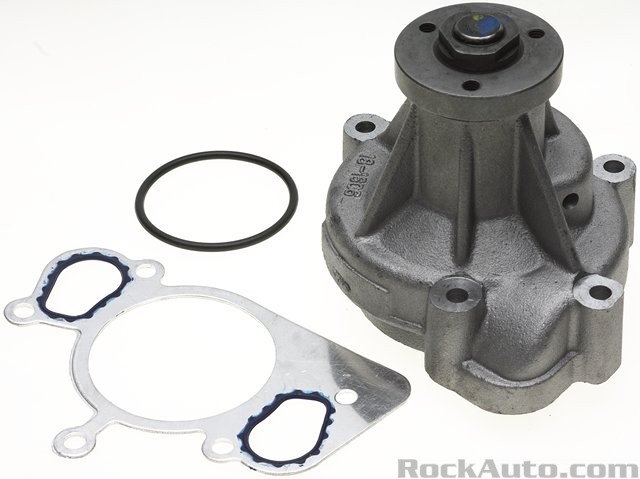

Some pumps are like the OE design - a one piece pump with the factory type steel and rubber laminate gasket. They look like the one in the photo. Cheap replacements use a paper gasket and are of a two piece design. I've had premature failures of the two piece types and particularly the paper gaskets. I used an ACDelco pump recently that was of the proper design.
