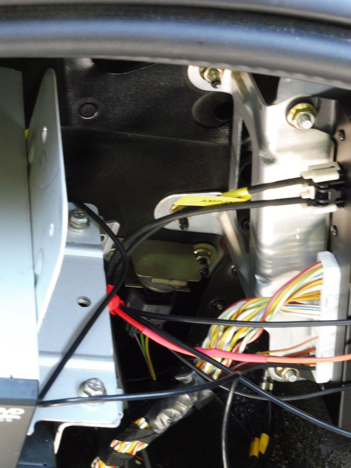

Can anyone tell me what this connector is for?
It is in between the amp and the module stack on the lhs trunk wall.
There is nothing like it on the other side of the trunk.

The D2B ICE connection under the rear seat is "open" i.e no loop as was the case for the D2B connection in the trunk.
So it cannot be linked to any system. All very puzzling to me so far.
The wiring diagrams are of no help as they simply have the ICE components mapped out with nothing that would indicate a D2B link vs an electrical link.

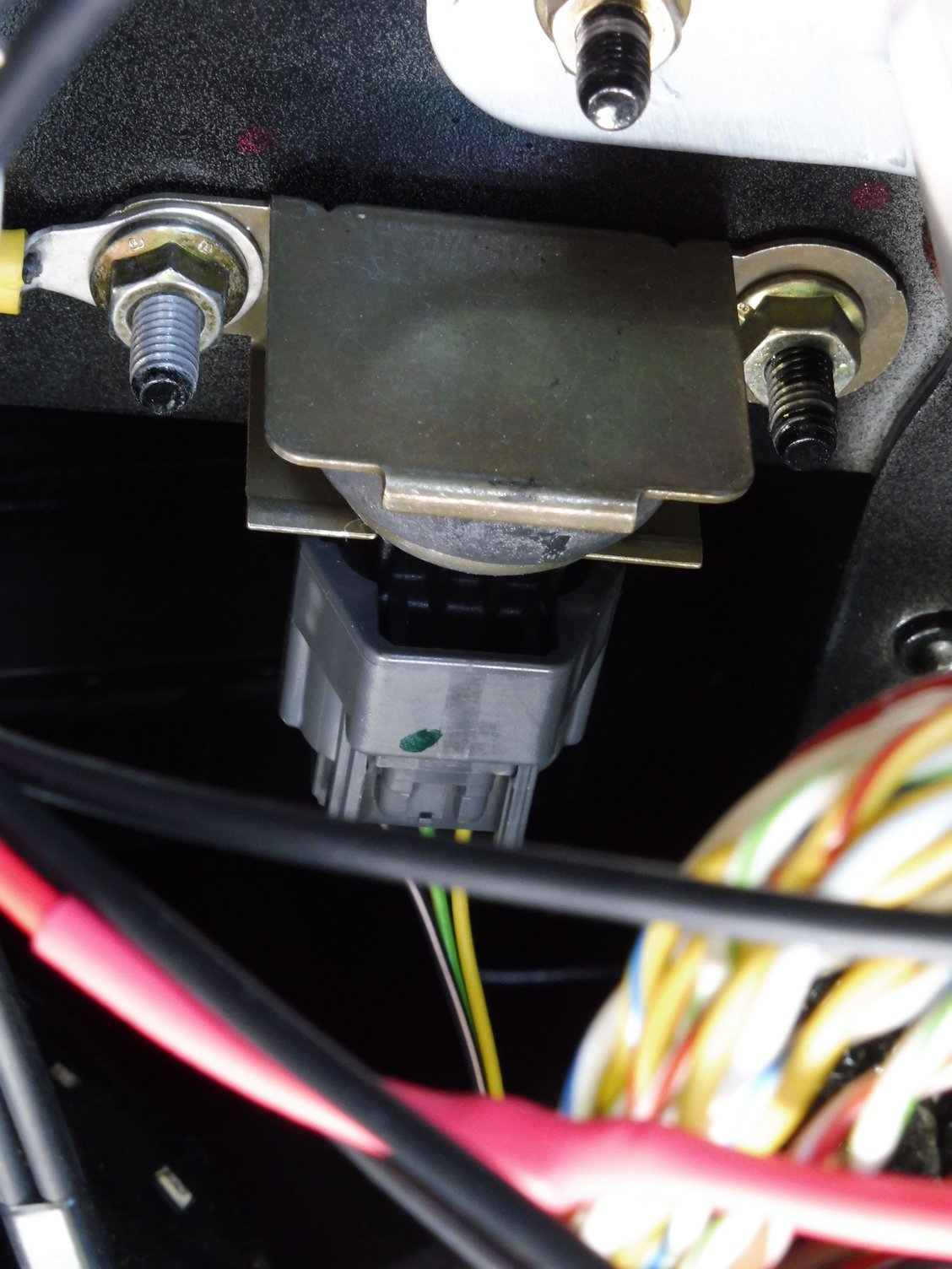

Looks like the rear YAW RATE SENSOR to me??

When I look up yaw rate sensor on Ebay 2M5T14B296AC It looks a bit bulkier than what I am looking at. However at least one post in here suggest what I am looking at is the correct position for a yaw rate sensor although many more place it up front.
I need to take what I am looking at off carefully as the nuts look to be fairly fragile grounding point either side. At least one post in here says that is the position of the yaw rate sensor however many more place it up front.

Ok it is a suspension control sensor xw43-3c190-ab.

From the workshop manual it matches the drawing of the Vertical Accelerometer (one each end of the car).
The oddity however is that the 2004 and 2008 Electrical Guides both describe it as being on the RHS of the trunk/boot.
Edit: however the 2004 Technical Guide shows it on the LHS !
