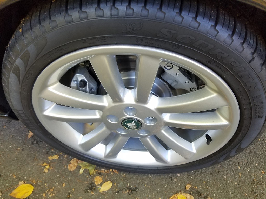

4 wheel Akebono pads, paint rotor hats and ebrake calipers, clean, fresh dot 4, clay bar wheels...Name:  20161010_112257_zpsloqj9cnw.jpg

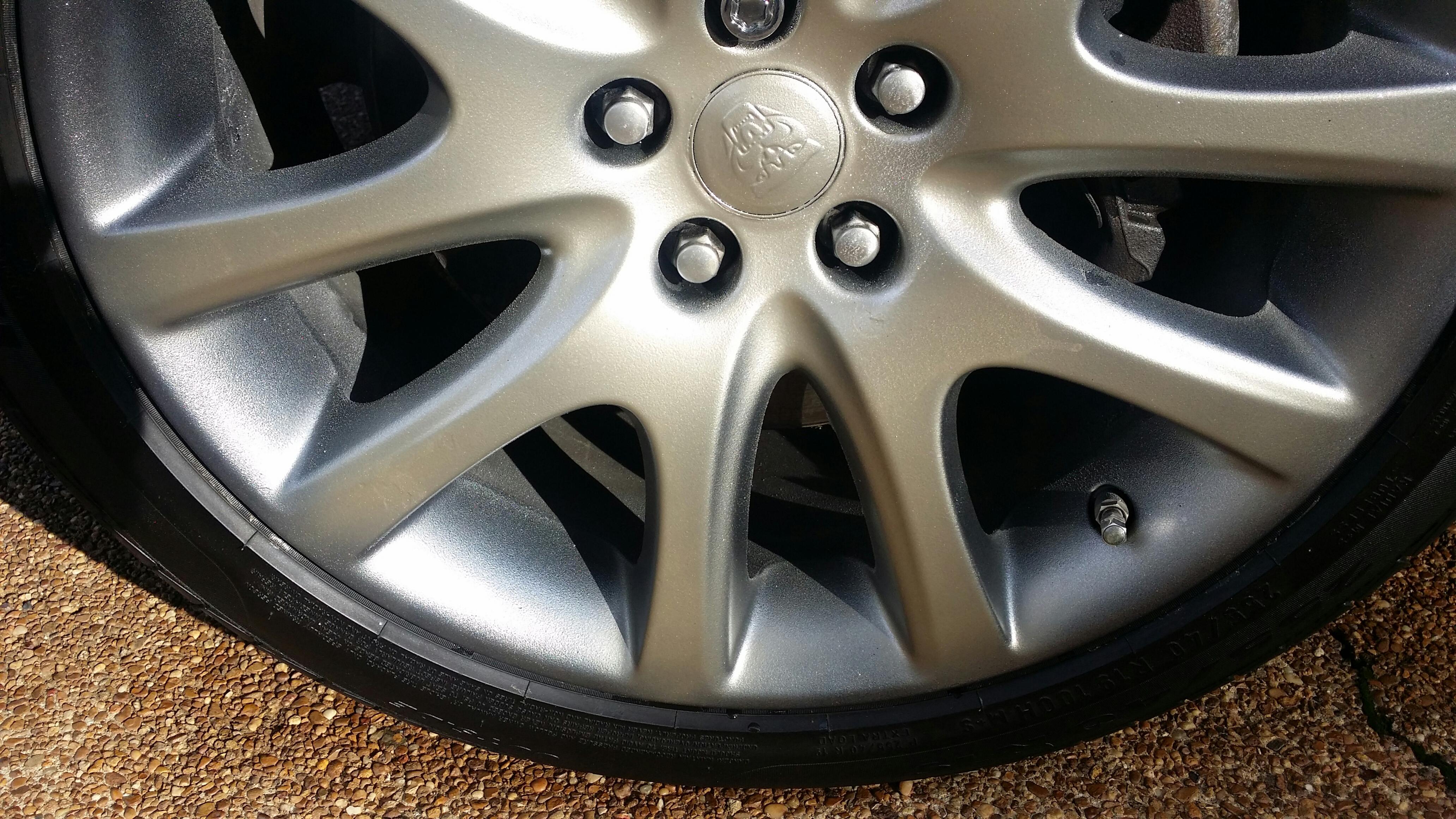

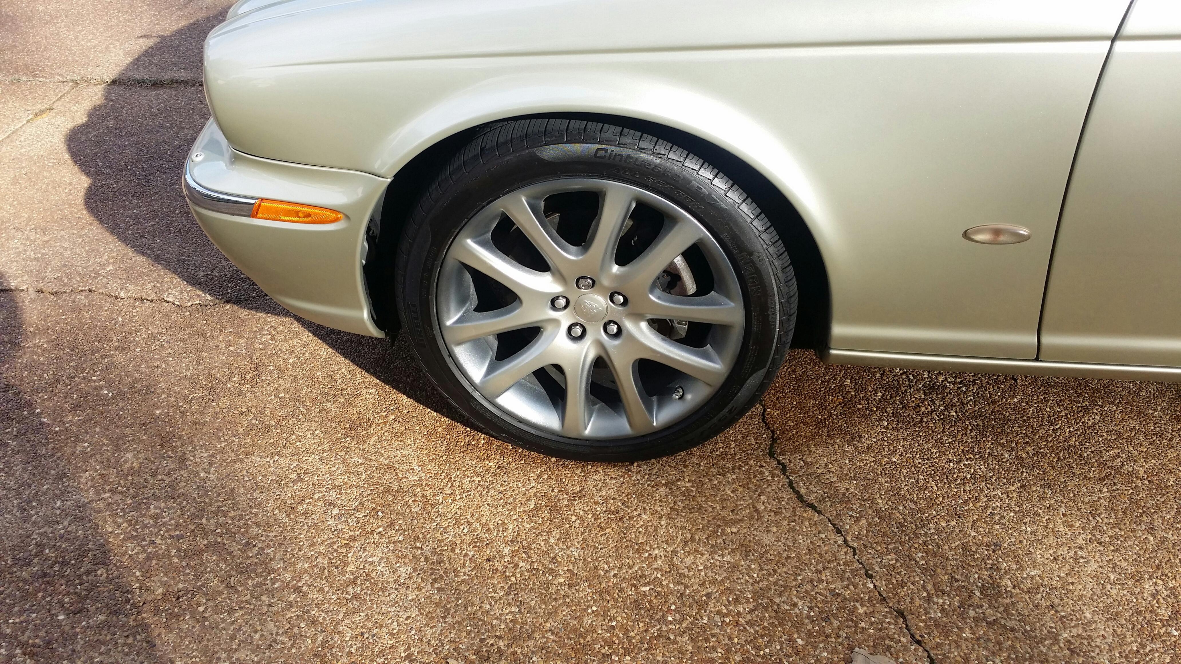

This!.. Plasti Dip!
From Black to Silver Metallic to Raw Titanium Pearl, which created a Gold & Silver look depending on what angle you're looking from. I'm gonna post a thread & video etc...

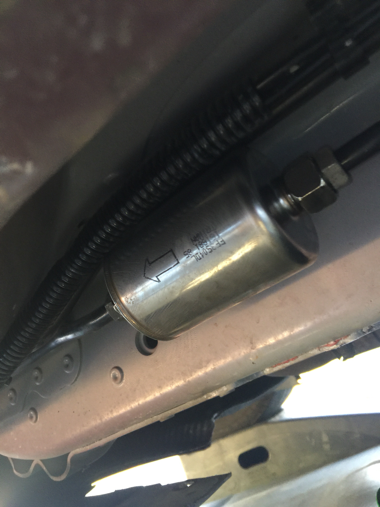

Fuel filter and oil change.
