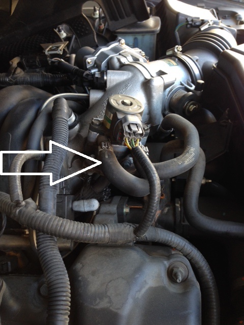

It's bulging and leaky and I want to replace it but I'm not sure what it's called. If anyone know the part number that would be even better! Thanks in advanceWhat is this hose called?-photo-2.jpg

Welp, I ended up figuring it out after a couple hours. Those two hoses are the coolant lines for the EGR valve. The part number is AJ88514 for the hose on the left and AJ811758 for the one on the right. I ordered both of them for a total of about 30 bucks.
