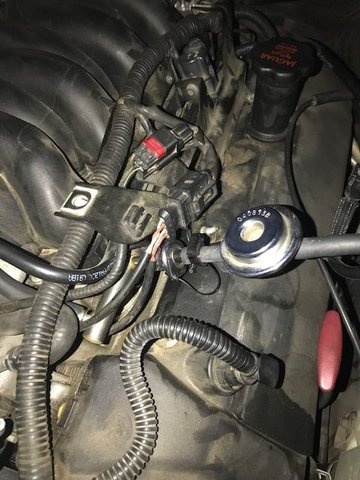

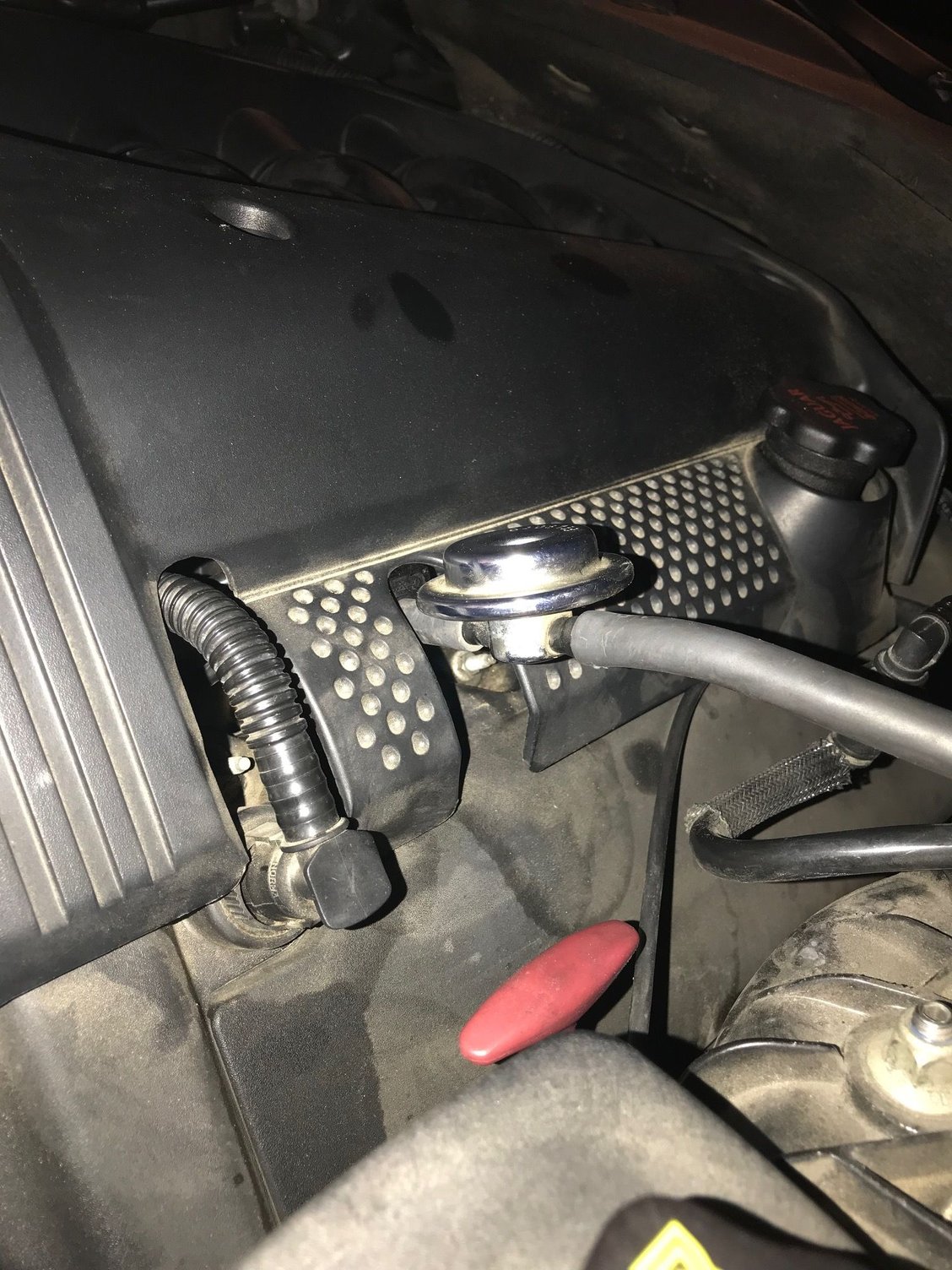

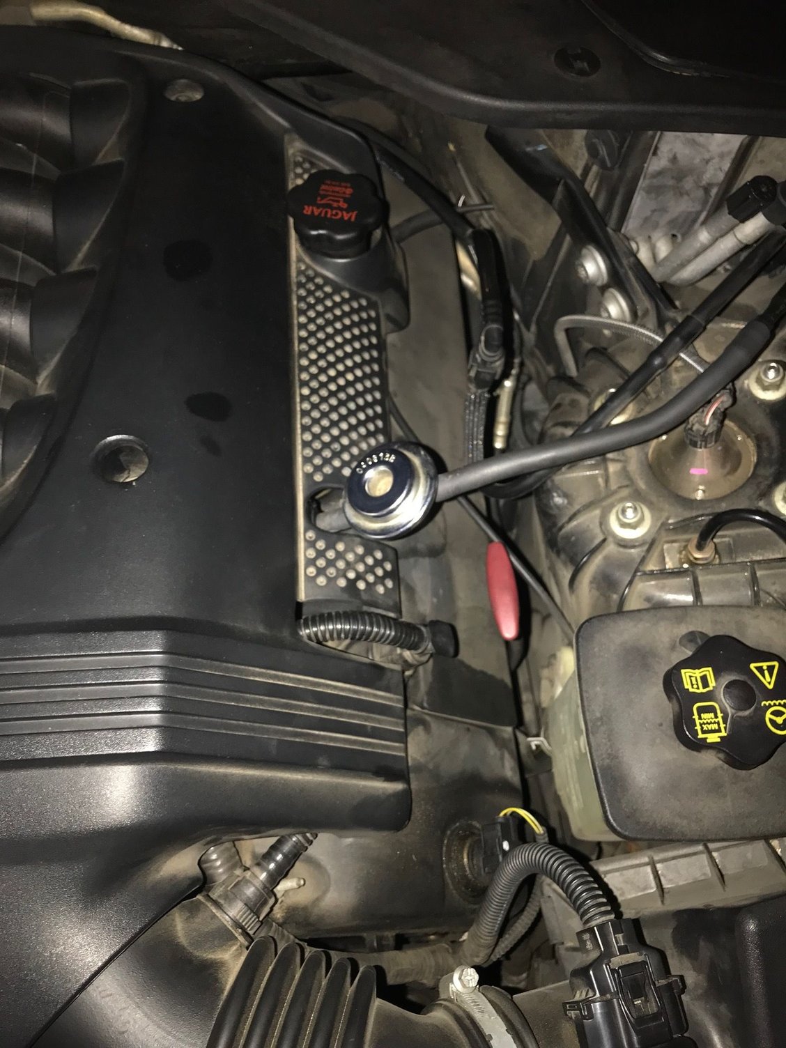

Has been some time since posting on this forum and I am looking for help in identifying a part on my 2007 XJ8L. Does anyone know what the silver disk part is. I have been unable to find it on any fuel system diagrams.
Have replaced the Fuel Sensor but have noticed a very small drip of gas occasionally coming from here as well.

Unfortunately the part in the link is incorrect. Part number AJ83838 is the damper that goes on the fuel rail and not the part that is shown in the photo. Dealer here in my area claims it is a regulator of sorts but is discontinued from Jaguar and he does not know anything more about it.
If anyone else has any information, please let me know.

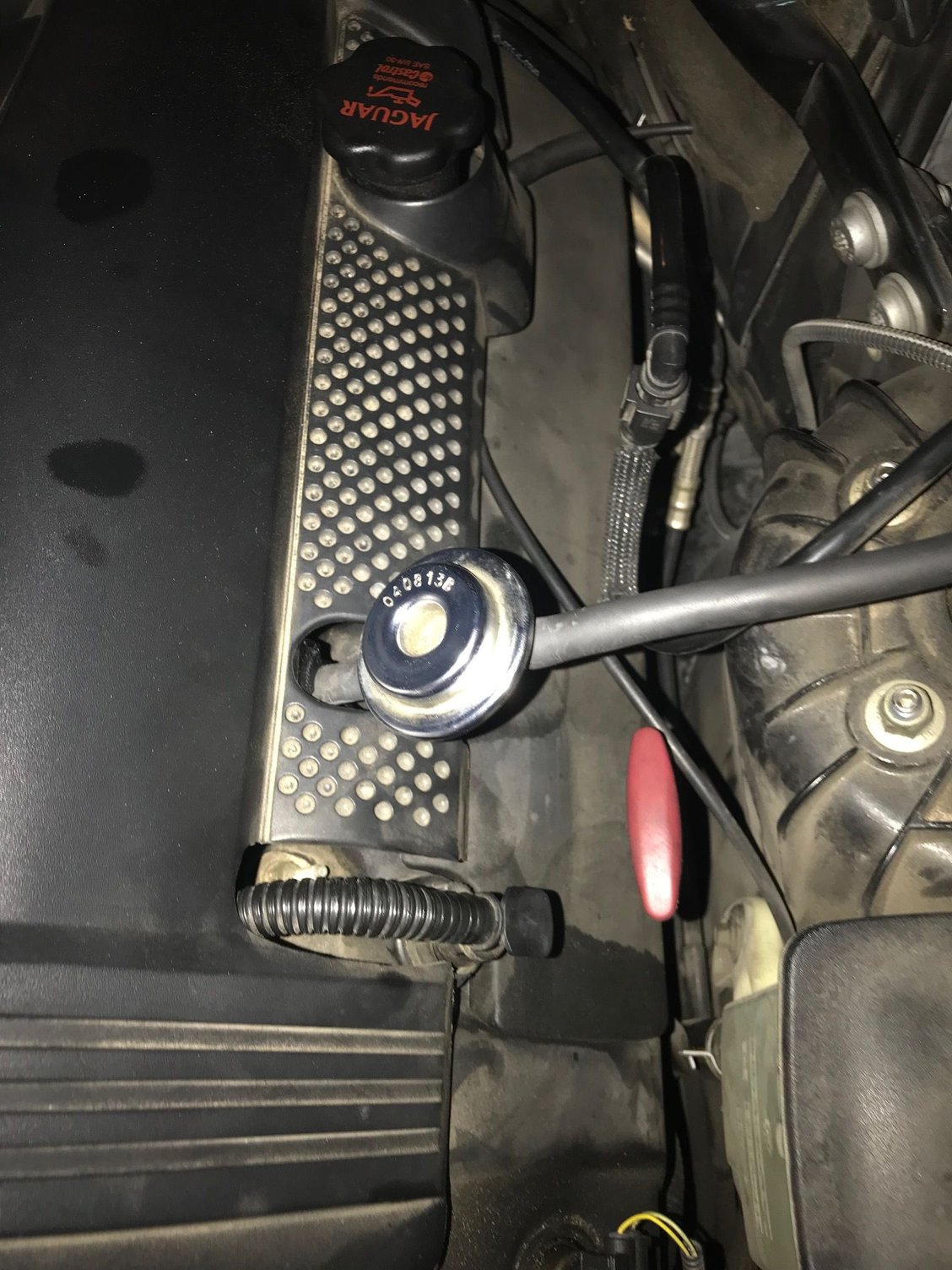

Could you remove the plasstic cover? Then you will see precisely where the rubber hose goes,and I believe that it will be the fuel rail. Jaguar calls it a damper, but it can also be called pressure regulator.
Here'show it looks on my supercharged car, but also the n/a cars have it:

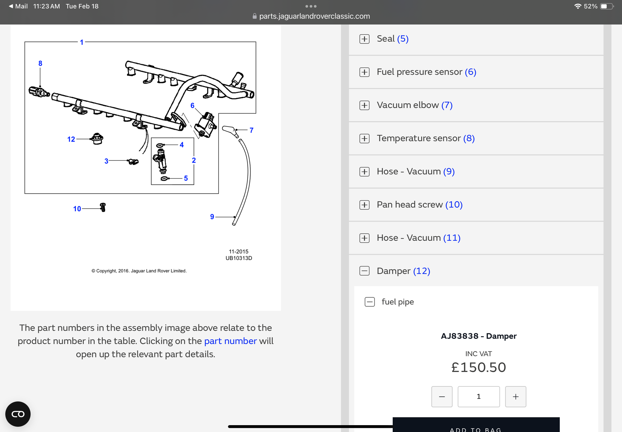

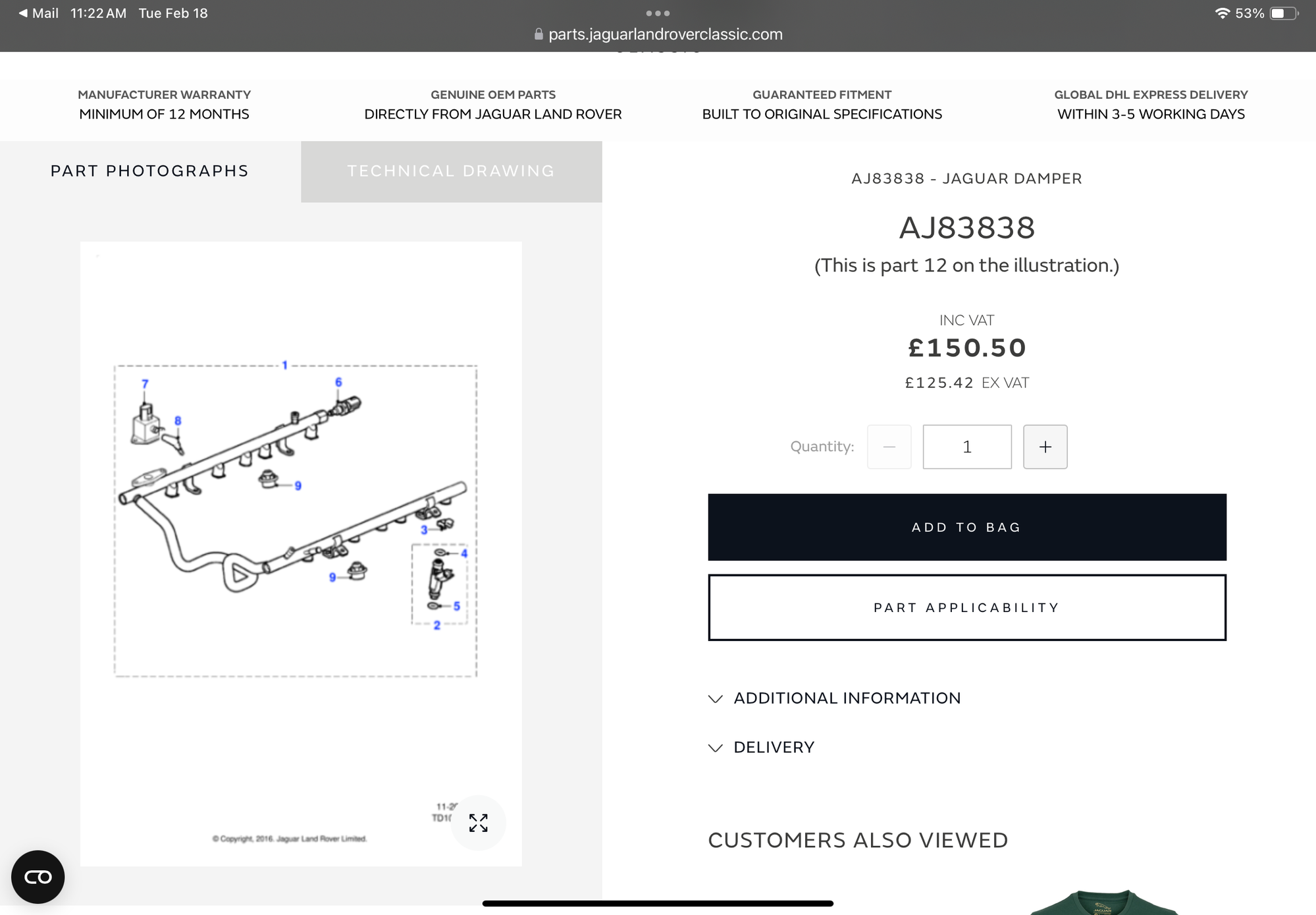

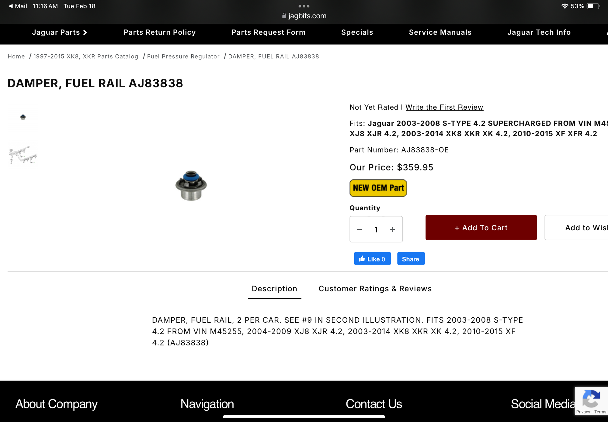

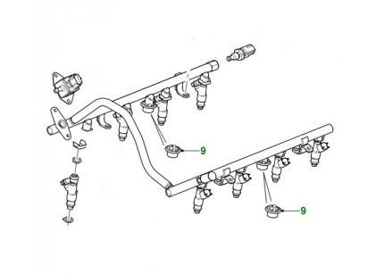

Let me try to explain my confusion. I did remove my engine cover (see Photo) and mine is similar to yours.
The link that you sent me showing the diagram (see Photo) identifies the part #12 as AJ83838.
When you click on that part number it shows where the part goes (see photo) which is the bottom of each rail. There are two of these. This diagram shows them as item #9.
When looking up the part to purchase, the photo is not the part we are trying to identify (see photo and placement diagram from vendor). The part we are seeking is before the fuel rail and has hose connections at the bottom on both sides. I cannot find that one anywhere.

Te part is also present on the supercharged engines, not only the N/A ones. Unfortunately, apart from the number engraved on the top that seems to be a serial number, I could not find any other marking that could give us a clue.
