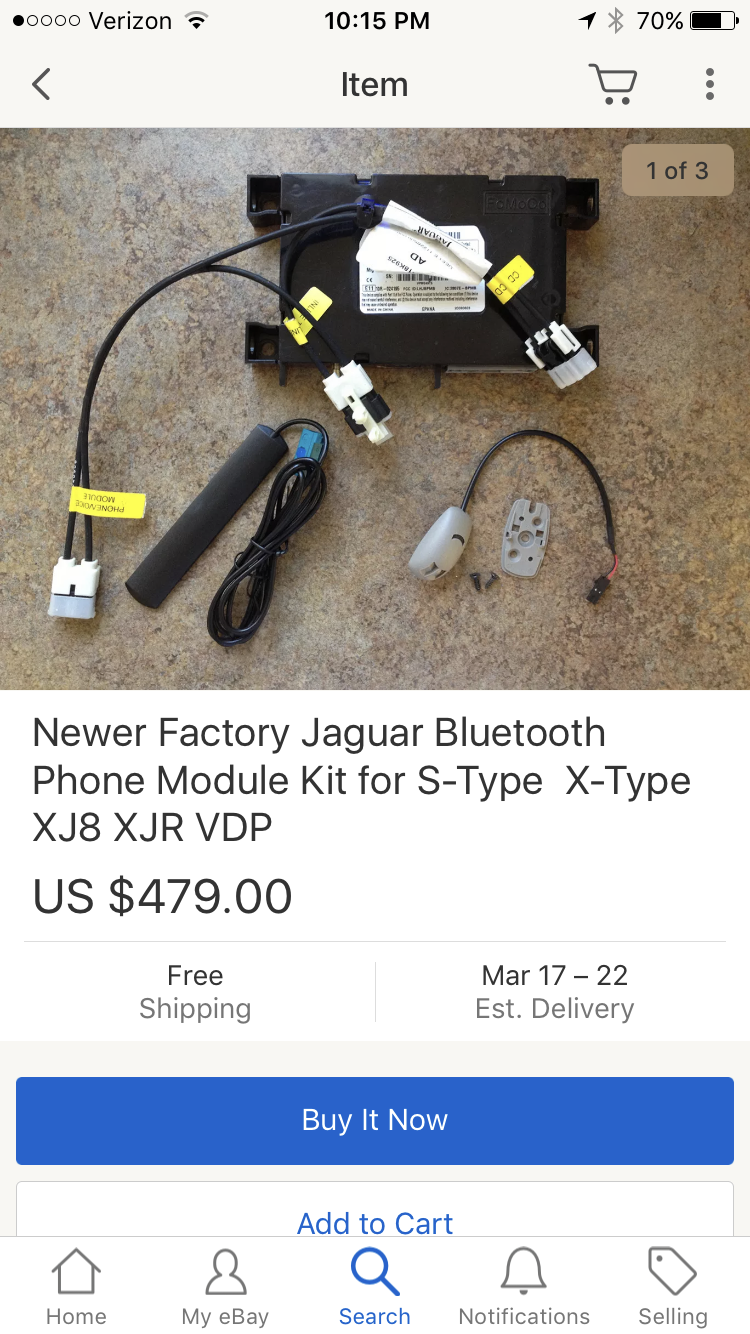

One more thing to add. I found this on ebay.
Is this the system everyone has used to get the Bluetooth function to work on their jags?

veffremov,
sounds good. does the price seem "fair"?
in other words,....if I looked harder into this project, would there be a 50% savings by buying separately? ....that's my threashhold for convenience.

That does look like the correct kit however the price, compared to what I paid, is very high.
BTW the part # I used for the black module was : 7W93-10D893- AB look here http://www.usedautopartsyouneed.com/...93-ab-605.html
This module will support more than one phone.
There is another that will only support one phone.
I also installed a Voice Activation Module (VACM) part# 2R8F-114B292-AD
That worked in my 2005 XJR.

I pieced mine together using the following with approx prices 2 months ago.
Updated BT module (black one, ebay) $175
BMW antenna (ebay) - $10
fiber optic harness (ebay) - $25
microphone - free sourced from a 2002 denali with onstar.
if you do not have the Voice module you need to either connect the correct pins on the harness with some jumpers or buy the jaguar plug in order for the microphone to work.
i added the voice module at the same time for another $225.
So even adding the voice module it was less than that listing. The downside is it might take some time to find and get the parts.
