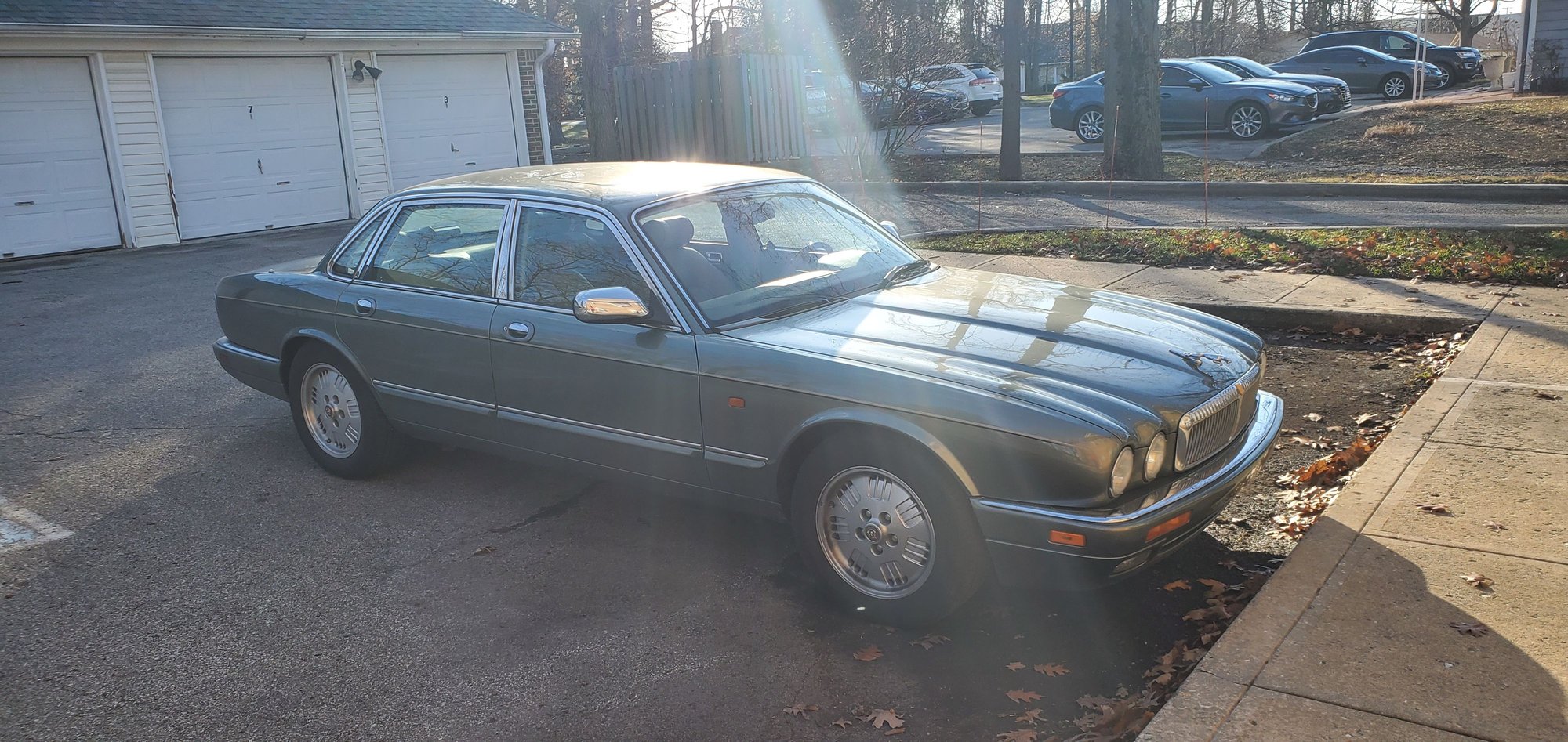

Greetings All!
My 1995 XJ6 VDP, with 55k on the ticker, has no problems whatsoever and still turns heads both on the road and in the parking lots. I drive it daily because. I am the luckiest Jaguar owner.
That is all. That's my post.

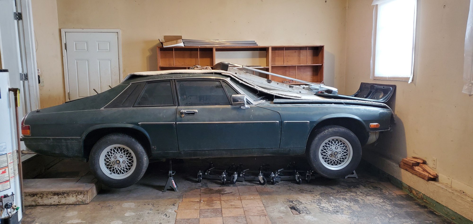

Originally Posted by cinutechs
And I even love the '89 XJS shown below. She's not been started in 12 years, been on jack stands for 4 years, but still doesn't leak any fluids and the leather is still soft. In case you're wondering, I took the bumpers off to get her into that position. It was not the result of a spectacular drifting.
We are ready for a spectacular build thread, followed by spectacular drifting.
