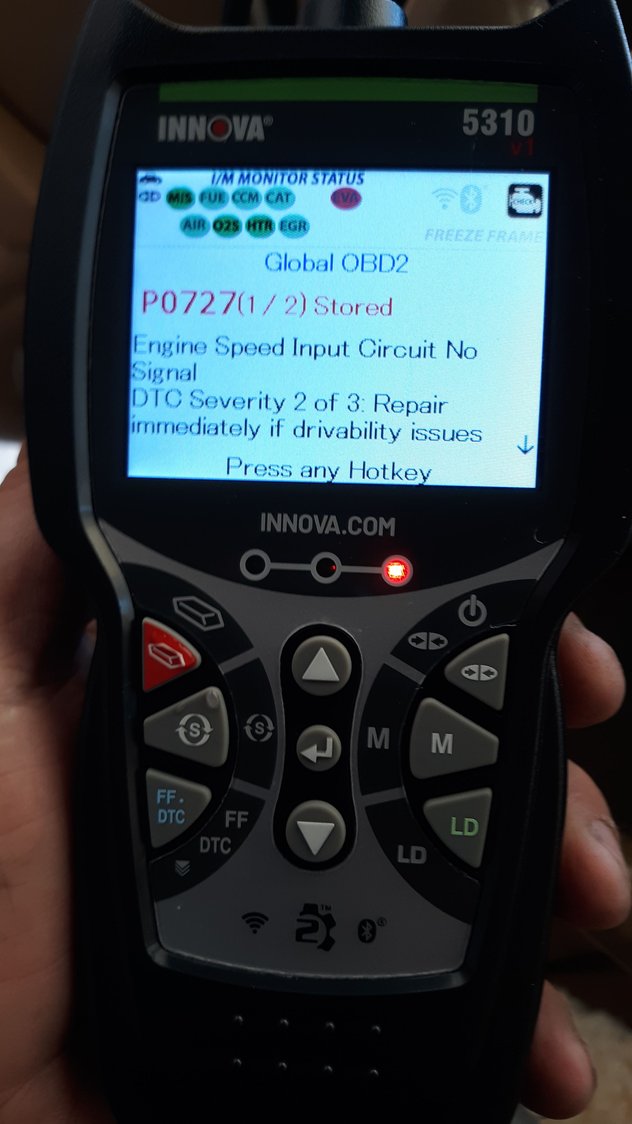

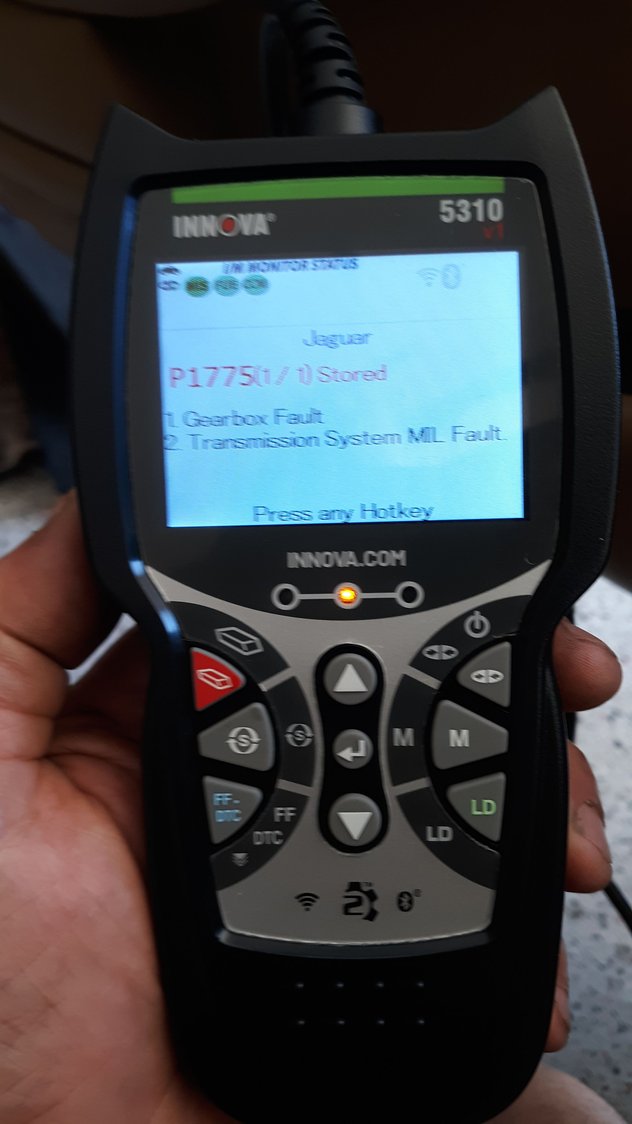

Hi guys
I got a scanner and this is what I got.
I reset the codes and they come back almost as soon as I start to drive. The car jerks and tugs as if the ignition is being turned off and on.
BTW thanks for all the tips.@Parker 7 on the transmission body connector am I looking for bad connection, corrosion? Or does it need to be secured with tie-wraps !

I could not find p0727 in that document.
I did find p1775 and it says "Possible transmission fault – check for flagged TCM DTCs"

sOMETIMES YOU HAVE TO SEARCH THE NET FOR A COMMON USAGE FOR A P0727

See tsb 08.1 - 01 AND ON
JagRepair.com - Jaguar Repair Information Resource
Old Sep 4, 2022 | 01:46 PM
Parker 7's Avatar
Joined: Aug 2021
Posts: 4,650
Likes: 1,317
From: Kansas City
See page 35 and 64
your p0727 IS ON PAGE 64
200 TITLE (jagrepair.com)
The E9 HAS TO DO WITH THE BMW model range as they are the same transmission ( bmw 700 SERIES )
Old Sep 4, 2022 | 02:06 PM
Parker 7's Avatar
Joined: Aug 2021
Posts: 4,650
Likes: 1,317
From: Kansas City
Transmission output speed sensor is on page 63 so your P0727 would be engine crankshaft sensor
tHE MASTER cel FOR THE ckps P0335 DOES NOT ALWAYS SHOW in this early ECU
sEE ALSO cel TABLE page 72
So this points away from the transmission connector on the transmission body

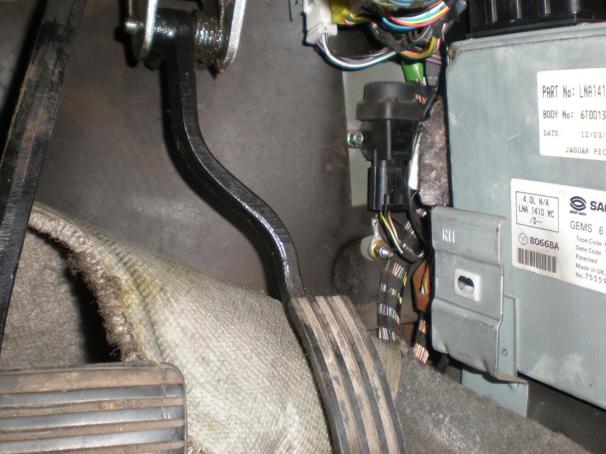

sOMEONE FOUND THE TRANSMISSION ribbon connector on the transmission ECU not fully connected
it is under the glove box as a elongated Bosch or TRW unit
This is a pic of a right hand drive with the engine ECU always on the right side wall for both LHD and RHDl
The transmission ECU is above the pedals in this right hand drive pic but yours is a left hand drive and is not on the steering column side in both LHD and RHD

p0727 = engine stalled
mirrored in tcm, when car restarts it’s in limp home mode
