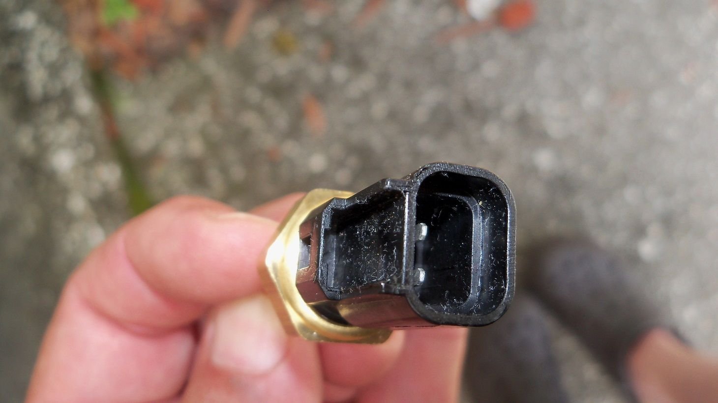

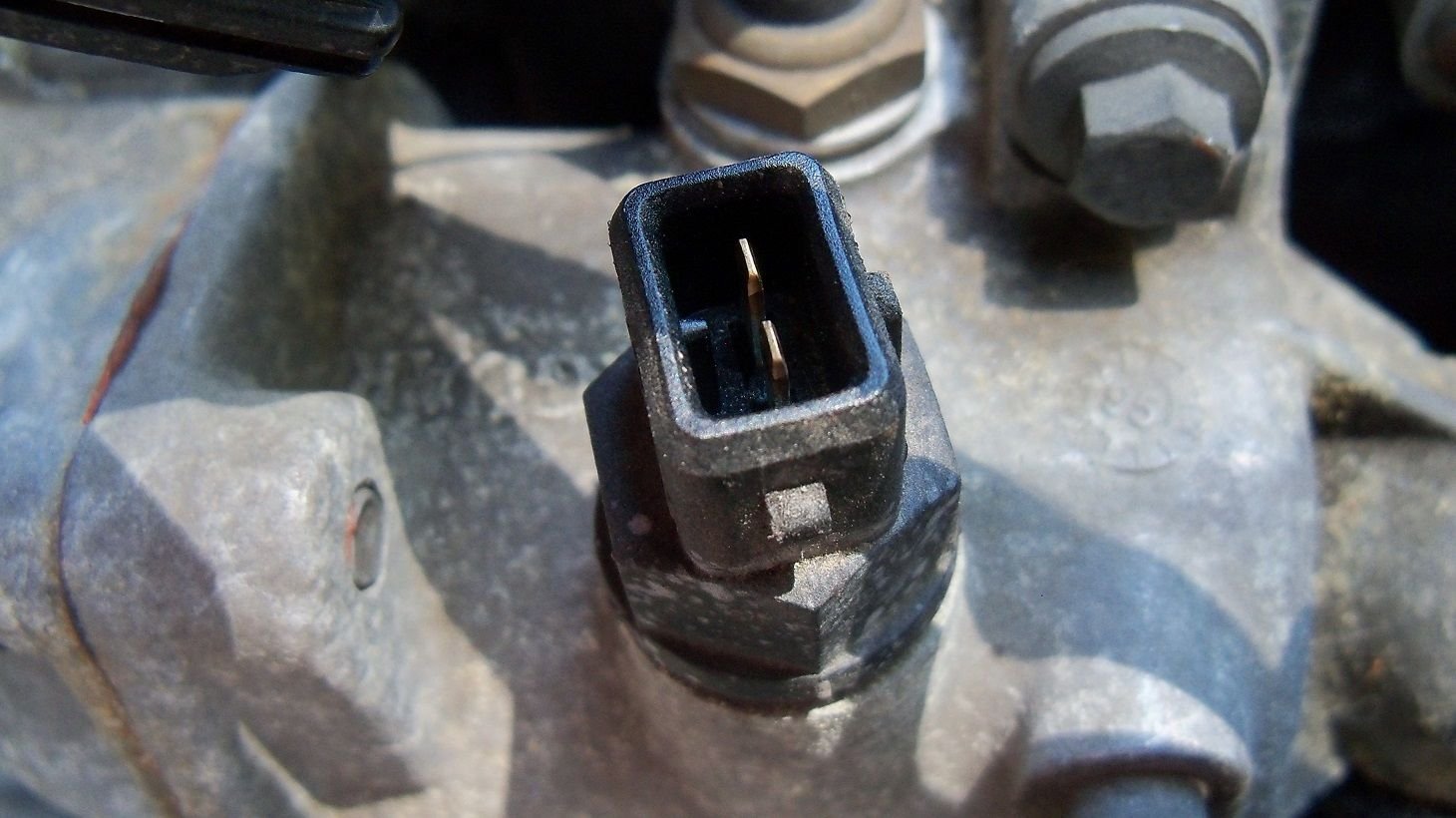

Today I received the new coolant sensor. Unfortunately the connector is wrong. The original uses the same metal clip that the injectors use. The replacement I received uses a different mechanism to hold the connector in place. They will not fit together. So I checked with some local parts stores (O'Riley's, Advanced, Etc...) and two of them had the part for a 96 XJ6, also sporting the same wrong connector. I'm wondering if I maybe look for a sensor from a different year might bring up the proper connector? Or I can make a pigtail with small spade connectors? Ideas? Pics Below.
Bobby
NOTE: Searching through the various parts stores, starting in 1995 they list this new part. If I look at 1994, they show the sensor with the proper connector. I wouldn't think a couple years would make a difference(?), Would it be OK to use a sensor for a 1994 XJ6? Or should I look at replacing the connector so that it fits the new style (because any time it needs to be replaced in the future it'll have the current connector)? Opinions?

Apr 10, 2019 | 12:43 PM
Wow, I just recently replaced mine. There’s plenty of options, and I believe many cars used that same part, so it’s quite common. They just goofed.
Replacement parts may have a black, brown or green plastic section (or even metal) but they all look the same, other than color.
They just sent you the wrong part. LHE1600AA, right?

Apr 10, 2019 | 03:03 PM
Quote: Wow, I just recently replaced mine. There’s plenty of options, and I believe many cars used that same part, so it’s quite common. They just goofed.
Hi Vee. Admittedly I did not go by the jag part#. I just ordered it by the year, make, model. Apparently they all have it wrong for the 96. I'm just back from O'Riley's Auto Parts where I asked them to bring up the part again for a 1996 XJ6, and the picture was of the wrong one (the same that I received). Then they brought up a 1994 and the picture was of the correct part. Since they can have it in by tomorrow morning I had them order one. We'll see what comes in.
Thanks,
Bobby
Reply 0
Apr 10, 2019 | 09:04 PM
Quote: Hi Vee. Admittedly I did not go by the jag part#.
Trust me on this one, going forward, always use the part number. What each car part store has in their databanks cannot be relied on. I find tons of errors when trying to purchase parts. You will be more knowledgable than the guys computer....most every time.
