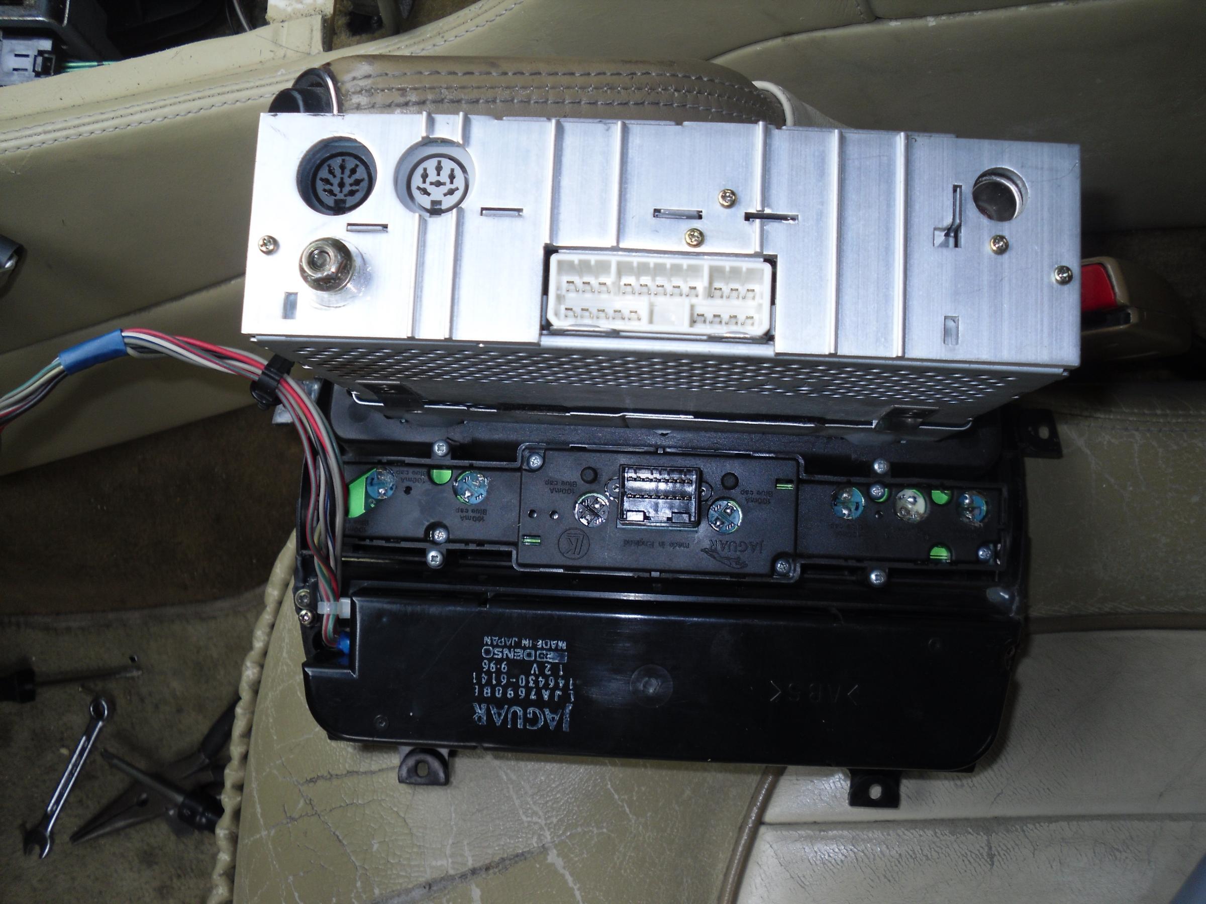

Default J gate and center console Pics
Took some pics of the disassembly of the enter console during my shifter stuck/no start issue. Here are some pics, if they will be of use to future enthusiasts and their projects. Since fixing the trunk light issues and gearshift interlock ignition fuse, the car has been running just about perfect for a week and a half now.
trunk lights staying on ran ran down the battery, security system had to be rebooted, gearshift interlock ignition fuse replaced, battery fully recharged, and all is well.
so if anyone wants to know what is under the console, here are some pics:

Glad you got your starting problem sorted out! Thanks for the console pics.
