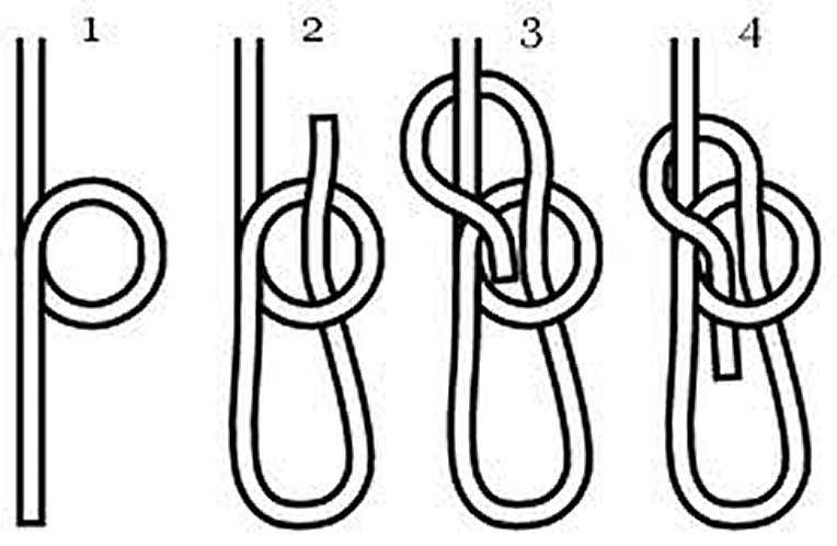

I'm in the possess of getting the cracked Y - pipe welded back up so I had to cut off the pipe with a cutoff disk ( use a 4" by 3/32" , thinner are dangerous ) and safety googles from Harbor Freight and a regular hand drill . The original clamp installation was froze on . Careful not to pull the wiring of the O2 sensors so remove them first . To get it back on the dimension of the gap between the 2 fwd pipes had to flex so I cut the webbing between the 2 . To walk the 2 fwd pipes on was a pain and I remembered bad names I had thought I had forgotten . In using a piece of long 1" by 1" 90 degree angle bar with a hole drilled in it for the aftmost exhaust cover bolt I had a lever to deal with it as I walked it on . The other part was a bowline knot ( sound of Navy bosun whistle ) to change the rope from the fwn to aft pipe as I walked it up into position . Carefull not to damage the pipe flairs and doughnut seals for this damage will cause leak problems effecting your fuel trim or mixture . Put some heavy grease on the nuts so you can snug them up tight . As the Cats are off you can clean them in one of those 5 gallon buckets , they fit . Ask questions for help .
