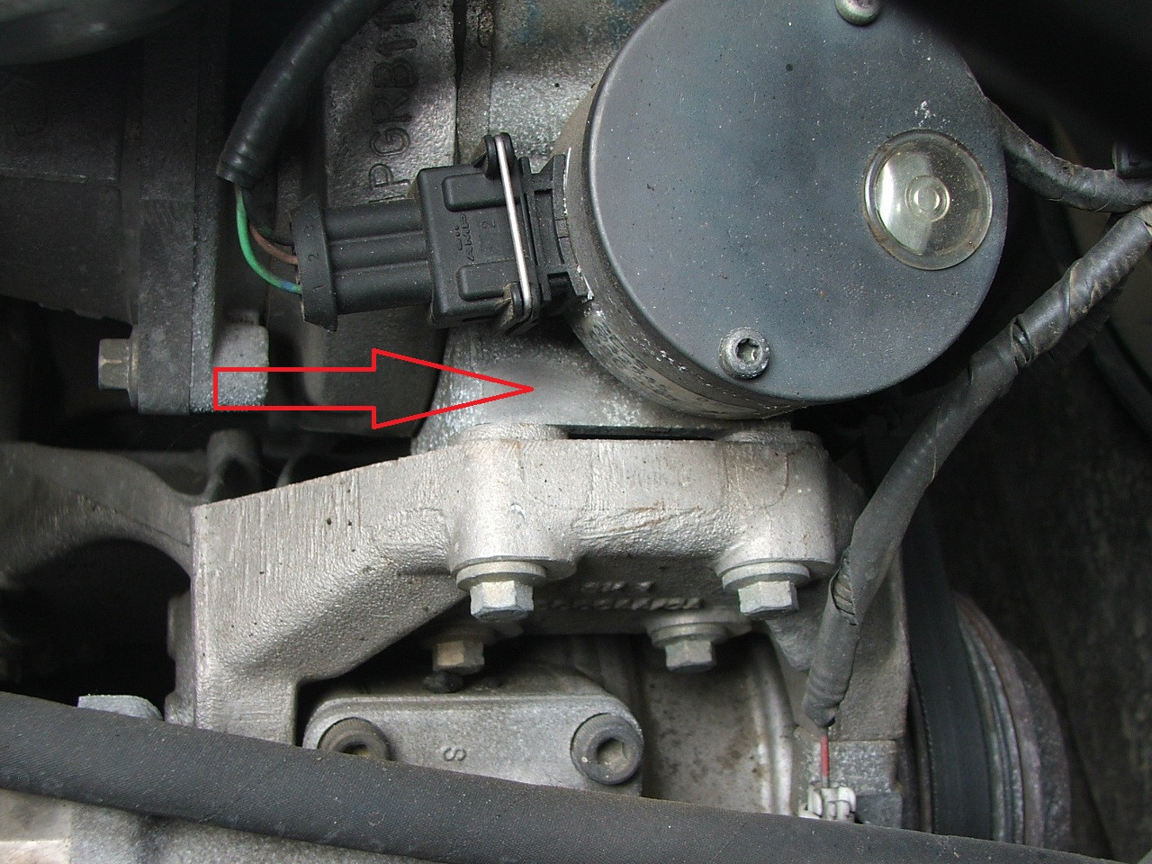

Since you did get it to actually kick over & run, albeit poorly, I'm inclined to think a timing issue. Mark the position of the cam position sensor (looks like a distributor with no spark plug wires and has a small window with a bubble in it). Loosen the bolt and rotate it 1/8th inch counter-clockwise then attempt to start. If no joy then attempt the same in the clockwise direction.

I tried holding the pedal to the floor with no luck. It does seem like ignition or timing to me as well, I had very high hopes as I was driving back from the parts store with my new crank position sensor, since it was acting just like the last time it failed. Also, when i tried starting fluid with no luck I was leaning toward ignition, since just about anything in the neighborhood of ready to run will at least jump with some ether. I'm off from work again Tuesday and will check out the cam position sensor. I'll also take a look at Snap On's Shopkey to see if there is anything about timing the crank to the cam, etc.

Checked cam position sensor and it is spot on with the crank, also tried moving both directions with no luck.

On the X300 the ECM refers to the Camshaft Position Sensor (CMPS) at startup to establish initial engine timing. Once the engine starts, the ECM refers only to the Crankshaft Position Sensor (CPS or CKPS). Suede has already suggested adjusting it but that hasn't solved your problem. It seems possible that the sensor has failed. Perhaps someone on this forum knows how to test it.

To be more clear, it seems possible that the Camshaft Position Sensor has failed, and possibly someone on this forum knows how to test it.
