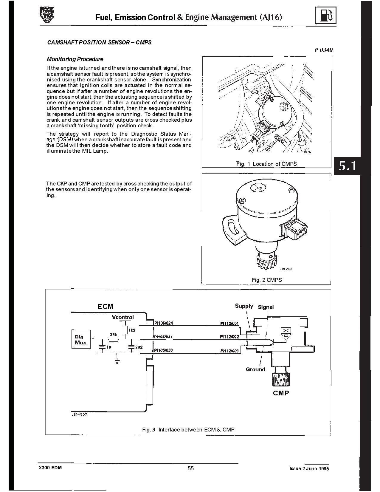

Don:'
I understand your skepticism which is exactly why I started that like I did! (Which are you, a lawyer or an engineer? )
And, I agree that the text you quoted is not explicit, (good eye!) and it worried me for a minute why I had not made the interpretation of it that you have. But, read the image below, from the shop service manual (NOT JTIS or the technical update) and I think you will agree it is explicit. And.. while we are on semantics, please note the use of "CMP" as well as "CMPS" in the manual text.
As to having actually cranked one without the CMPS, (the cam position sensor in X-300 glossary), I think I have, but I cannot say for sure, but I know it has been reported to be the source of slow to start conditions. I WILL pull mine off just to be sure, but I have no reason to doubt the manual.
TXT:
CAMSHAFT POSITION SENSOR - CMPS
Monitoring Procedure
If the engine is turned and there is no camshaft signal, then
a camshaft sensor fault is present, so the system is synchronised
using the crankshaft sensor alone. Synchronization
ensures that ignition coils are actuated in the normal sequence
but if after a number of engine revolutions the engine
does not start, then the actuating sequence is shifted by
one engine revolution. If after a number of engine revolutions
the engine does not start, then the sequence shifting
is repeated until the engine is running. To detect faults the
crank and camshaft sensor outputs are cross checked plus
a crankshaft ‘missing tooth’ position check.
The strategy will report to the Diagnostic Status Manager(
DSM) when a crankshaft inaccurate fault is present and
the DSM will then decide whether to store a fault code and
illuminate the MIL Lamp.
The CKP and CMP are tested by cross checking the output of
the sensors and identifying when only one sensor is operating

Originally Posted by Don B
Allan: "Once the engine is started the CMPS no longer has a role to play in engine management." After the engine starts, only the CKPS signal is referenced by the ECM for ignition timing. (this statement is definitely confirmed by the manual)
Hi Don,
As usual I am in agreement with Ross
I agree that words mean things and in my statement I probably should have said 'ignition management' rather than 'engine management'. In this case the function of the CMPS is to identify TDC of the compression stroke of cylinder #1. Once it has given the ECM that info, it has no more to do with ignition management. Ignition timing is then only controlled by the signal from the CKPS to the ECM.
This is the text from the description of the CMPS which explicitly states that it is not required once the engine has started.
File Type: pdf
