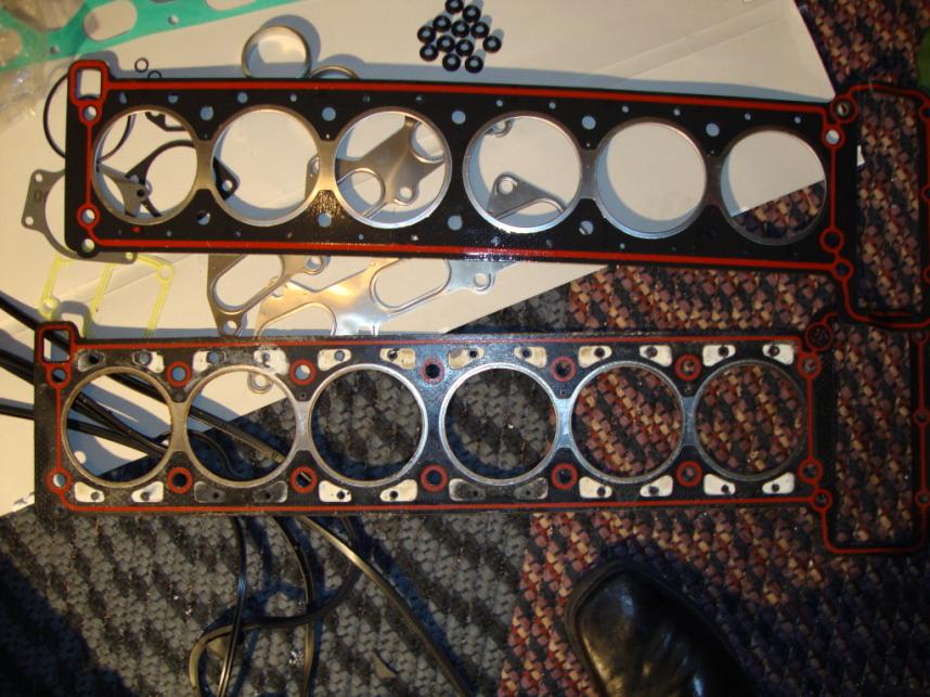

first epic fail of 2010! the head gasket is busted up before its even in the car!
I ordered the set from Coventry West in atlanta, and the head gasket, when i opened up the packaging, had a break in it on the front timing chamber section.
failboat is now docking!

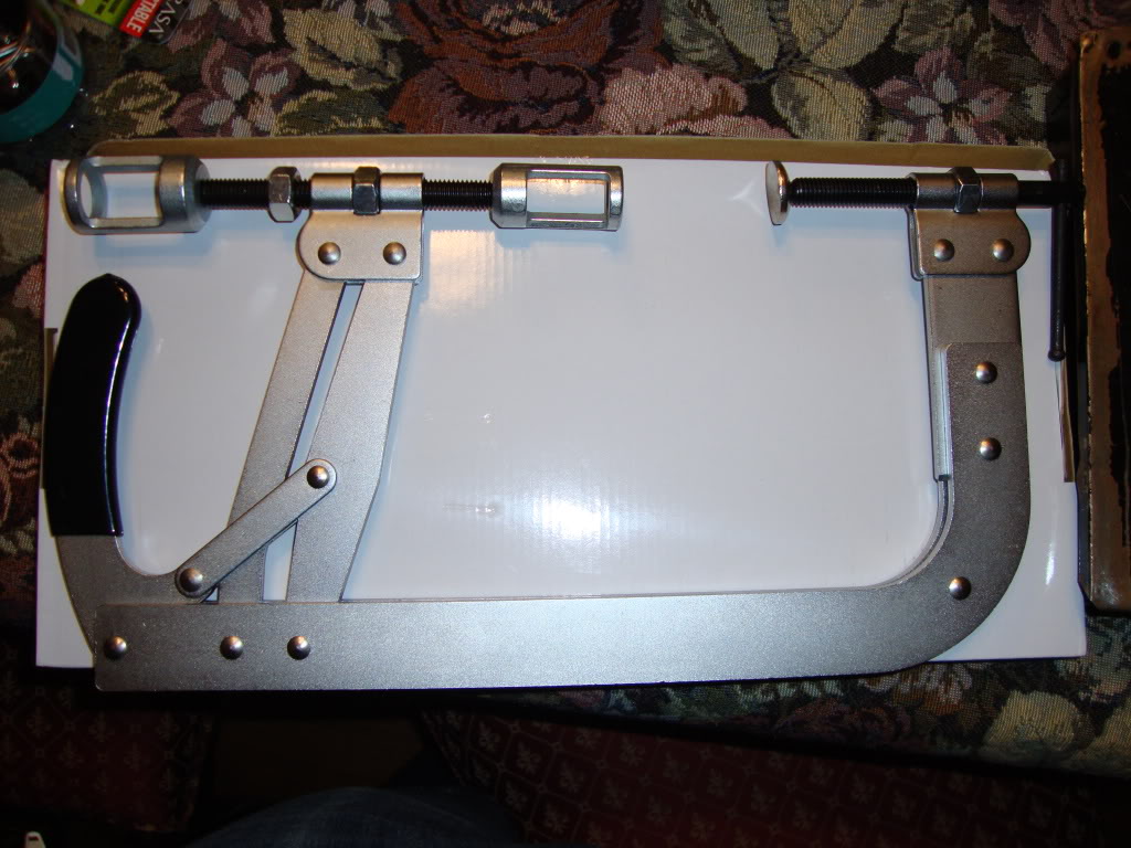

and my valve spring compressor is such garbage. good thing I am adept with an angle grinder and blow torch and hammer.

Well you can of course flatten it out and apply hylaseal to that area to make sure it seals.

Oh I know the folks at coventry are fantastic, I've dealt with Pete Bond many times in the past. It's just that would be my luck.
Pete's got me another set on the way and I've got the damaged one on the way back.

oh here we go. head is fresh. just waiting on the new gasket set. also got a valve spring tool that is mo betta.
