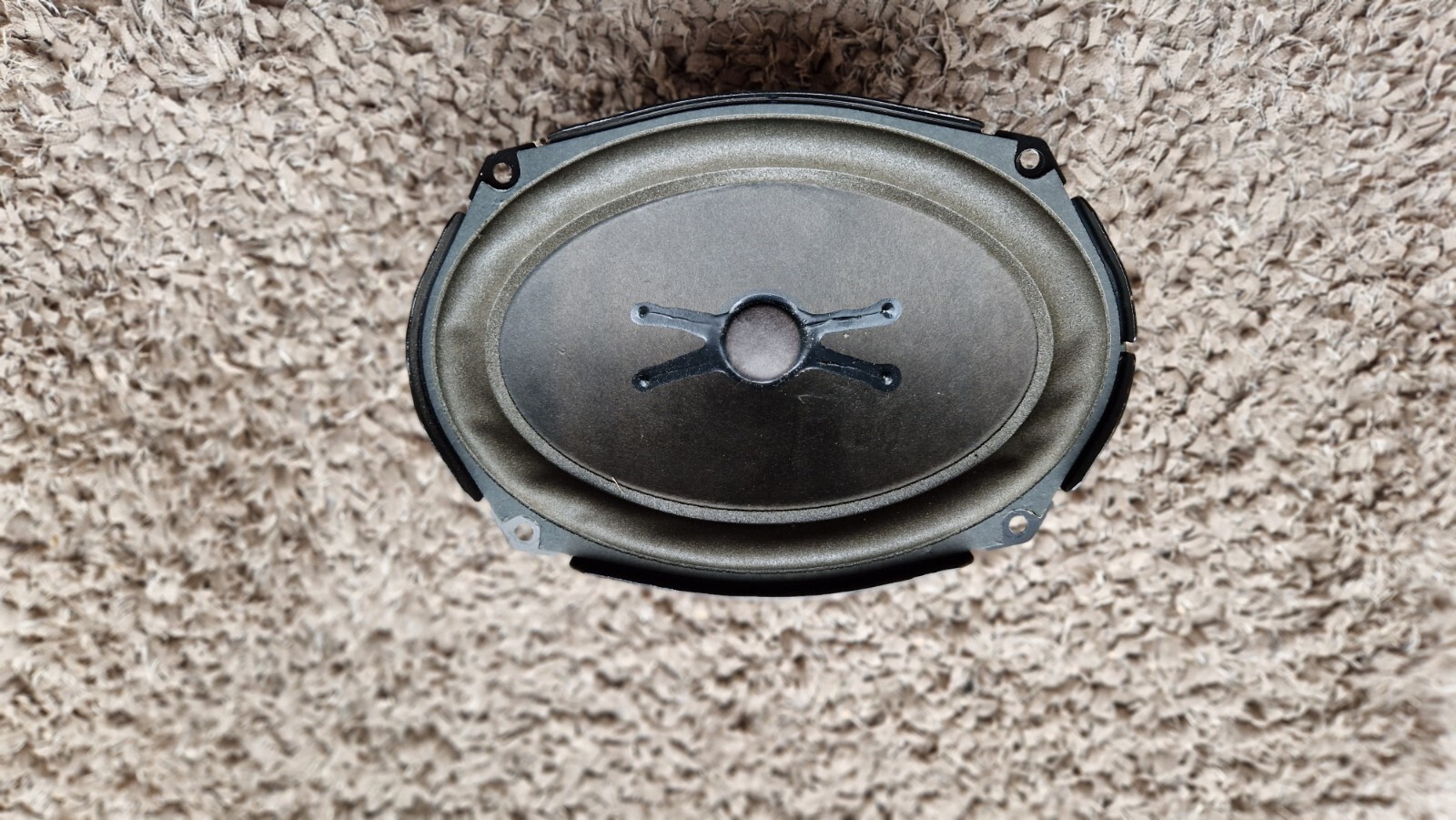

Regarding my audio issues.
I stripped the door cards after work today and all but one speaker was blown.
I ordered 2 x midbass/midrange speakers for the back doors and two coaxiels for the front. The front tweeters don't sound the best so thought the coaxials might add some highs. I got at the rear parcel shelf 6x9, I didn't need to remove the rear seat as a previous owner has just ripped the top of the rear deck cover up (bending a few clips) which allowed me access to the speaker. I had a good look at it and when I had a look on eBay, I found that a Mini Cooper R50/R53 Harmon/Kardon rear speaker looked almost identical. There was one on eBay for £11.50, a cheeky offer of £10 and it was mine.
https://www.ebay.co.uk/itm/354364190088
I'll let you know once it arrives if it works or not. Trying to find a DVC (Dual voice coil) 6x9 in the UK was difficult so hopefully it works.

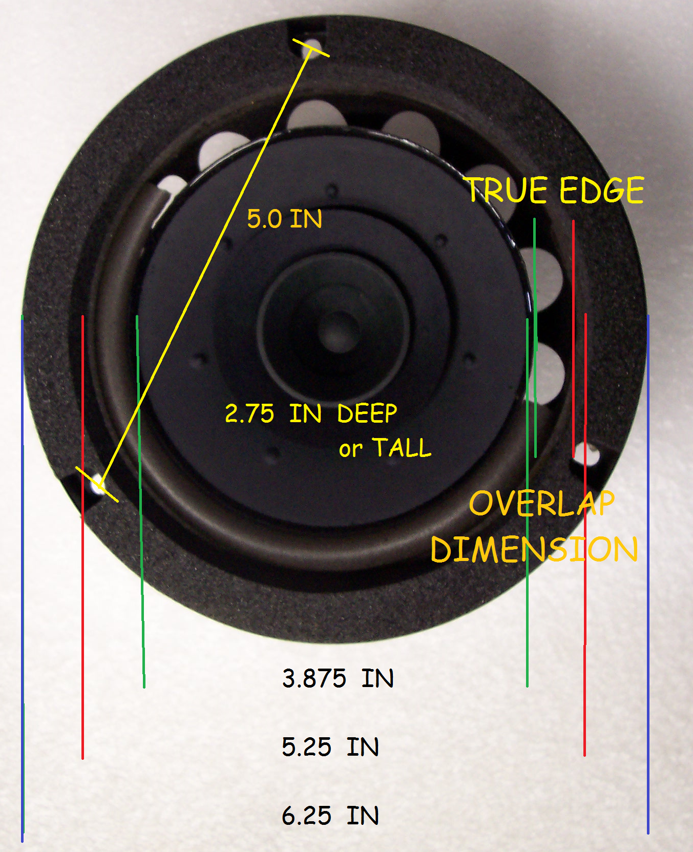

In the department of speakerization the original speakers are 3 number of mounting screws ( checking a spare )
The rear 6 X 9 is shallow height as the vertical fuel tank is there in the way
So this points more to diaphragm foam replacement
