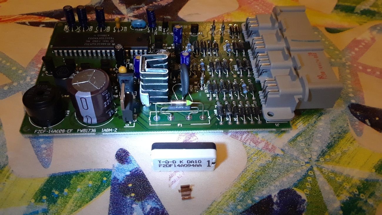

My my you have a big capacitor there at C41

F1: The inner pads should read 15 ohms and outer set should have continuity (0 Ohms). If no continuity, the thermal fuse has blown and the module will need to be replaced. In my case the thermal fuse in the picture was blown.
In theory you could replace the thermal fuse, but I don't know what its thermal value should be. Possibly the color code (green)? Bypassing it could be risky.

All fixed. I replaced the airbag module, and the problem has gone away. The replaced module was just over a year older. I did not do any testing on the old module, but I think that one of the caps was dead and did not hold a charge.
