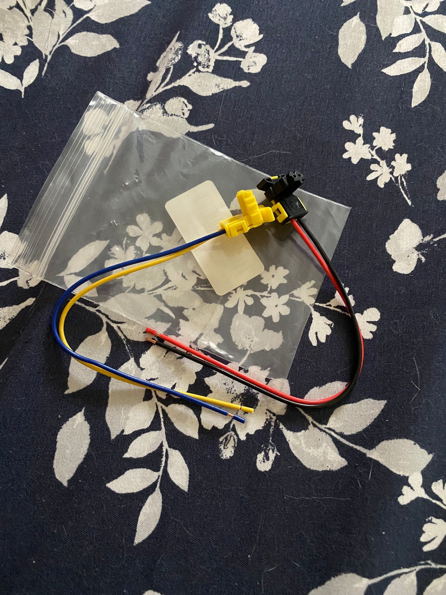

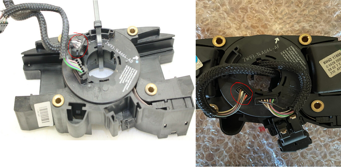

Just received the clockspring in the mailbox, and everything looks good until I saw one of the airbag connector, which was broken off (wasn't pictured clearly on the listing ).
After some digging around, I notice that later revision receives a slight change to the airbag harness connector that connects to the clockspring unit (the early version are bulky/fatter, while the later version are much slimmer).
What should I do? I'm thinking of cutting off that broken connector and solder a new one in, but I'm not sure which wire goes to which...

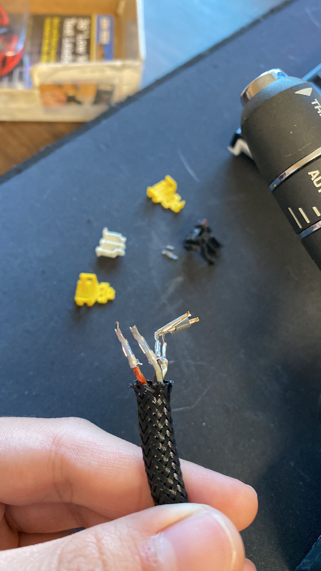

Howdy,
After watching a YouTube tutorial, I've managed to depin the airbag connectors. Unfortunately, the terminal was damaged.
Is it possible to punch the terminal out and replace it with one from another unit? Or should I cut the wire off and solder in a new connector?

After some time of researching the internet, I believe I may have found a proper connector replacement for the clockspring... Hopefully this is the last thing needed to fix the airbag light issue, which happens quite often as time goes on.

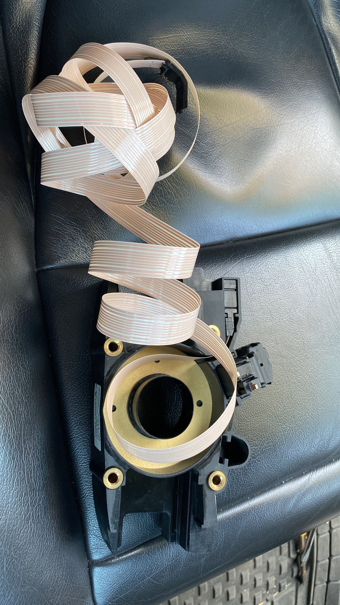

Well, me and my dad spent the entire afternoon installing the new clockspring.
It went on nicely, and the cable connectors we purchased also fits into the airbag module well.
And, of course, when we fired up that lovely V8 engine, we were hoping that the airbag light was gone; however, the code 19 came back up again.
We were thinking that maybe the connector solution didn't work well, so we thought of swapping the clockspring's faceplate with hope that it may fix the problem.
Unfortunately, the designs between those two were different; the old clockspring that we have, the 10-pin connector would go off easily, but for the AF one, the connector is mended in directly to the faceplate, so we couldn't get it off.
Is there a way to separate the ribbon cable by itself? If that is possible, then maybe we could attempt to swap over the faceplate.
Thanks.

Originally Posted by Wingrider
Hoping that i'm wrong;
Believe you may need to get another clock spring
Well, we initially thought so, but after putting the old one back together and reinstall it, by some magic, the airbag light is gone
Took it for a drive today, and everything is working exceptionally well.
(Also a big phew, because all the emission monitor test is still flagged as OK, which saves us having to do a drive cycle again )
