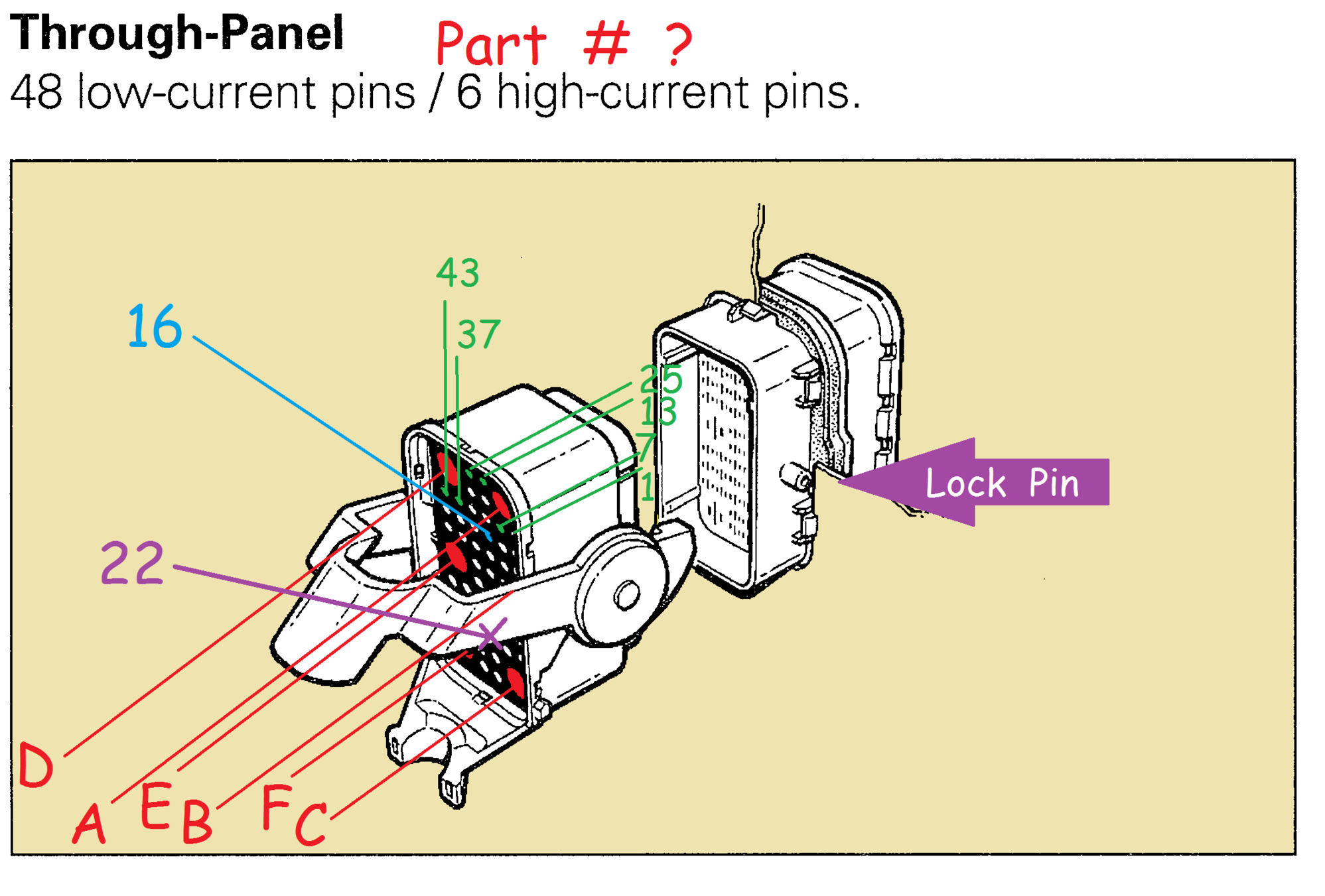

The connector above the fuel tank ( BT4 ) might be migrating off as the locking lever my have come loose . Mine was tywrapped closed for whatever reason to prevent this . It is a very fical connector and you have to be carful not to try to hard and not break the locking pins . I never could see the FOB antenna on the rear glass to the SLCM on the wiring guide so I'm assuming it goes through that connector
