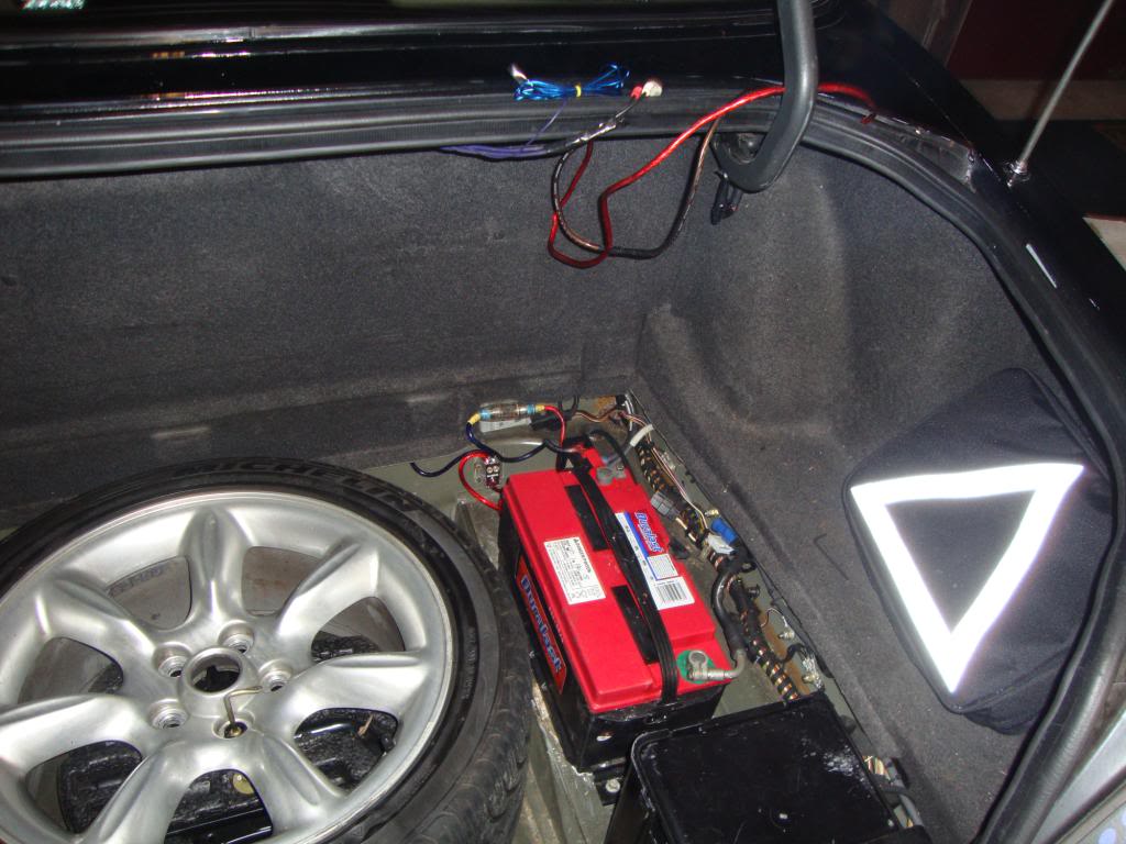

if you go to an autozone store,
49-DL group size,
around 90 or so dollars,
looks like this,
I personally would go for an Optima yellowtop,
I'm waiting for this one to die so I can justify buying one.

Thanks again guys. It was funny I went to the auto section in Wal Mart today...and mentioned that I knew someone that thought they carried the Varta batteries here. Oh boy, did they look at me like I was from another planet Good times at Waly Mart thats for sure. Those batteries on their site looked very impressive too! oh well.
Needless to say, found an awesome Bosch battery at Pep Boys for about $100. Exact size I needed. If anyone else is confused in future about the battery sizes this is what I found out in most places computer systems and battery book lookups:
The 1995 & 96 XJ6/R are listed as a battery that's normally sized (not like pictured above). The 1997 XJ's are listed as a larger battery for some reason...looked at them both being Bosch. Same darn things, different sizes. So I bought the one that is the larger perfect fit for what should be in out trunks.
