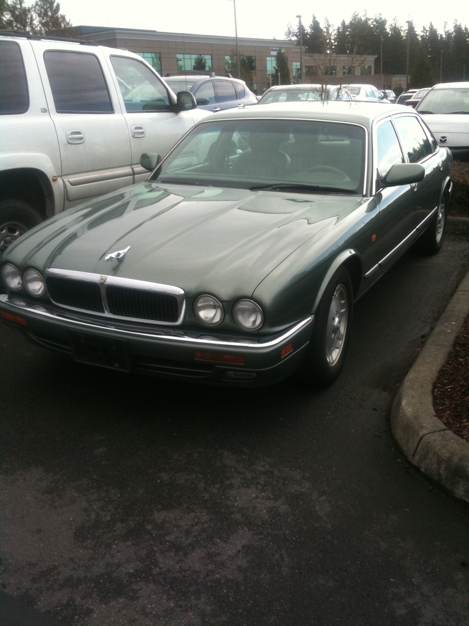

I purchased a 97/ XJ6 4.0 Jag this past Saturday. I must say I love the car already but I have a few questions and problems I'm looking to start working on. Let me first start out by saying I love working on cars, I owned a 2000 Impala for 10 years because I loved that body and how smooth it rode. I did most of the repairs and enjoyed working on her. With my new jag I'm so looking forward to working on it and changing things as they go bad, I know that the better you treat the car the longer she will be around.
So what is the best gas, Plus? Premium? Shell? Chevron? What are your opinions?
I was able to open the trunk on Saturday when I bought the car, but I pressed the valet button in the middle console and now it won't open. Also, the valet switch didn't stay one side or the other, so how do you turn it off? With the key release on the trunk?
there is a sound coming from the front driver's side, doesn't make it all the time but I think it might be in need of new tires. Any idea of what else the sound might be?
Thanks for all of your help and I will defiantly post my solutions to the problems.
