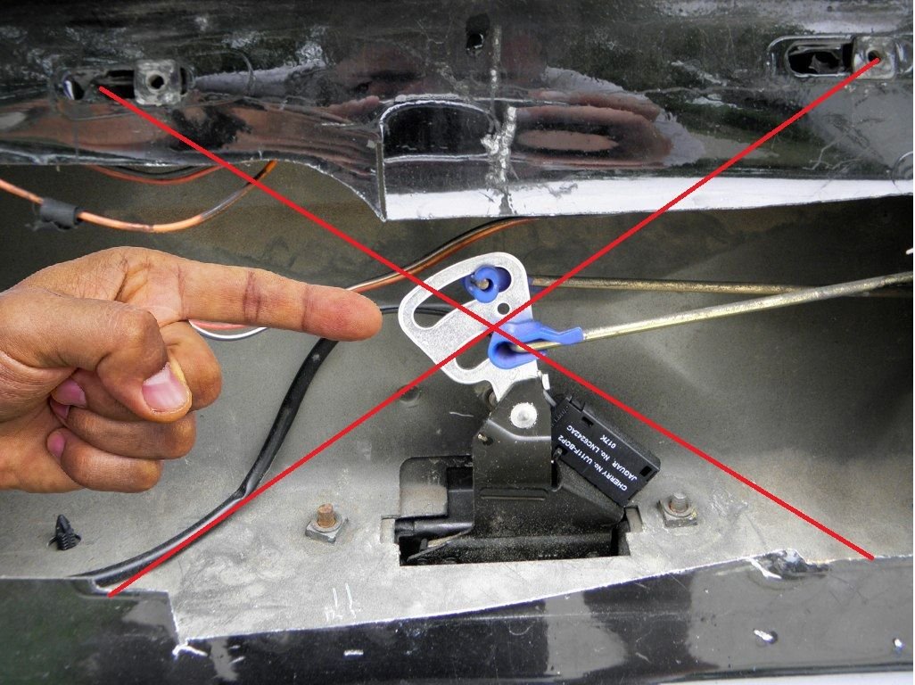

This is a pic of the center latch mechanism , you don't have to get the fire ax out
