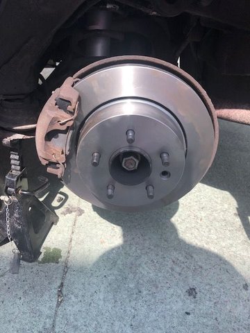

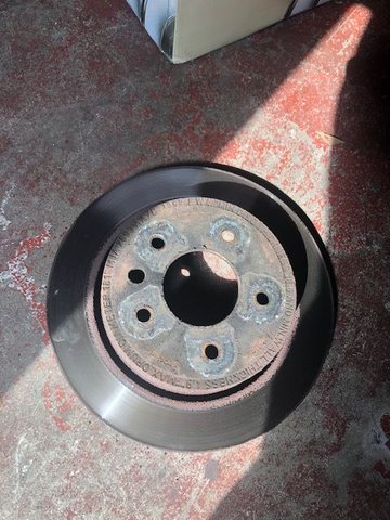

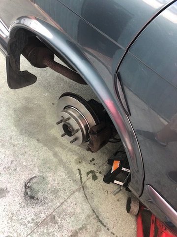

Here's some pics of new rears. Forgot to take photos of fronts. Discs are Delphi. Weirdly my rear end rattle (see separate thread on that) has disappeared!! You can just see my new (1 month old) rear shocks in first pic. Last pic is one of the old rusty discs.
