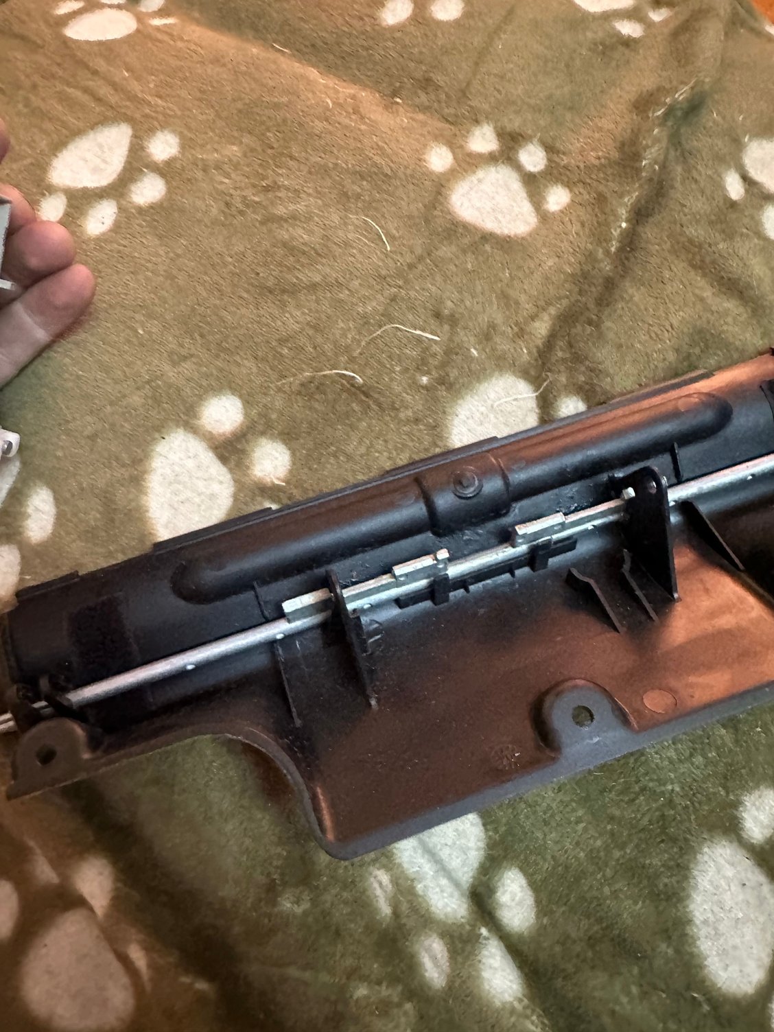

So another issue with me sexy new Jag is the glove box will not close.
it was obviously broken and it looks as tho the previous owner has begun a repair job.
the rods and stuff have been removed and are sitting in my glove box.
i would obviously love to attempt to put it back together but have no idea how it is meant to go back together.
Does anyone have any pictures of their glovebox locking mechanism so i can work out what springs/clips and whatever is needed and how to put it together.

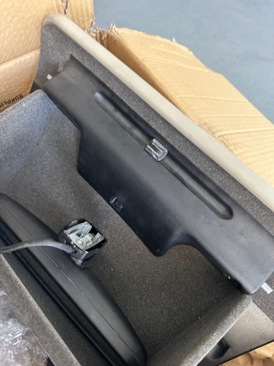

Ok, so i bought a glovebox to replace mine as the locking mechanism was all busted up.
as my car is oatmeal leather i purchased an oatmeal coloured box.
however being a 95 sovereign there is actually 3 tone interior. Seats and part of the door cards are oatmeal, the upper dash and steering wheel are antelope but the lower dash and other parts of the door trim is not oatmeal leather.
it is a different colour.
you can see from my pics what i mean. The glovebox matches the seats and handles and lower door card, but does not match the 3rd colour which is on the lower dash
so what i need to do is swap out the locking mechanism.
so i assume it is as simple as
drill out the black rivets, swap over the mechanism and them screw/rivet it back into place.
Old Mar 7, 2023 | 02:12 AM
Spud Maat's Avatar
Joined: Oct 2021
Posts: 1,389
Likes: 565
From: Sydney

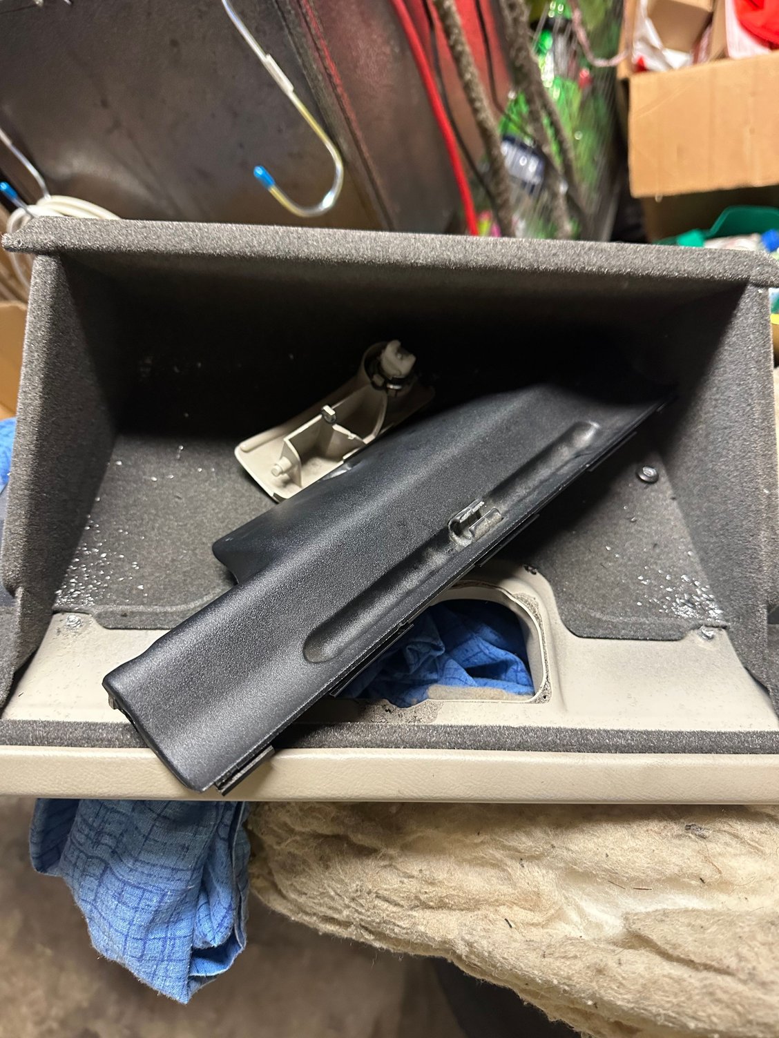

Well once again as often is the case there is no real problem. I got home and realised the glovebox they sent me was a X308 (i assume) as it was larger in its storage area and also had a slightly different shape and larger door.
so,
i drilled out the rivets, popped out the lock assembly,
did the same on mine, removed the handle, removed the locking pin,
removed the handle on mine, put the new locking pins in, put my handle on, put the locking assembly on and screwed it on with 3 x self tappers where the rivets were.
will fit it to car tommorrow when i have time
