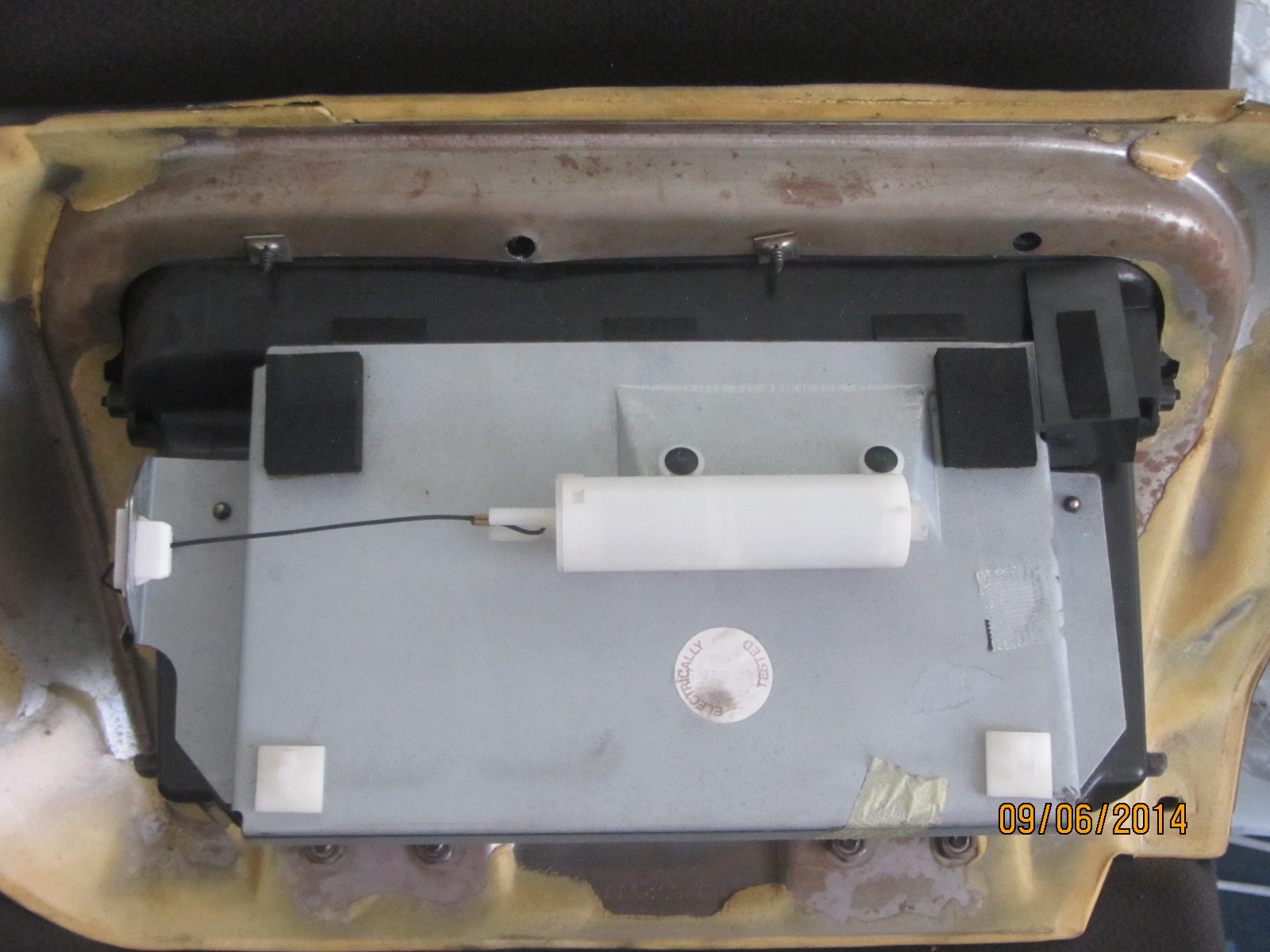

...here comes the mechanism, it's working like a syringe.
Left pic: box is closed, right pic: box is open

Ah hah.... I bet my "wire" had popped off then. As I suspected.
I'll get in there and take a look

BTW, took a closer look at my glove box today, and found that the little button/hook with the cable had simply popped off its mount to the door. I hooked it back on, and working like a charm again.
No idea why it popped out of its mounting hole, so I suspect it will do it again. But I'll take a look at it later. I'll try to remember to get a photo of where it hooks to the door for others' reference if this comes up for someone else.
