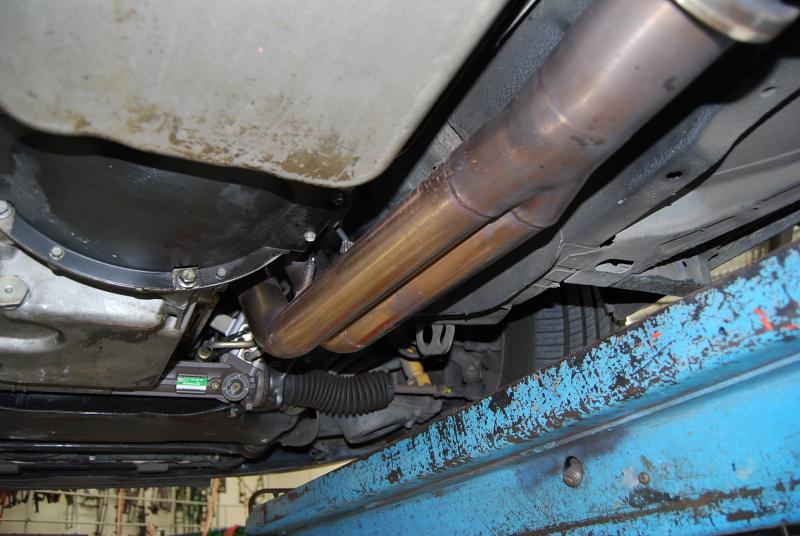

my car is a Australian spec X300 XJR

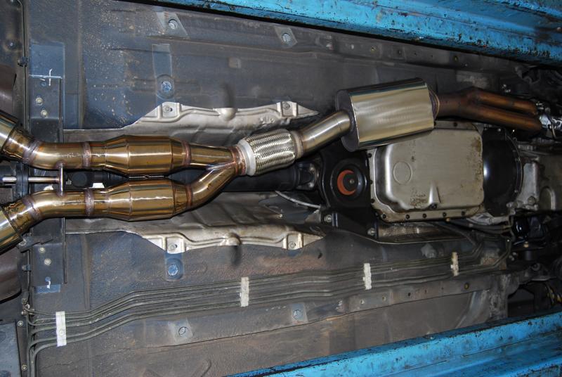

I have custom headers and exhaust system my model has 2 sensors just bellow the front cats when I did the exhaust system I put my new cats under the floor my car doesn't illuminate any dash lights
If I was repairing the original system I would just remove all the cats and put a single large diameter cat under the floor then a single resonator then split it into the twin system most economical way to do the system and if the old cats have dropped some rubbish into the old resonators you have bypassed the problem just use of the shelf magnaflow stuff its readily available
If you keep the front cats just remove the rear ones and add a single resonator splitting into 2 again very easy mods
The reason I did a full system on my car where my cats where 220,000 k,s and 17 old also the car had an over enriching problem which wouldn't have done the cats any good also my header pipes have cracked 3 times just decided to replace the whole lot got sick of the cost of repairs
I also sell the headers for X300 cars made out of 304 stainless steel they have no provision for front cats that way they are true tuned length that's why I put my cats under the floor in my car
If I was doing my car again or another car I wouldn't have used 2 cats under the floor or 2 resonators just one High flow cat and a long single large bore resonator of the shelf like they say you learn as you go along with these cars

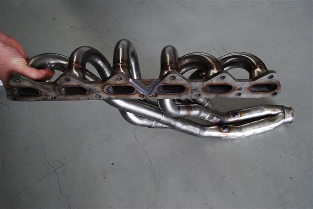

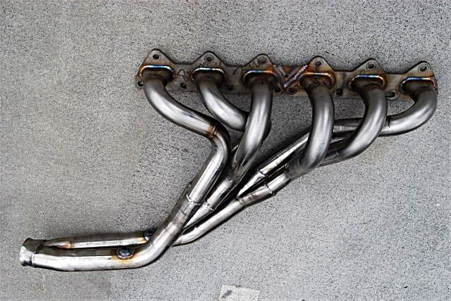

With my headers they have no up stream cats making them true tuned length but have oxygen sensor threaded bungs
The headers are designed to be a direct replacement to your standard pipes which means you could just replace the headers fit the oxygen sensors and be going for just the cost of the headers remember these cars are getting old and the standard headers are prone to cracking
If I was doing a system again and had these headers available I would replace the section under the car where the underfloor cats are and underfloor mufflers as the pipe from the headers is a single pipe which splits in to 2 underfloor cats and mufflers
I would install a single same diameter as the single front pipe magnaflow high flow cat and a single resonator with a single input pipe and duel output pipe that would be the most cost effective way to release the power from the engine
My full system made 18 HP at the wheels but gave better low down torque and slightly better fuel economy
With a open air system and exhaust mod and either a remap or timing advance bracket from (XJR engineer) there should be 25 HP in the whole set-up doesn't sound like much but it does make the car perform better
Then a diff ratio change I.E. from the standard XJR 3,23 to 1 to the N/A cars 3.54.1 makes the car substantially quicker
I can hold my head up high against some of the modern cars instead of getting left behind
If you want more info or details private message me

I also removed my air pump as it is only used to heat up the rear cats my new cats are in the place of the underfloor cats and I used 200 cell metal substrate cats Metal Cat - High Performance Metal Cat 2.5"
these type of cats heat up very quickly no need for the air pump and are street legal

I actually make and sell the headers they are a proven design as you can see in the pic's for my car and below I replaced the full system on my car as the car is 18 years old the original cats would be pretty full by now
