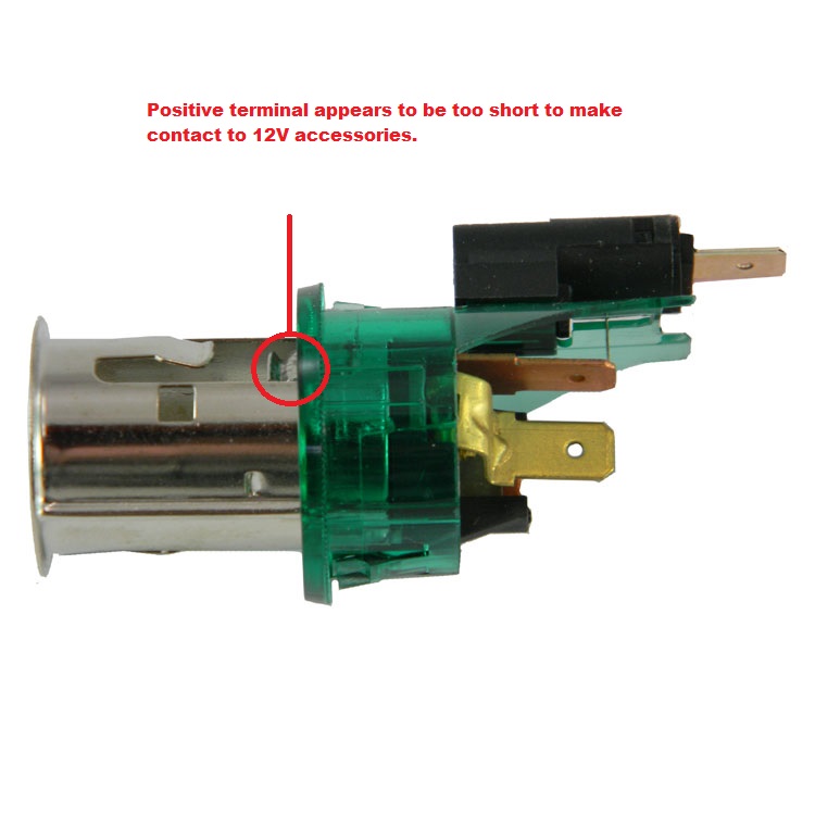

This is exact socket that is in the car, and what i believe is the issue, maybe?
Attached Thumbnails Cigar lighter socket issue-lja2720aa-cigar-lighter-socket-1c.jpg

I would agree with that, although most accessories have a spring loaded end.
Try another socket and see what happens.
It seems strange that both have the same issue though.
