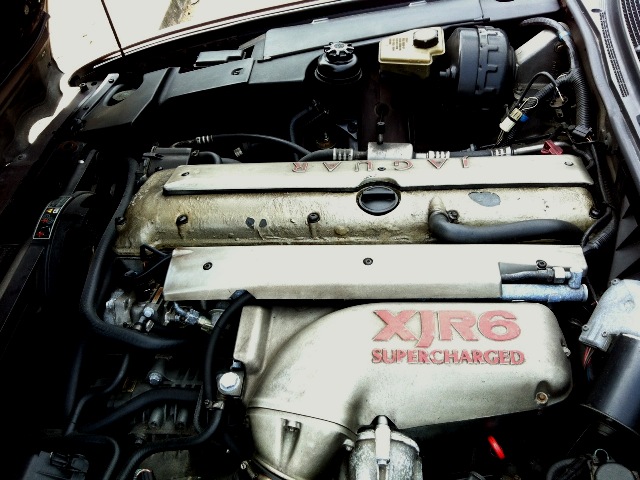

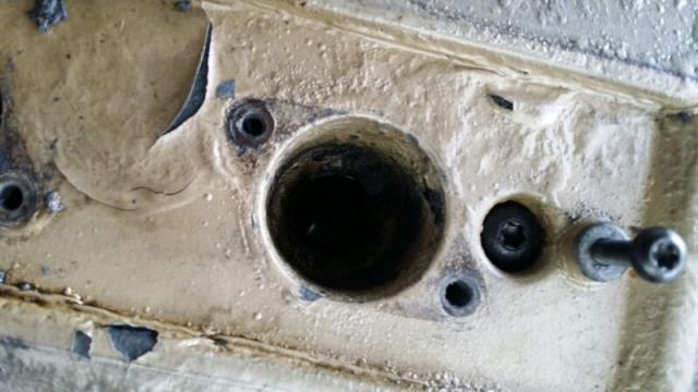

You have a PM. See my valve cover in the pictures below - more than bubbling but badly corroded around the spark plug wells. The heat and humidity in Hong Kong, and a leaking valve cover gasket may have added to the electrolysis or corrosion process.
