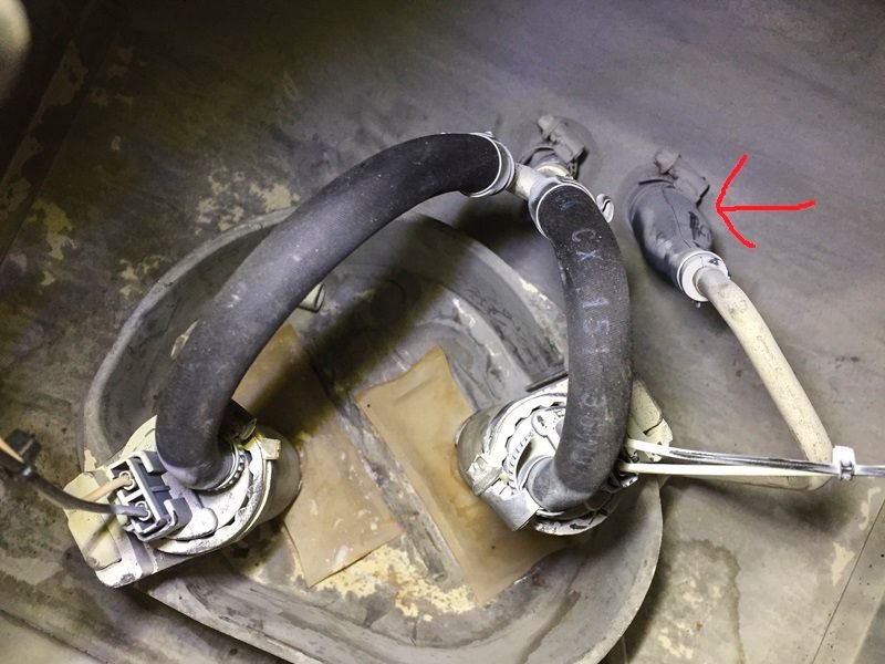

This is inside a twin pump XJR tank, but the single pump tanks are similar. The check valve is at the arrow in red. To access this the tank needs to be removed and the feed and return lines disconnected from underneath and the large plastic access panel on top removed.
