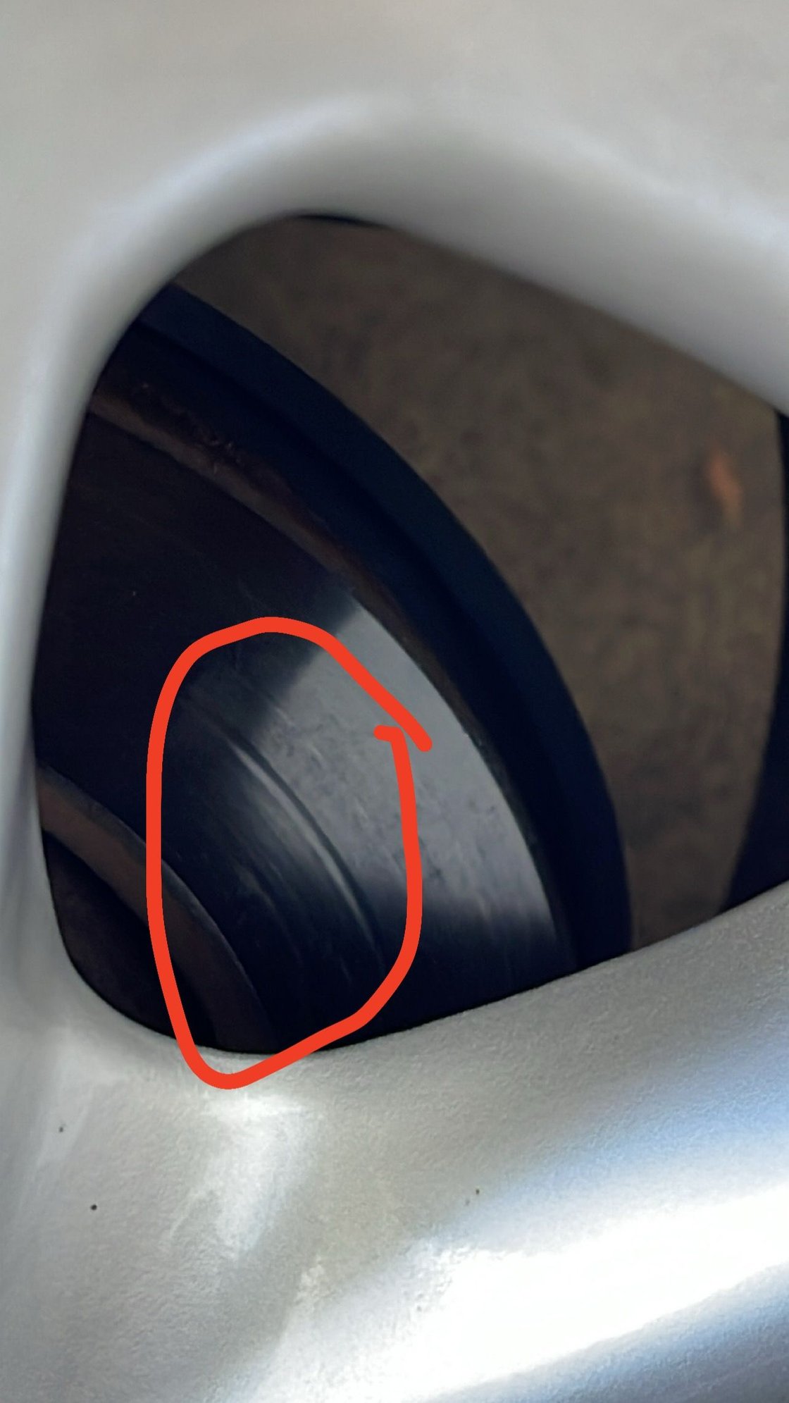

I did some investigation on my front and rears, the front look alright but there is a gouge in the rear left disc. The pad in the rear had a reasonable amount left so might be worth changing as well.
I was hoping it wasn’t a dragging clamp just sounds tedious to deal with…

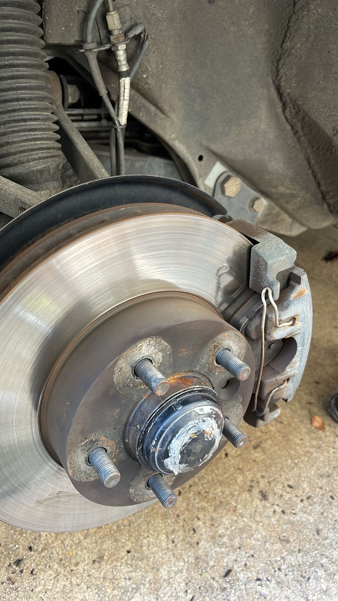

Attached below is the photo of the rear with the gouge, and the front disc with the wheel off
That's the brakes

The gauge probably wouldn't pass inspection if they pic that one to look at

It looks like you have possibly picked up a small stone or bit of metal between the pad and the disc. Try reversing and applying the brake which may dislodge it, failing which pull the pads out for a look. Worst case looks like a set of pads ( NB do both wheels on the axle) as the disc score doesn’t look too severe.

Here’s also the front wheel spinning - would this be normal?
