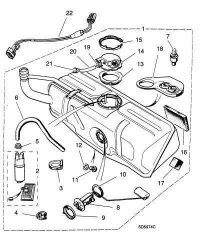

so today i attempted to tackle the fuel pump. i didnt look up anything about it really thought i was dropping tank but its not under the car found it in trunk. then discovered 2 impossible fuel lines above the rear diff that pissed me off so i cut me a hole that shoulda been there in the first place under rear window tray. cheap fuel pump after market so i was meant to reuse the old mounting gaskets but everything but the actual pump disintegrated when i went to pull it out the tank. for now i rednecked it and ziptied it up in the tank to the mounting hook... now that i have a access point ill probably try find gasket set and put it in later. OH, by the way pump was both bad AND had the hose blow off the thing feeling pretty good about tomorrows project of replacing all the **** i took outta trunk trying to pull tank and starting the car ill let you know.
almost forgot i have question too... the fuel gauge reads basically zero gas but the tank was full of fuel when i went fishing for pump and debris so where is the unit that senses that stuff? is it the thing that sits on the side of the tank in the trunk area with 2 pin wire connection? maybe it needs replacing? lmk whats up.

almost forgot i have question too... the fuel gauge reads basically zero gas but the tank was fuel when i went fishing for pump and debris so where is the unit that senses that stuff? is it the thing that sits on the side of the tank in the trunk area with 2 pin wire connection? maybe it needs replacing? lmk whats up.
Hi nickxj6,
Yes, your fuel gauge problem probably has to do with the fuel level sender, which does mount on the side of the tank and is accessed from the trunk (Part 8 in the diagram below). If your fuel gauge was working properly before, it seems possible that while you were replacing the pump, you may have wedged the float and rod down at the bottom of the tank when you secured your pump with zip ties:
Please don't take this the wrong way, but you seem to have been surprised by a lot of details on this job. All of the things you discovered are well known and have been widely reported on this forum, including how to remove the fuel lines on the underside of the tank, and the alternate method of cutting an access flap in the parcel shelf. A little more research on the forum may save you more surprises in the future!
Also, the diagram above is from jaguarclassicparts.com, a great place to view exploded diagrams, or you can download the Jaguar Electronic Parts Catalog (EPC) from this forum. If you don't have the Workshop Manual and Electrical Guide, they're available for download in pdf form.
