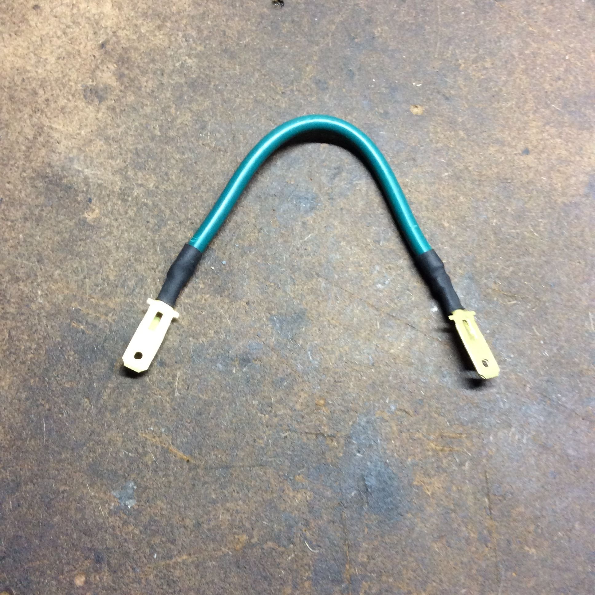

The fuel pump will only come on for 4 seconds only with key rotation and when the crankshaft position sensor sees engine rotation the relay will close for the duration of your drive , You can jumper this relay to directly power the pump at all times , this will drain the battery with the keys in your pocket so plan accordingly
This will be the fwd most socket to the rear most socket , this will be socket 3 to 5 or 30 to 87
Use a blade type connector like this the front counter at a auto parts store can help build up from a tool and parts kit they can dig through
