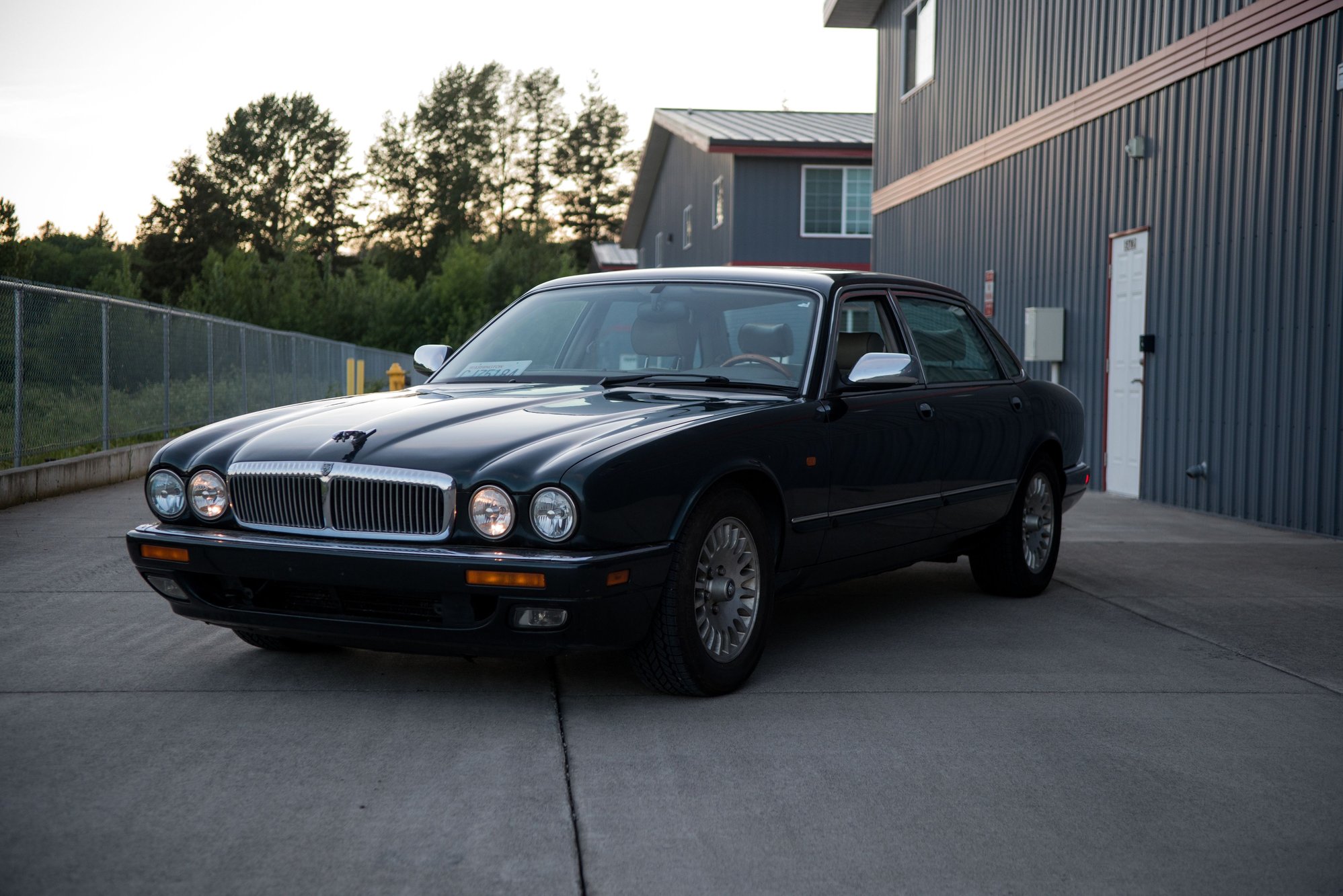

Old Today | 04:09 PM
IdRatherBeDriving's Avatar
Joined: Feb 2023
Posts: 9
It's a good thing this car is such a looker.
