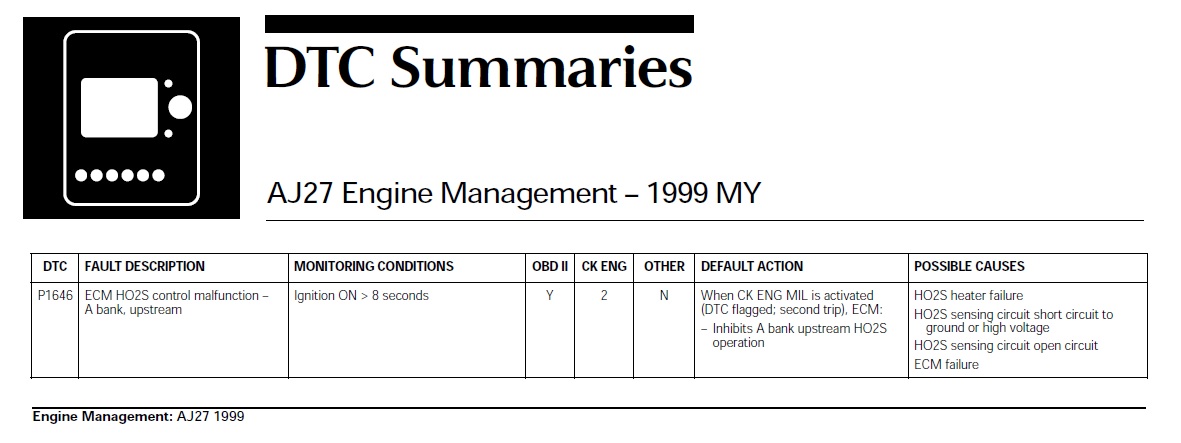

In the absence of any other codes or an obvious leak, it's all pointing to the HO2S:
MOT failure: lambda: 1.14-p1646.jpg
Harness faults are possible but unusual unless the sensors have been disturbed.
