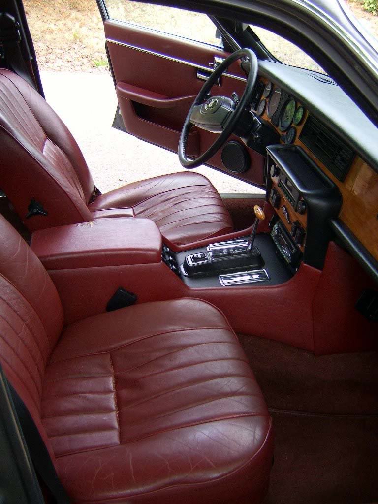

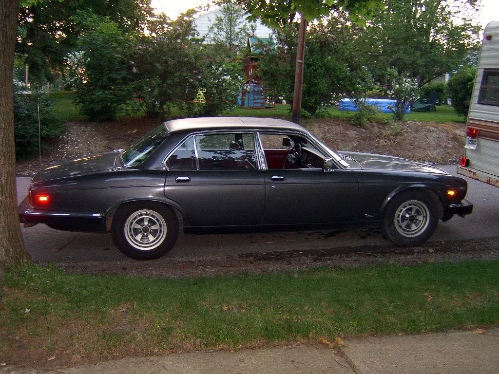

I had someone wanting to buy the car, he offered $1000 for it if i could get it running, I have it listed for $3500
The body has rust only on by the front window and the under carriage is excellent. He told me someone else was selling the same model year for $4000 and that my car was in much much better shape, that made me wonder why offer $1000 lol just venting on that last paragraph
here is what the car looks like, i think its snazzy! Does anyone think he was trying to rip me off or should I have taken the offer of $1000?
