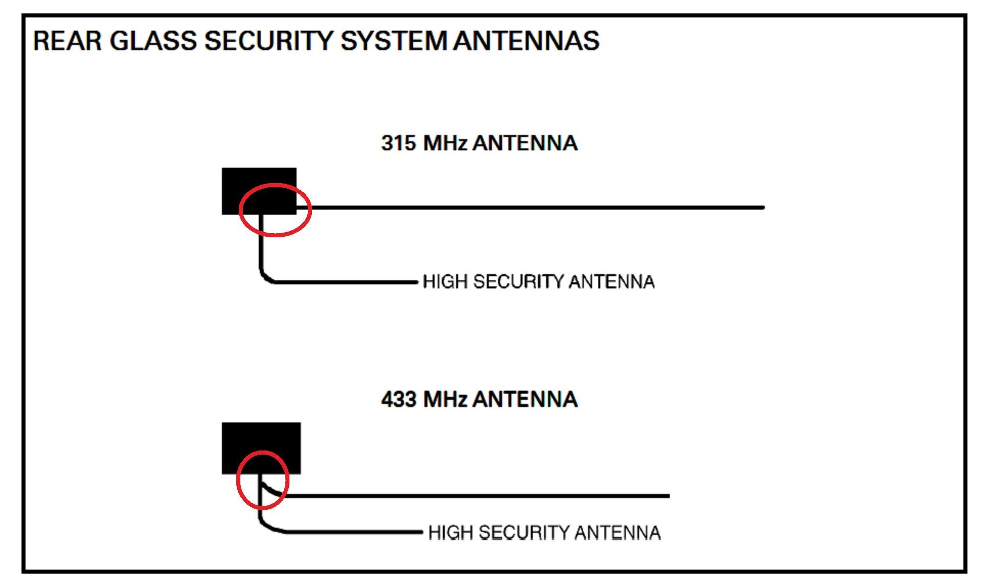

The FOBs come in 2 frequencies . 315 and 433 hz
you can look at the car antenna and tell the difference
