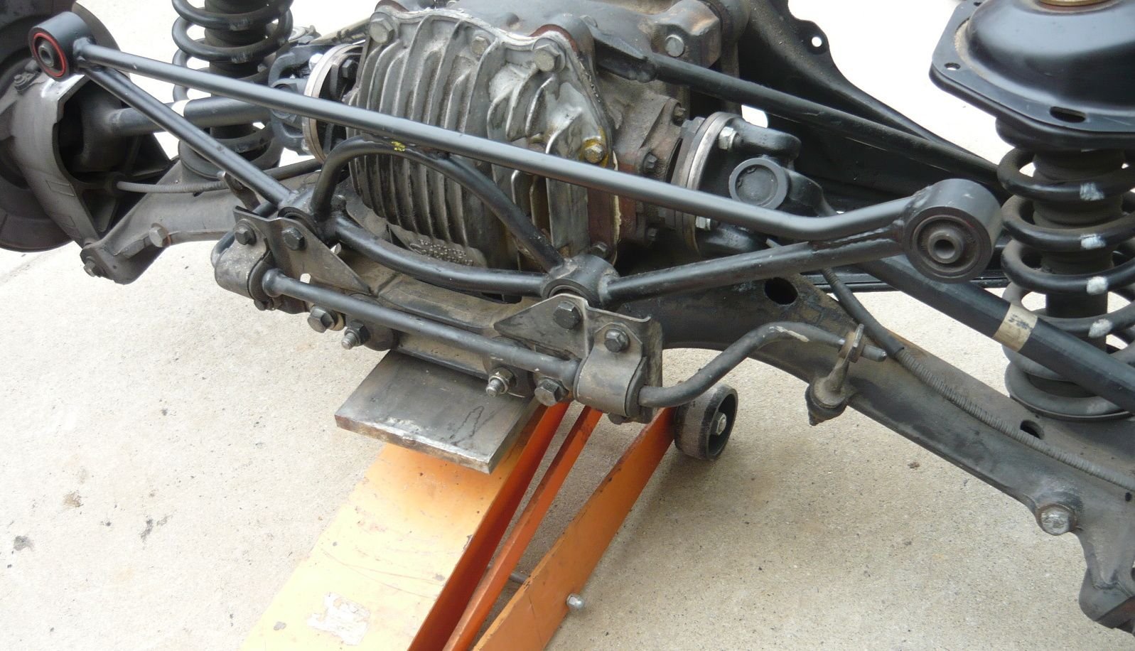

X308 differential monobrace , not hard to remove from donor X308
http://www.jagrepair.com/images/TSB/...usp%20tool.pdf
You can make your own tool to suck the old bushing out​​
Clean differential case breather port
Looking for Bearing retainer drill holes and split with a chisel TSB
