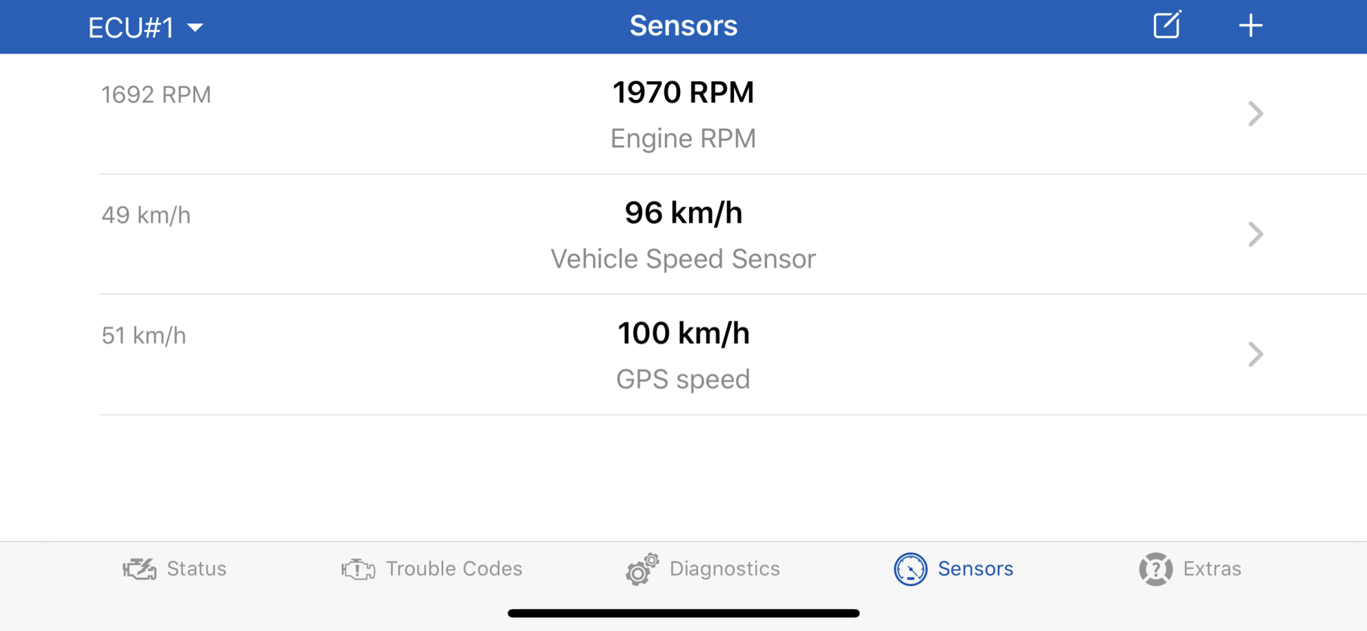

ive just been out in my car - screenshot from OBDII.
revs at 100km/h GPS speed would rise to 2150 in 5th gear with a 3.58 diff. I could live with that
