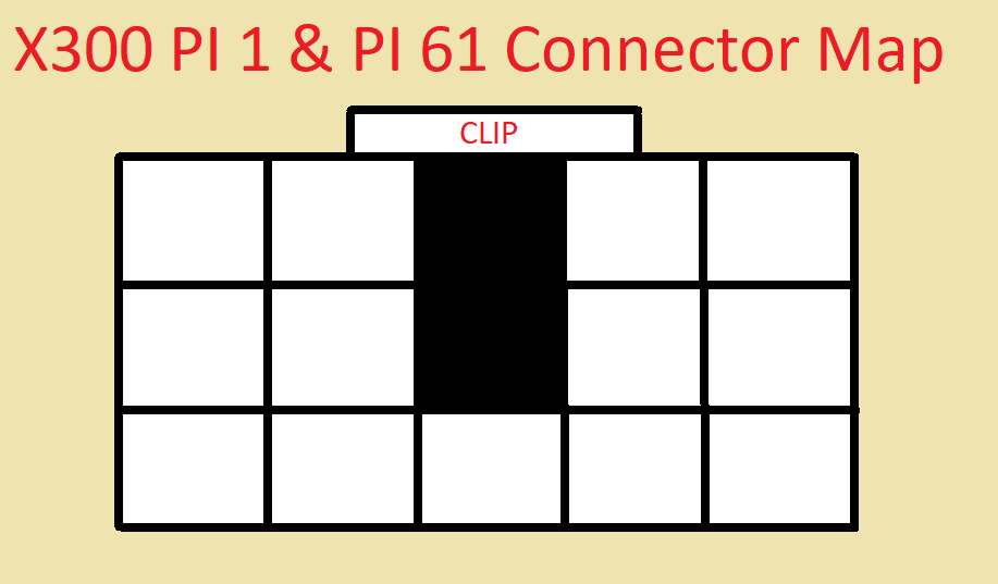

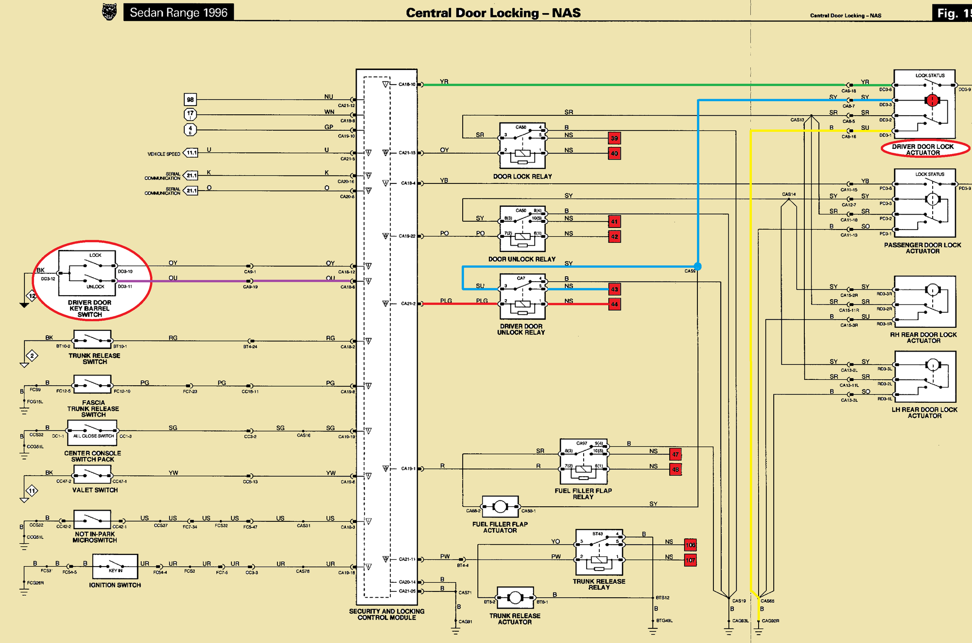

Old Aug 25, 2020 | 11:08 PM
Parker 2's Avatar
Joined: Nov 2019
Posts: 545
Likes: 261
From: Kansas City
Double click for larger image and drag around
Old Aug 26, 2020 | 03:32 AM
Alster370's Avatar
Joined: May 2017
Posts: 120
Likes: 43
From: United Kingdom
Lots of potential triggers for the alarm then!

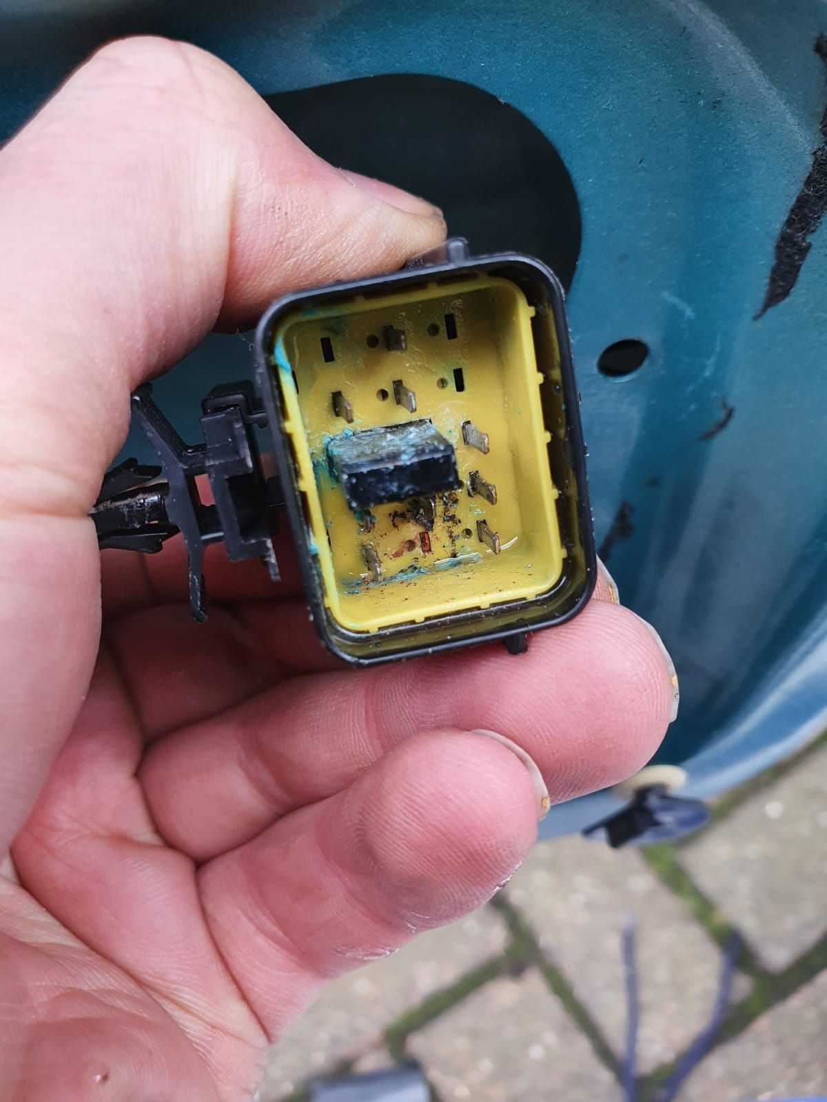

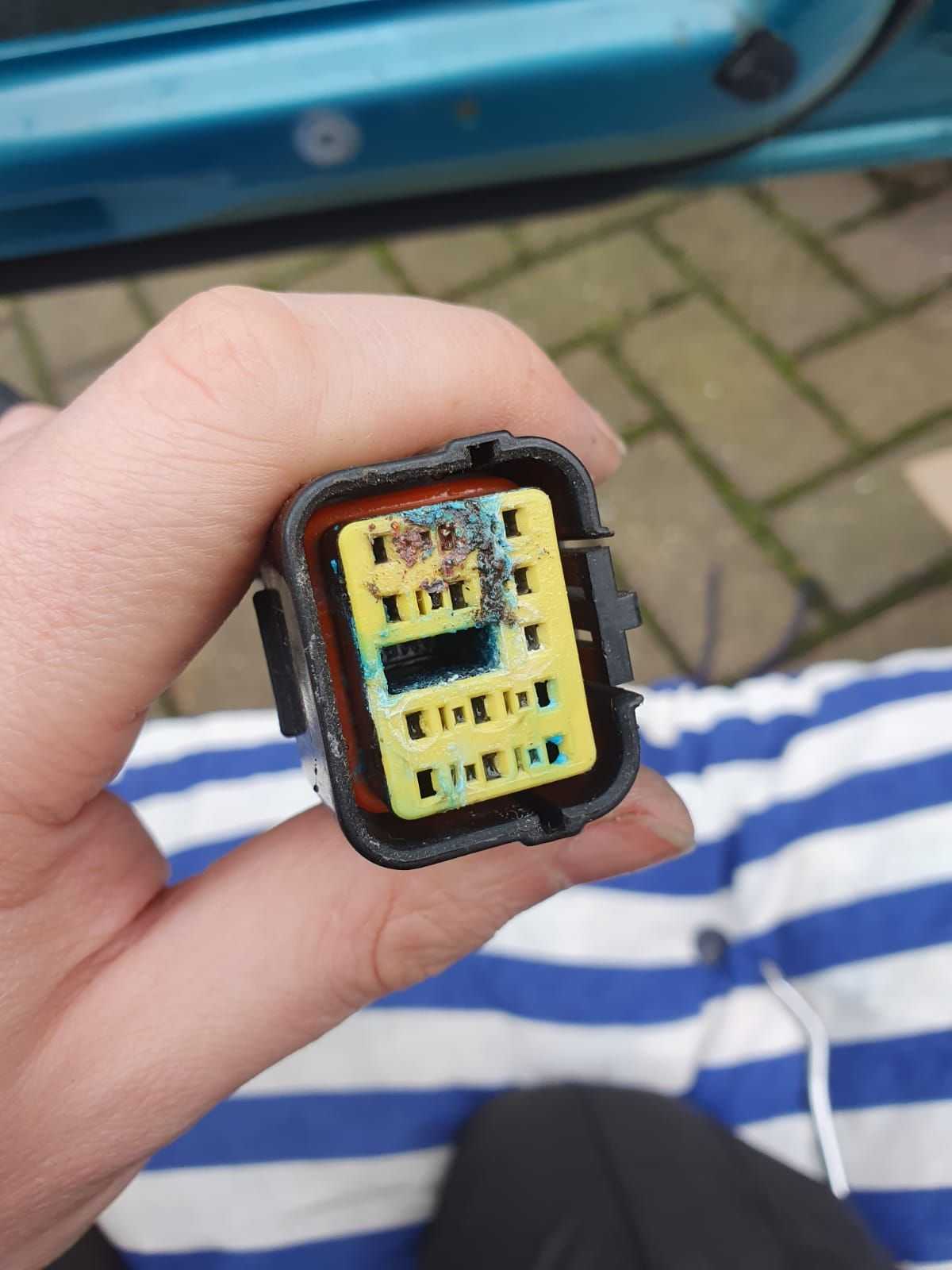

Old Sep 1, 2020 | 11:12 AM
Alster370's Avatar
Joined: May 2017
Posts: 120
Likes: 43
May have found the issue, not the door actuator, but plenty of water and corrosion in the drivers door wiring loom! Wonder how it got there... door drain hole clogged maybe?

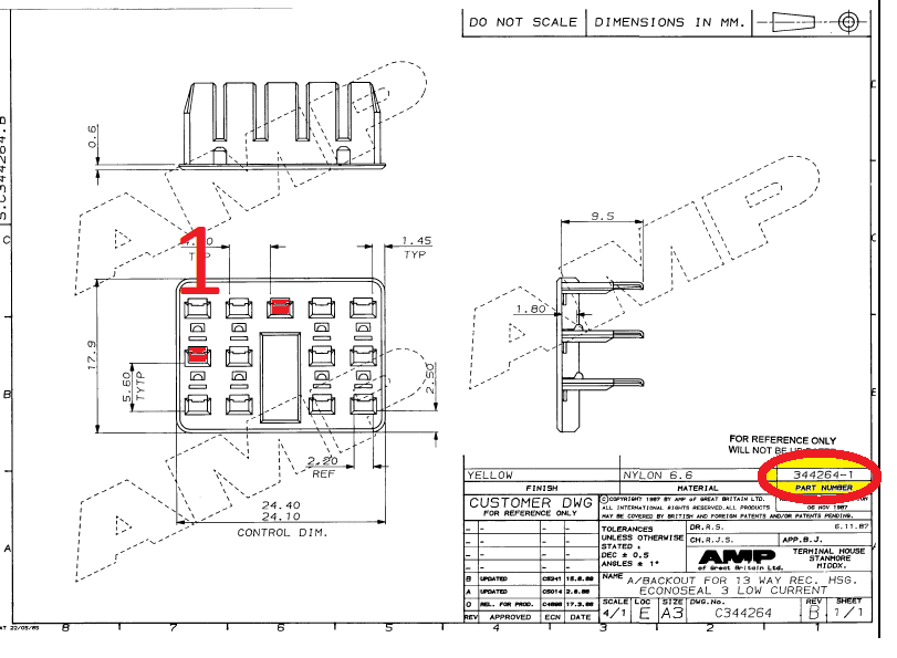

Old Sep 1, 2020 | 04:31 PM
Parker 2's Avatar
Joined: Nov 2019
Posts: 545
Likes: 261
From: Kansas City
https://www.3waycomponents.co.uk/13-Way-AMP-Econoseal-III-070-Series-Female-Sealed-Socket-Wiring-Connector-Kit
British distributor link

Thanks Parker for that connector link, will have to look at that if problem reoccurs. Another thing, in the 2nd picture I posted of the corroded connector, the bottom middle slot, isn't there supposed to eb a pin there? It looks like it's corroded and snapped off?
Old Sep 2, 2020 | 05:23 PM
Parker 2's Avatar
Joined: Nov 2019
Posts: 545
Likes: 261
From: Kansas City
It's referred to as a 13 way connector and has 13 pin positions
the space odyssey movie monolith acts as a orientation key way
