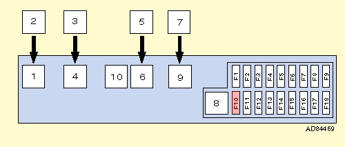

Ok, so I searched the Autodata and found that there's fuse for fuel pump under the rear seat and there's the relay for fuel pump in the boot.
They are the ones marked pink. Now the question is how to hook up to it in order to keep the fuel pump running. As suggested before, I'd unplug the hose in the engine bay and connect it to another hose which would then get the fuel where I want it to be. It's just the case of making the flippin' fuel pump work all the time. All the suggestions welcome, as my electronic knowledge is quite limited! Cheers!

Just jump the relay. Take out the relay and use a jumper (piece of wire) to jump pins 30 and 87 on the relay base. The pump should then work continuously. No need to have ignition on.

Cheers mate! Looks like my wife will be getting full tank of fuel soon

Success! I disconnected the fuel line in the engine bay, attached piece of hose I have prepared earlier, sealed the connection with some duct tape, changed the battery for fully charged one (I always keep a spare battery), got the relay out and jumped it with piece of cable with male flat connectors at both ends. And it started pumping, quite fast as well! In few minutes I pumped out around 30l of petrol! I know there's still some in the tank, but I've left it there, not being sure as what sort of crap could be at the bottom o.O
