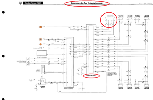

There are 3 fuses for the stereo , looking up
You have the premium system with the power amplifier and CD player and subwoofer in the trunk
# 1 - 25 amp trunk fuse box
# 8 - 15 amp trunk fuse box
# 5 - 5 amp trunk fuse box which includes point 109 as the power antenna motor , wipe and put so spray lube on it as they bind

Thanks Lady Penelope, it was the fuses that had blown. Tunes are back on. PO must of blown them when he installed the new battery before I picked it up from him.
