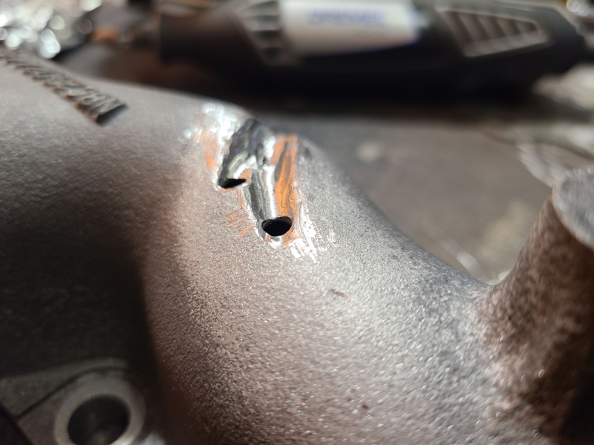

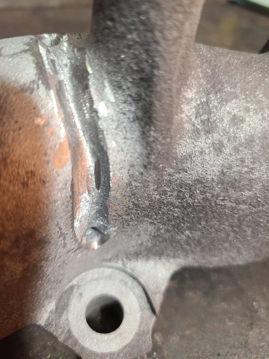

Last year I removed my exhaust manifolds to try and repair the cracks. I'm finally getting around to posting about this but I wish I would have done it sooner so I remembered everything. Hopefully most of it comes back to me as I type this. This is something that can be done mostly by a regular person in their garage. The actual welding or brazing and machine work would need to be done by others if you don't have the equipment.

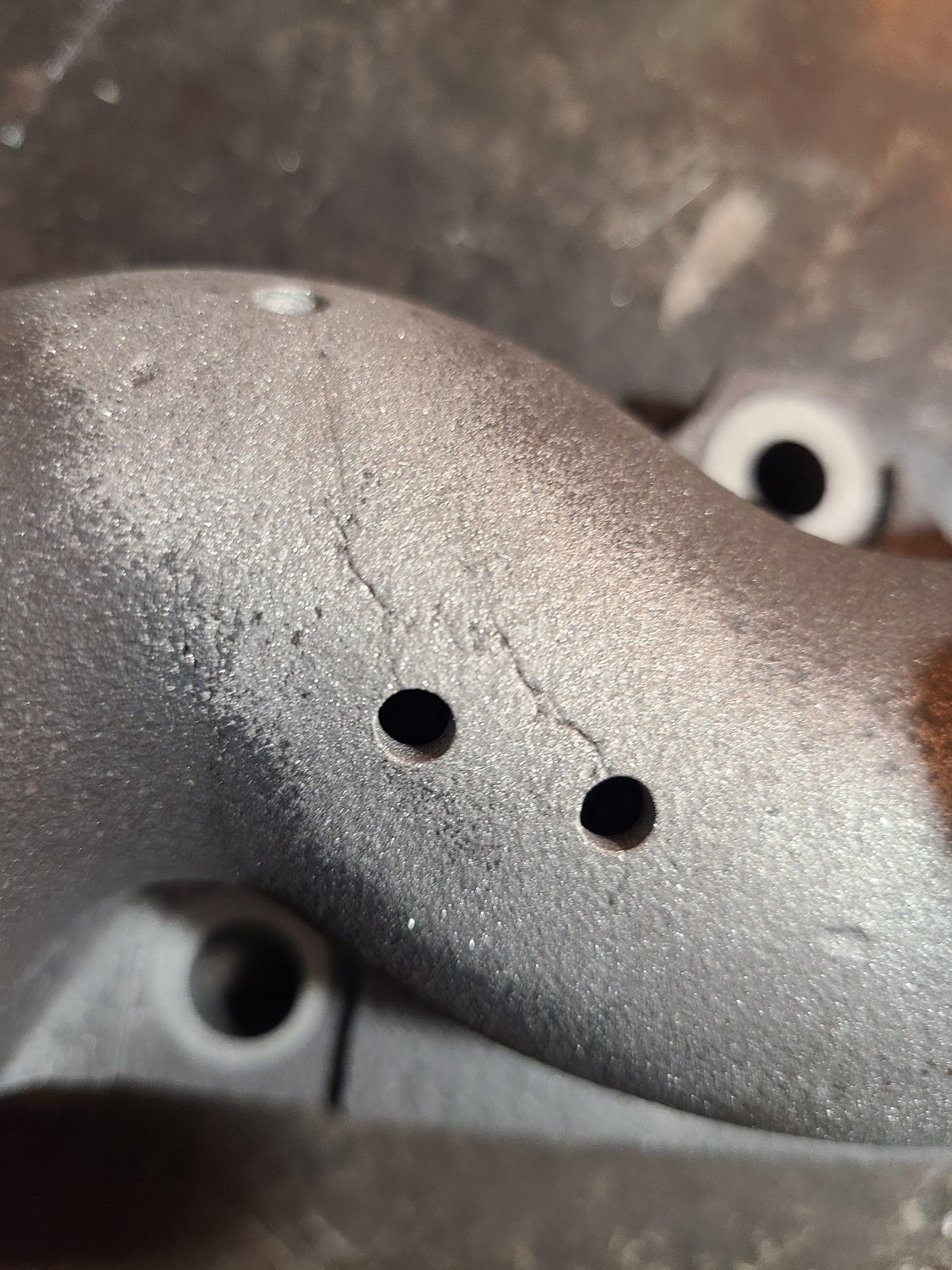

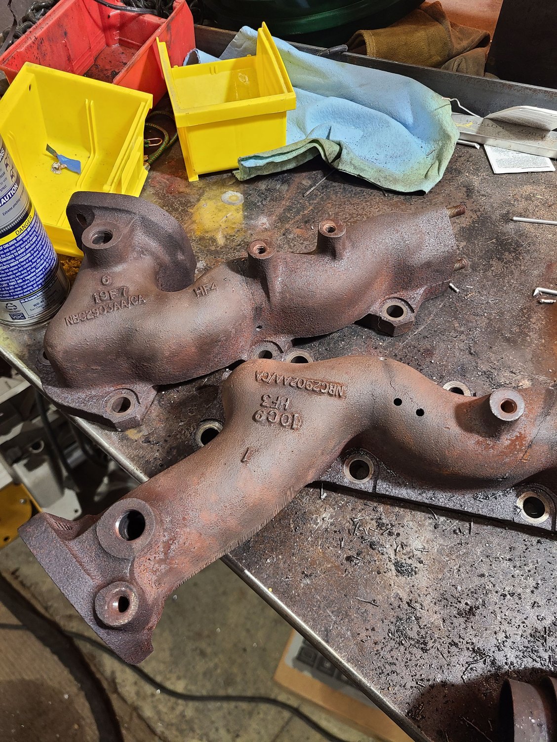

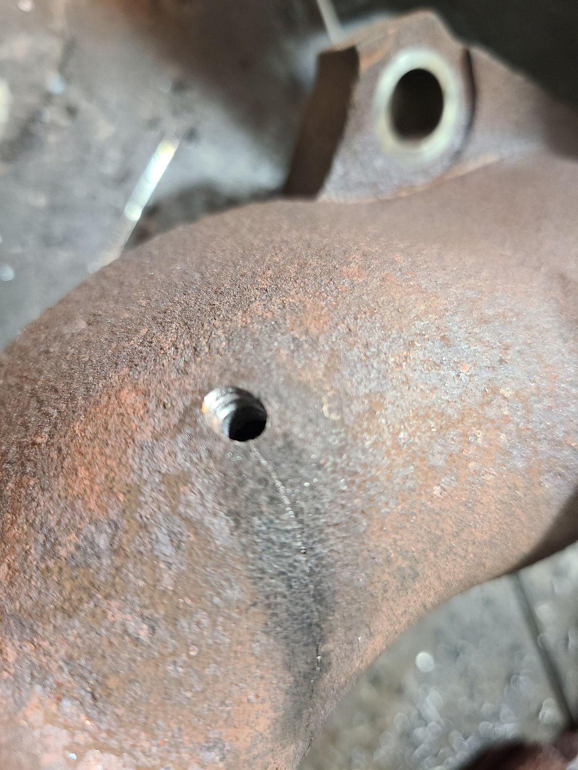

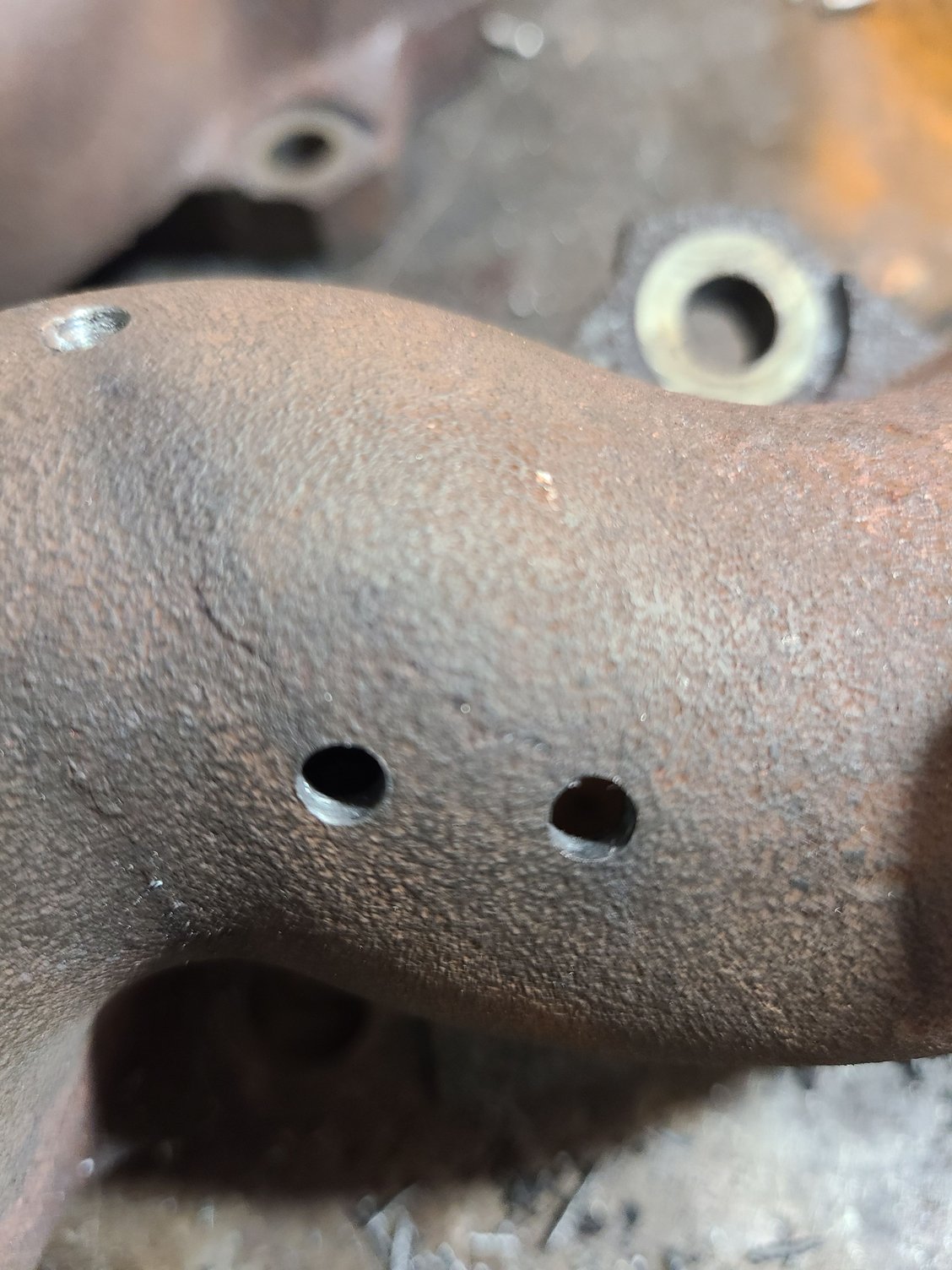

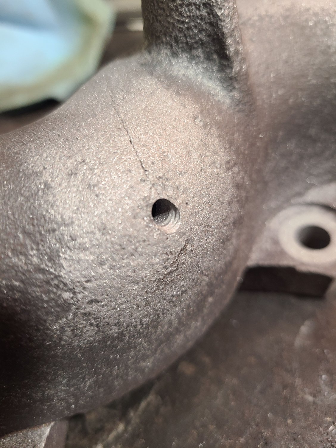

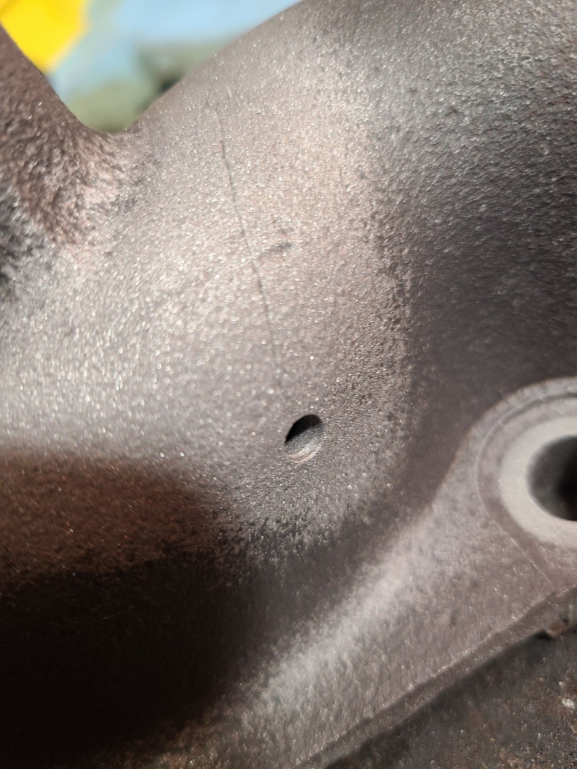

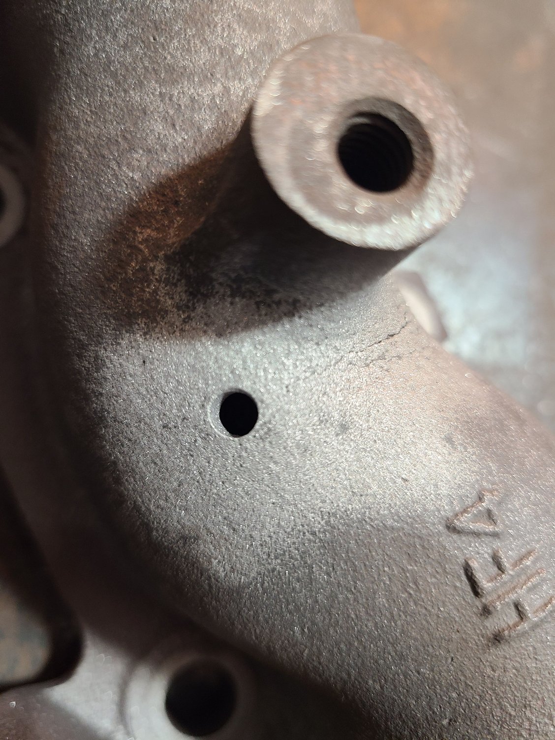

Here are a few photos of what I was starting with. The cracks are hard to see, even with a hole drilled at the end of it!

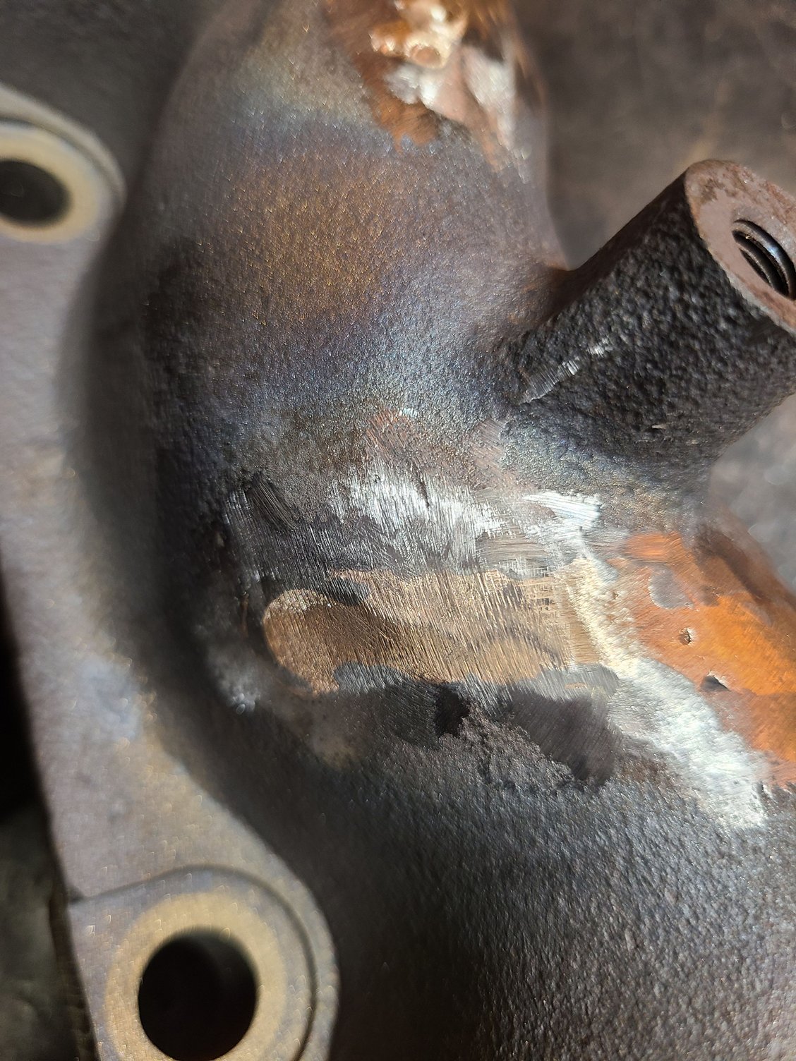

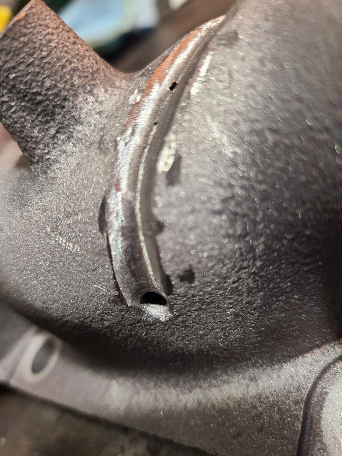

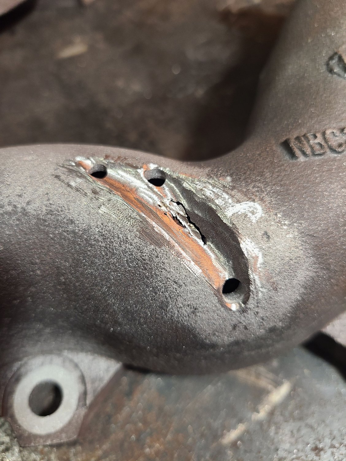

Next I ground out the cracks.

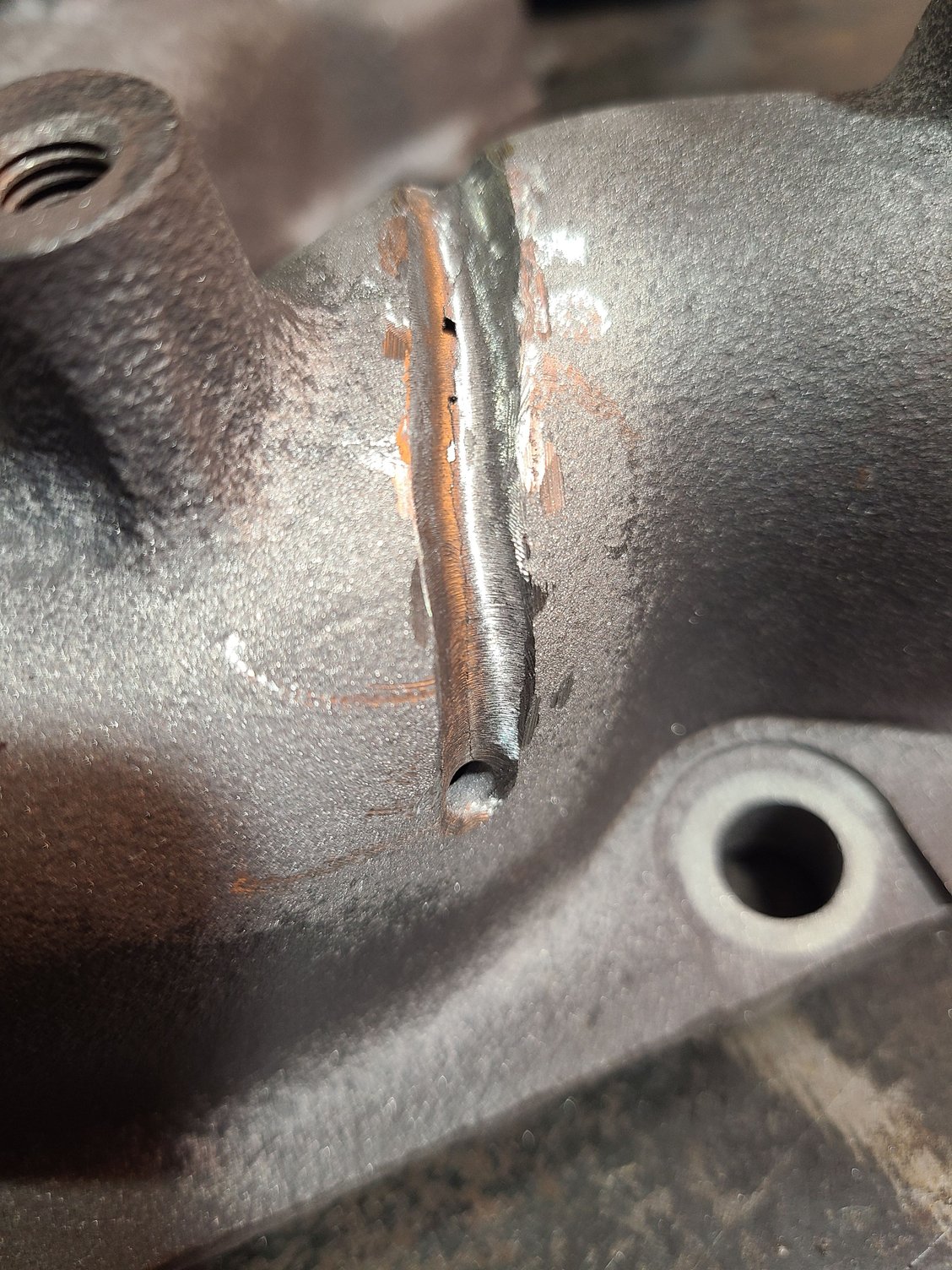

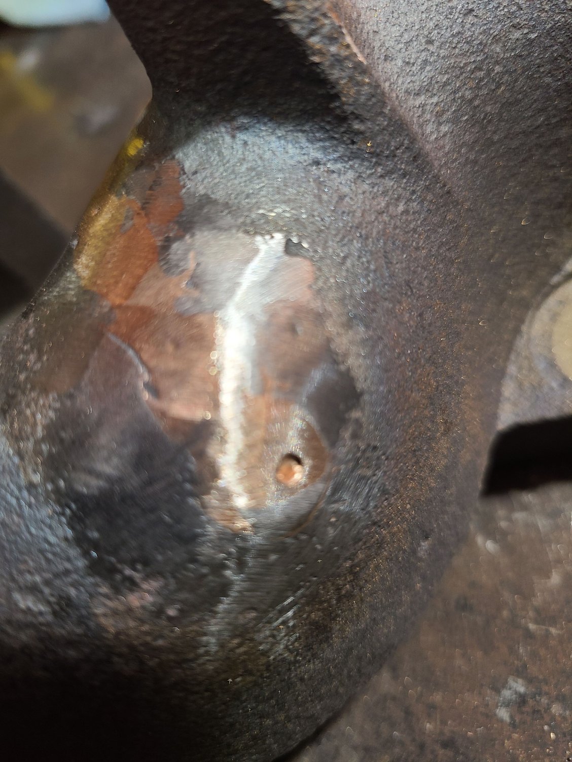

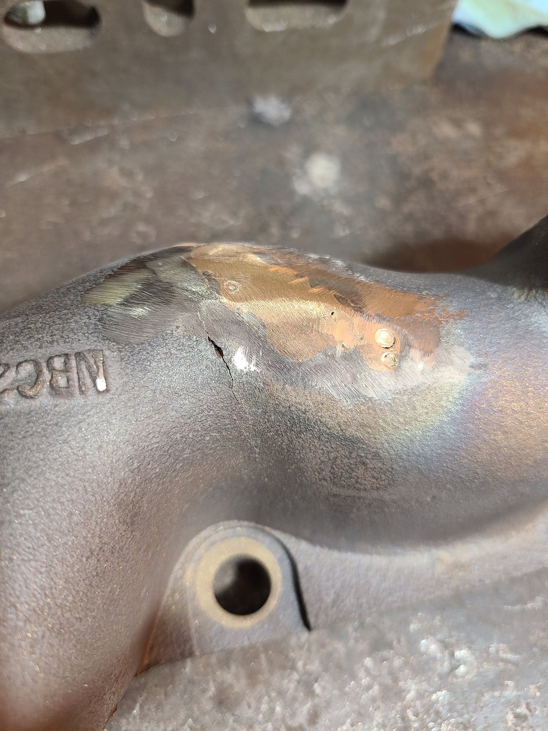

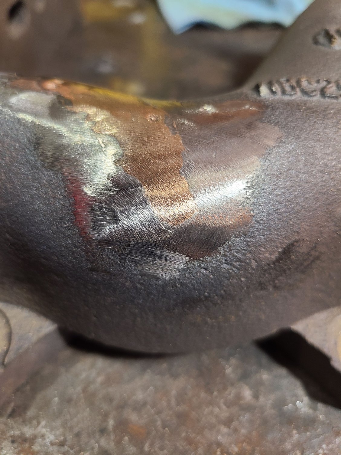

I chose to try the brazing method using silicone bronze brazing rod with my tig welder. I first cleaned everything then put it in the oven at 500 degrees for two hours. This is supposed to limit/reduce cracking when brazing/welding as the base metal is already hot so the temp diff isn't as much. However I watched a nice crack form right next to the one I was filling on the first try! See it here.

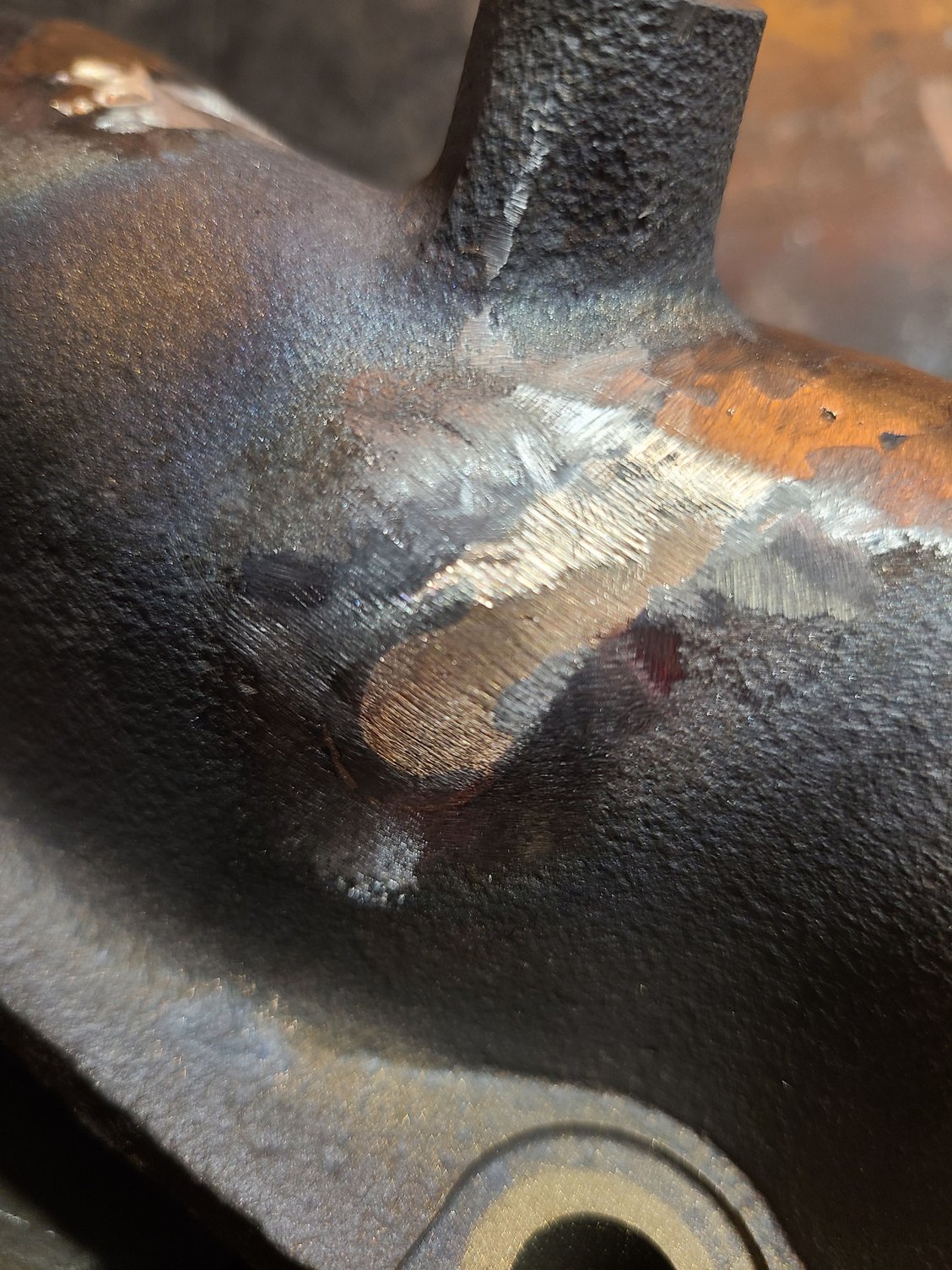

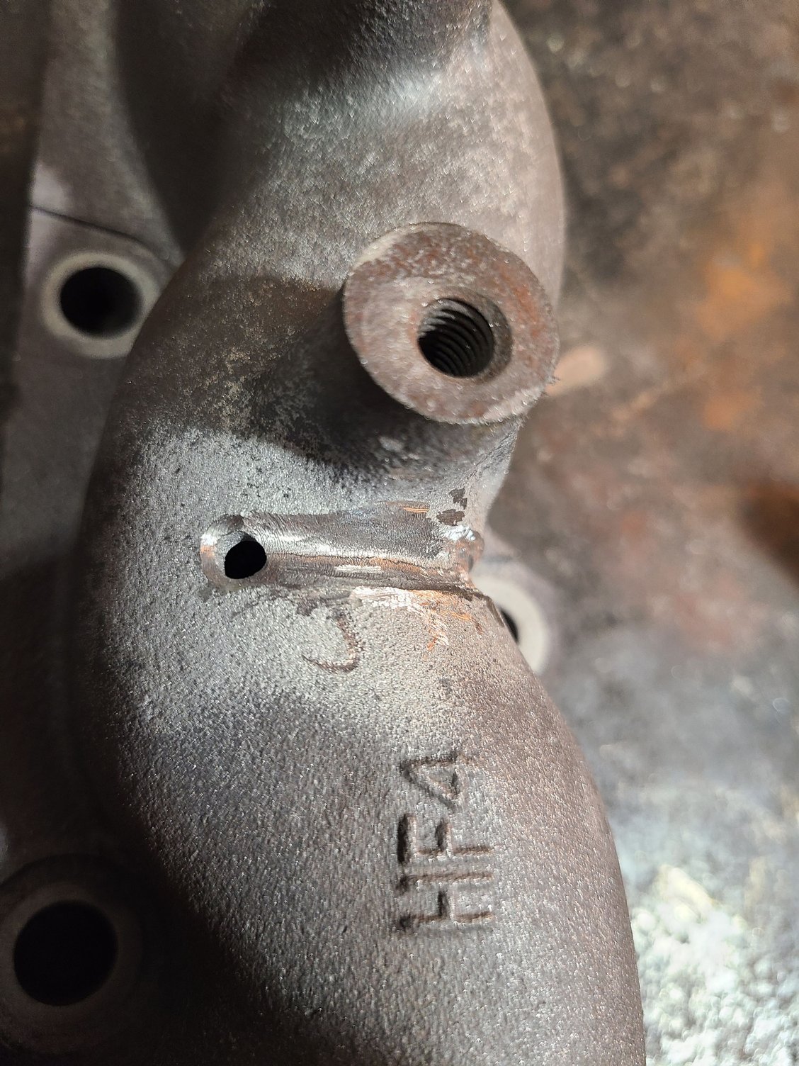

I kept going knowing I would have to do the process all over again to fill that one. From my research you want to get in and out as fast as you can. They were wrapped in a welding blanket right out of the oven and as soon as I was finished brazing I put them in a huge bin filled half with sand, then covered them in sand and let them slowly cool for a min of 24 hours. Here are a few more pics after brazing and grinding flush.

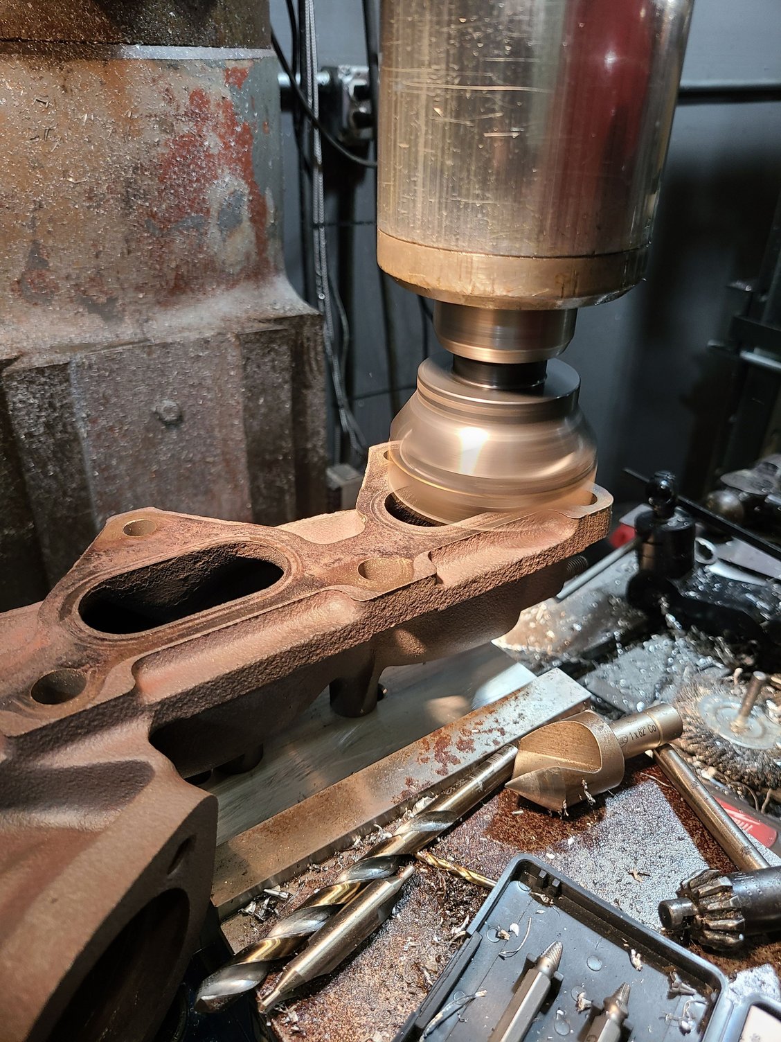

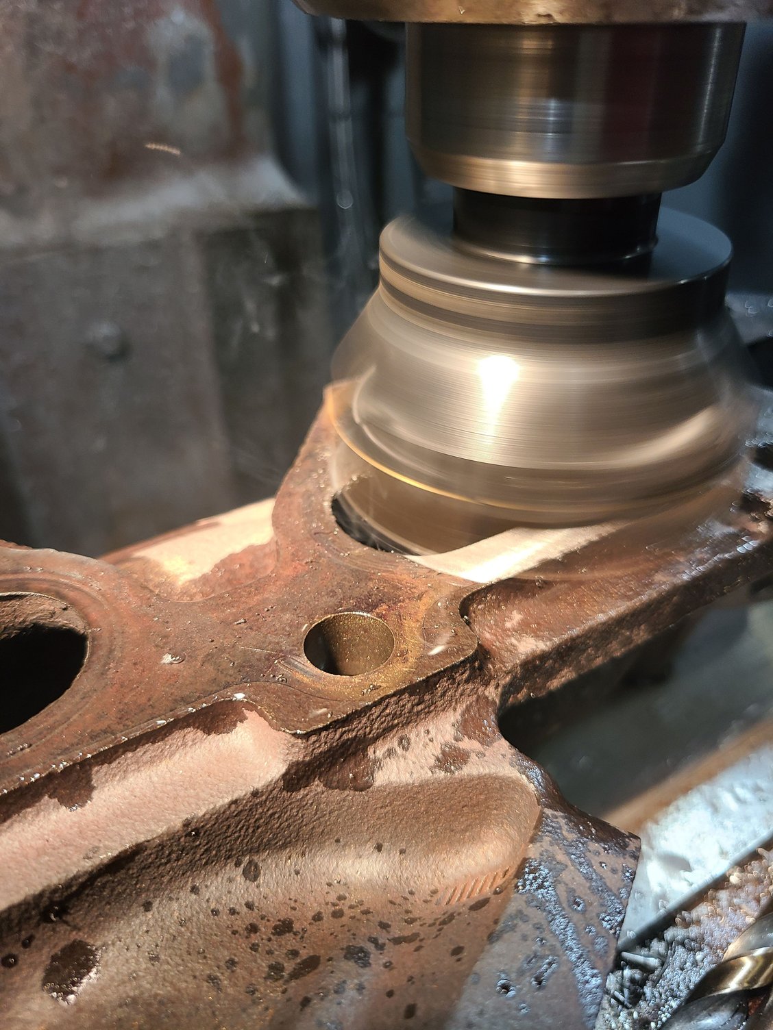

I had to buy a long shaft carbide burr to get inside and grind down what melted through. I had checked the manifolds for flatness before doing this process and they were NOT flat. After the process they seemed to be just as warped as before. I have a milling machine so I made a fixture to hold them and had to take about 0.030" off to make them flat again.

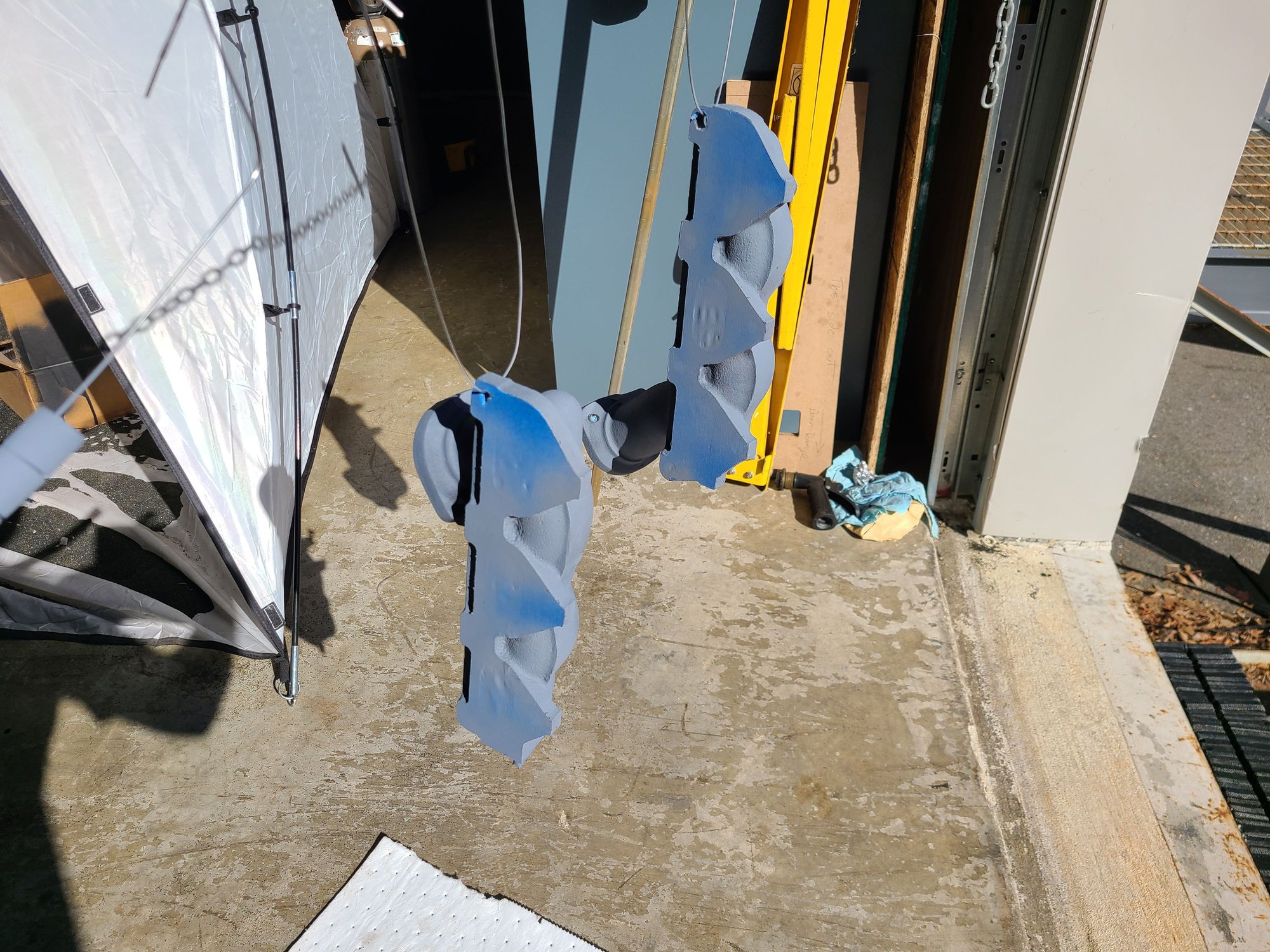

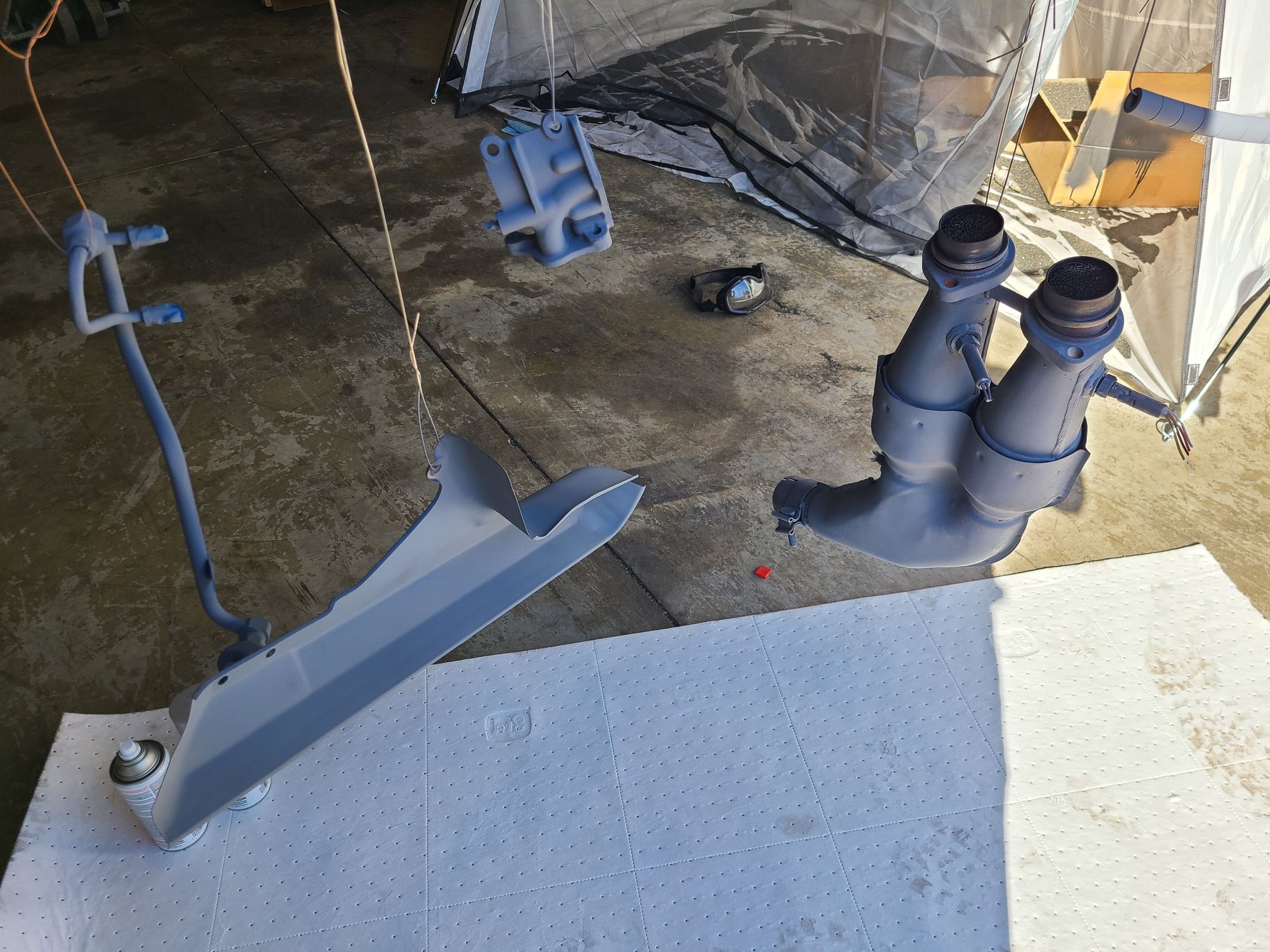

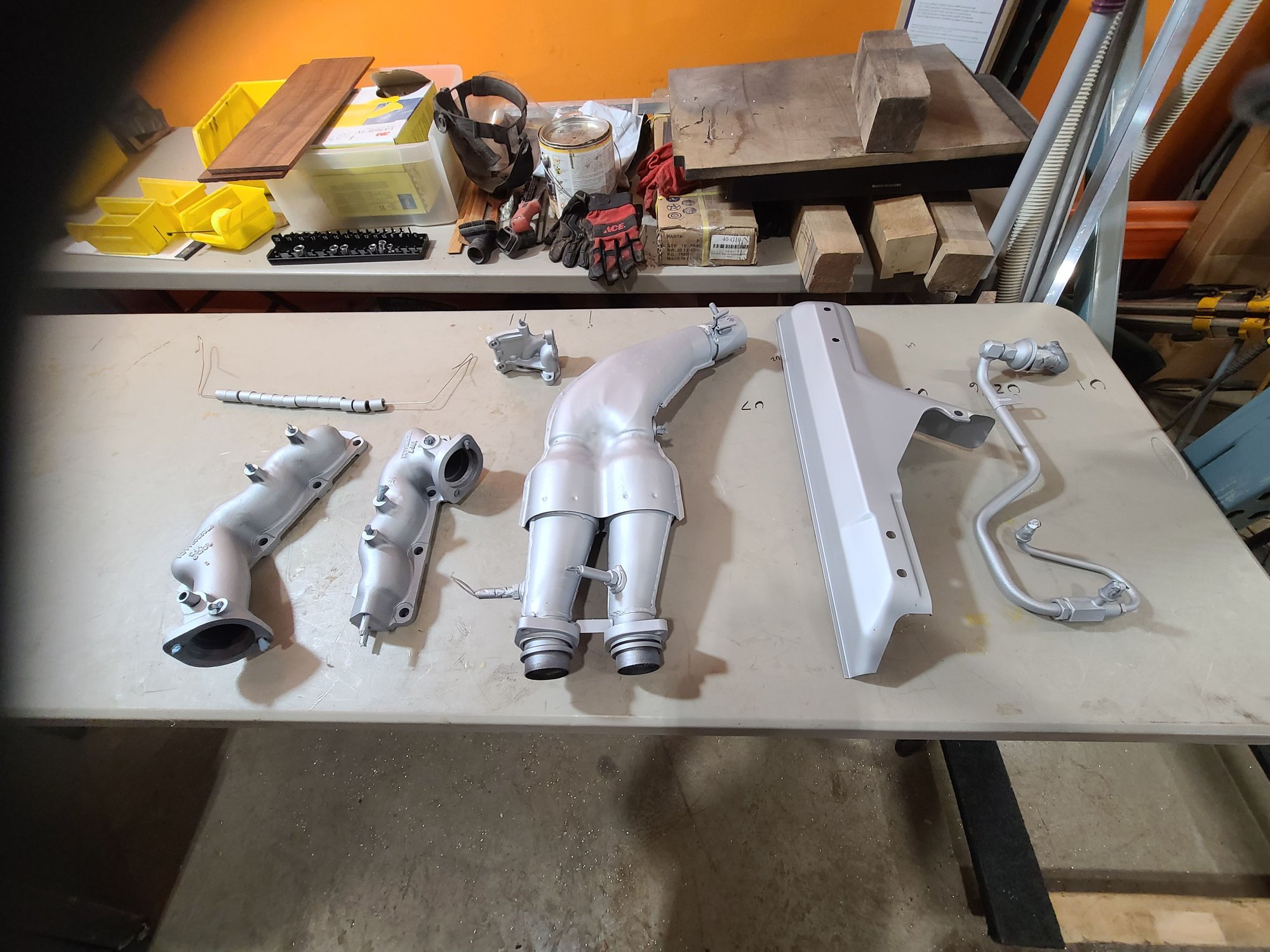

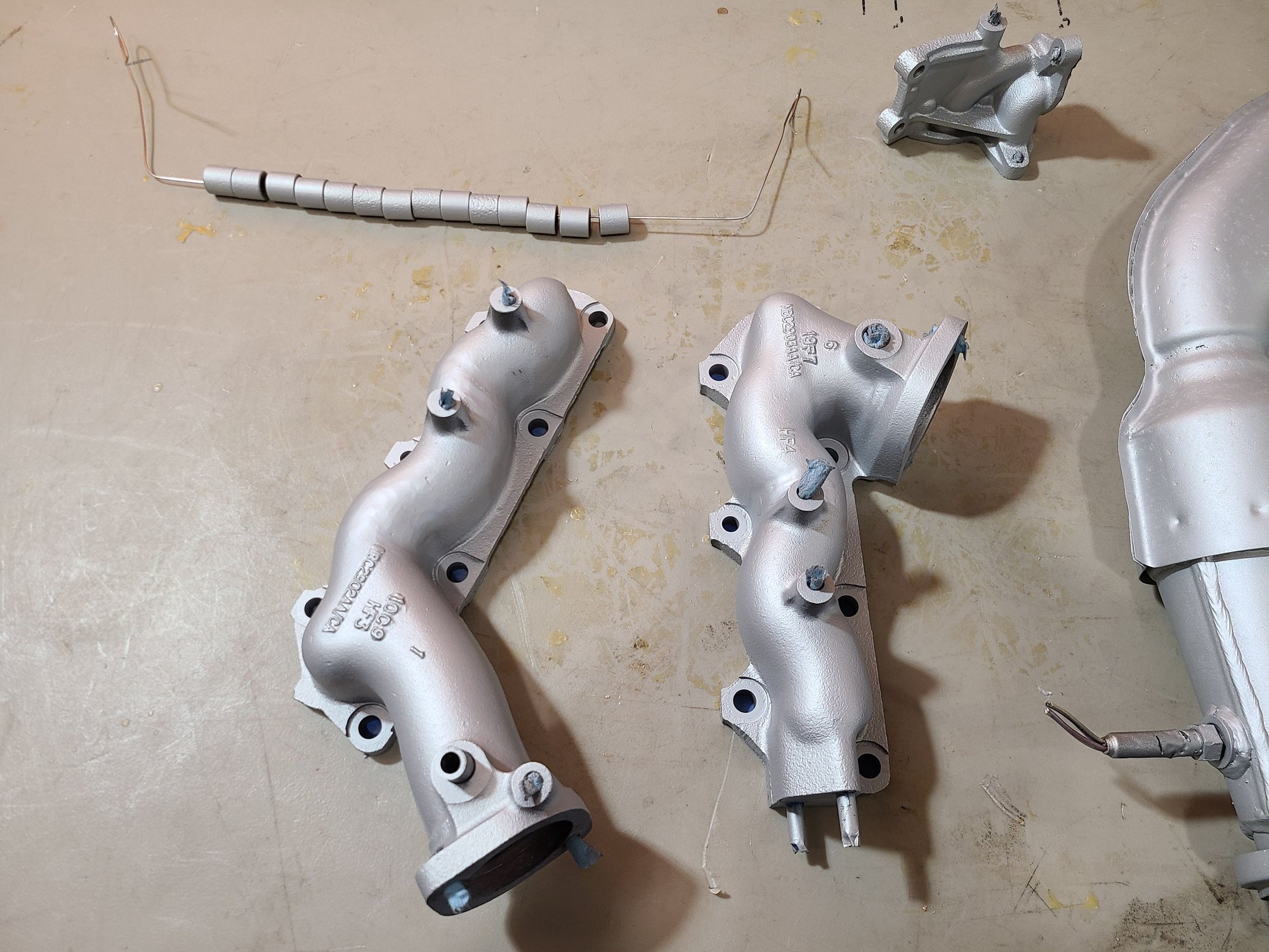

I finished sandblasting them along with some other parts from that area of the car and painted them with high heat paint.

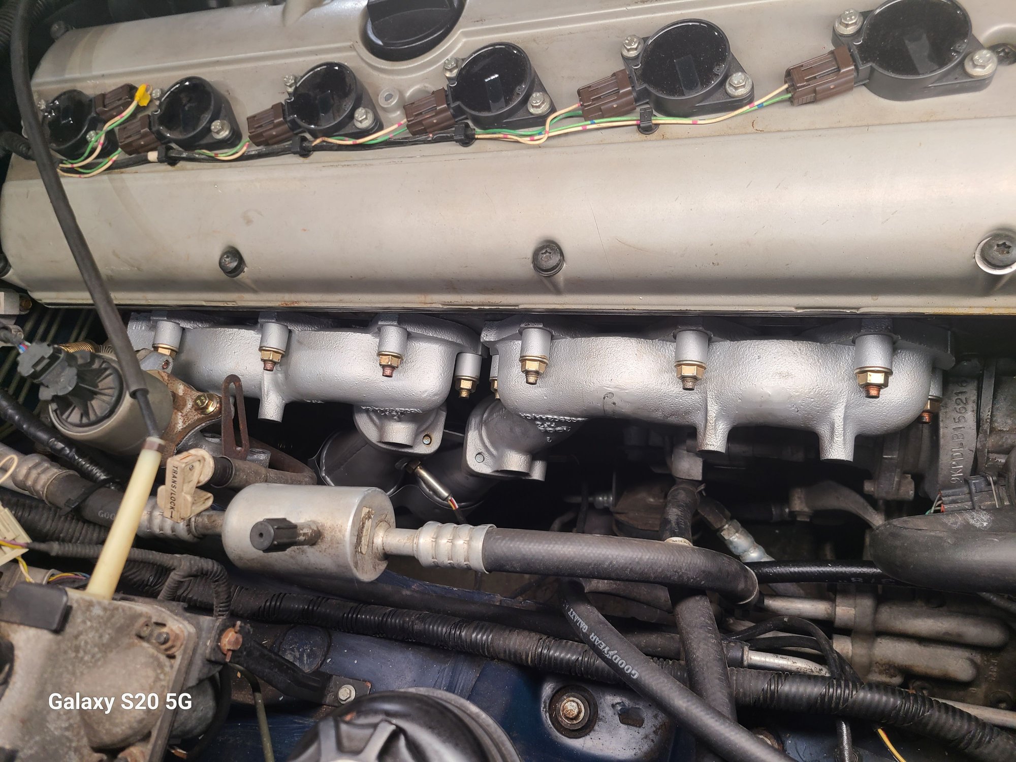

I bought new donut seals and manifold gaskets along with new proper hardware and 4 new O2 sensors. I torqued everything in place, got the car up to temp, then re-torqued.
Results. After heating it up a few times following both the paint and torque instructions, I removed the heat shield to re-torque the manifold nuts. The rear manifold was perfect, but the forward one had formed another crack. It's small but was somewhat demoralizing.

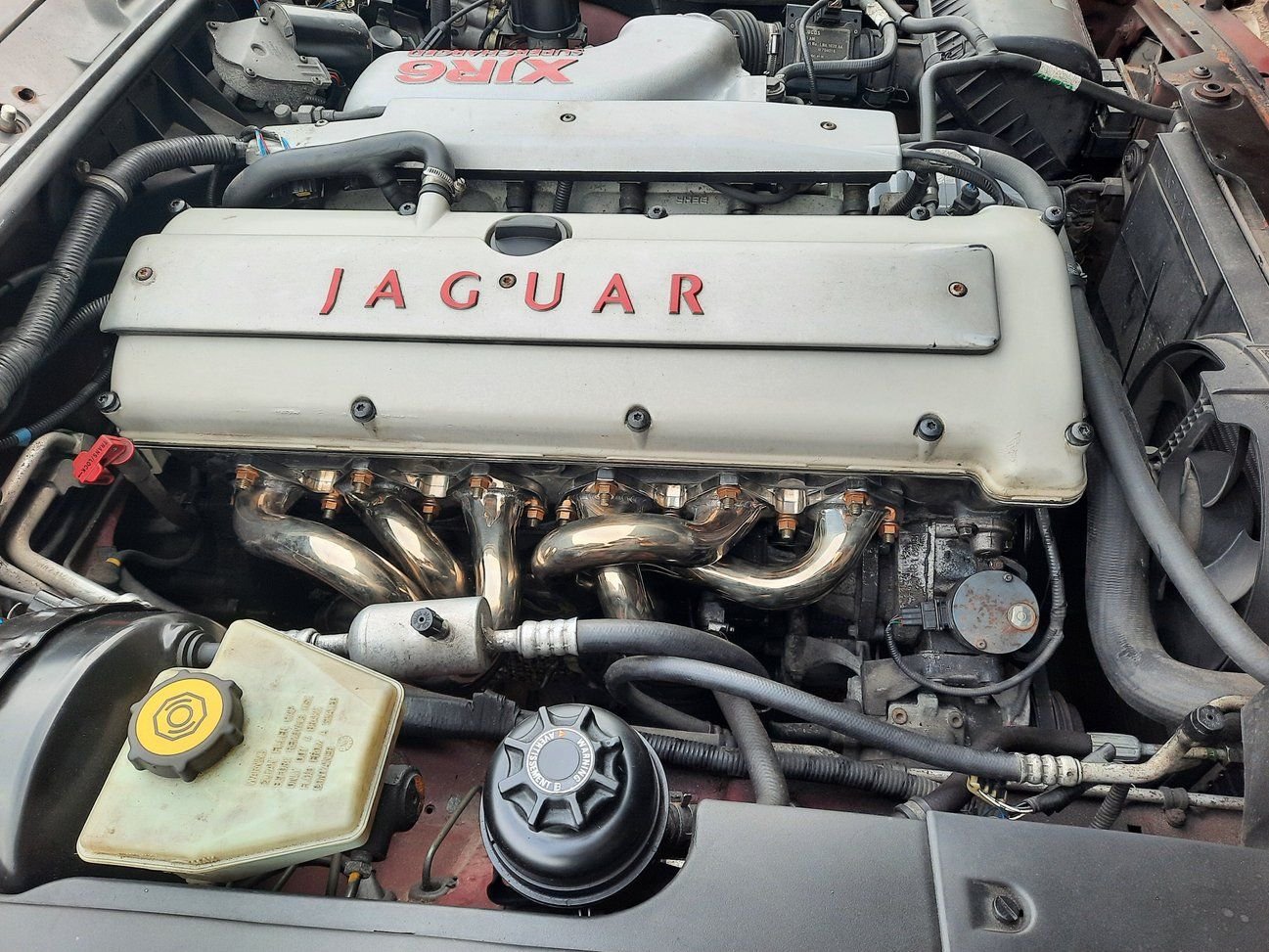

I realize you may be looking to keep your car all original, however you may like to have a look at my solution.
Car stalling. Will not hold idle.
Post 30/6/25 has photos of the result.

To stop the creep, you need to drill in a round hole at the existing end of each crack.

Originally Posted by avanti357
What brand of coils are those? Mine are original OEM and I would like to replace all 6
Old Oct 14, 2025 | 03:33 AM
avanti357's Avatar
Joined: Jan 2017
Posts: 72
Likes: 91
From: Annapolis, MD
I think NTK made in japan. I saved the boxes and put the old ones in them. I will check tomorrow and let you know.

About the coils: Keep that "Jaguar" name cover on the cam cover OFF, it retains heat, big time. Those coils hate heat.

You might do better with welding rods intended for use on cast
Or have individual multi branch pipes made up as per photo
