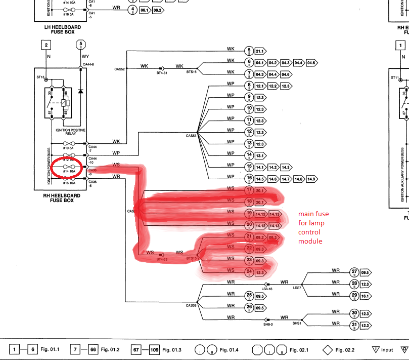

the high mounted stop light is on totally different circuit to the tail light brake lights.
it is not connected to the lamp control module and runs off its own relay.
so the high mount working indicates that yes the brake switch is working correctly. but does not rule out all fuses
it confirms that fuse #14 on the RH heelboard (being the main taillight fuse) must be working but does not rule out *one other possible fuse.
check Fuse #6 in RH heelboard.
are you sure the lamp control module you purchased is infact working correctly?
as yes LCM would be the likely culprit IMO.
do all other lights work?
is it possible that the wire has come loose on the plug at the tail lights?
seems odd that both sides would be affected by this but you never know.....
Last edited by Spud Maat; Aug 15, 2022 at 06:42 AM. Reason: *edited for clarity due to error reading wiring diagram

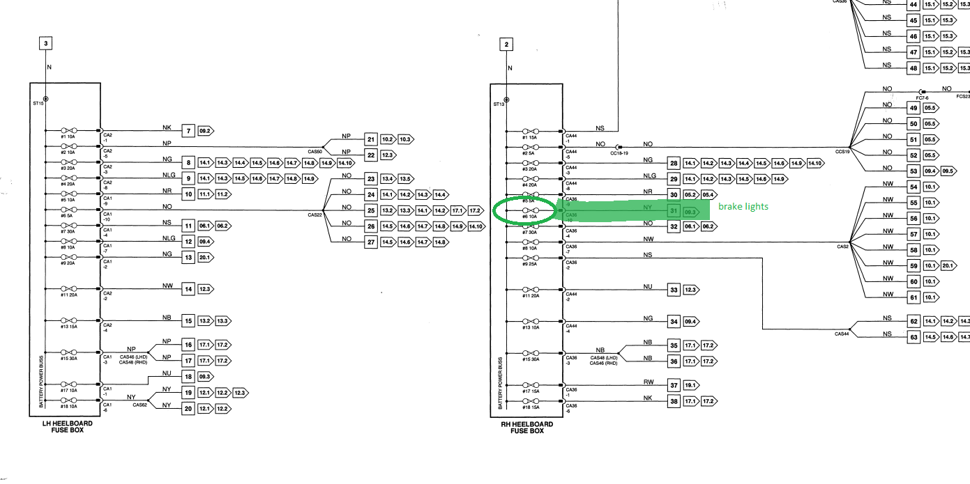

i did make a mistake above and have edited.
fuse #6 in the RH heelboard is for the 2 rear stop lights.
what i mentioned as fuse 14 in the lh heelboard is actually the revers lights. i made an error when reading the wiring diagram
the high mount is seperated from the two rear most lights for redundancy so if something goes wrong it is unlikely to lose all brake lights as it bypasses the lamp control module.
see attached images

1 - brake switch - tested working as high mount works.
2 - rh heel board fuse 14 (lcm fuse) - tested working.
3 - rh heel board fuse 6 (tail light fues) tested working.

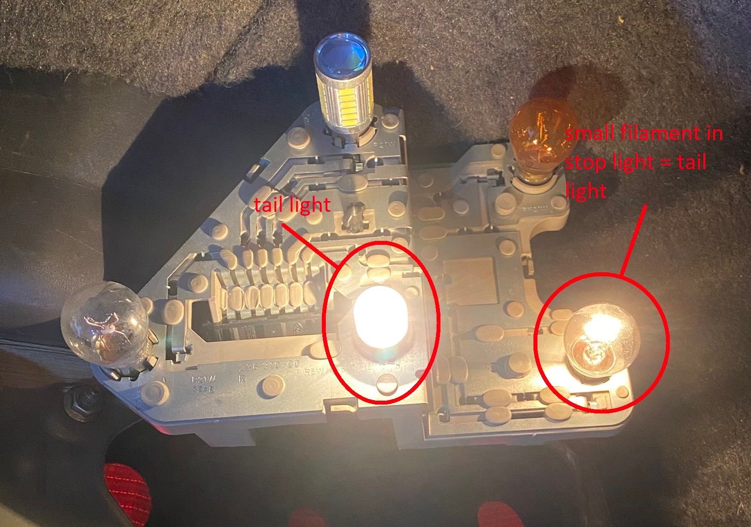

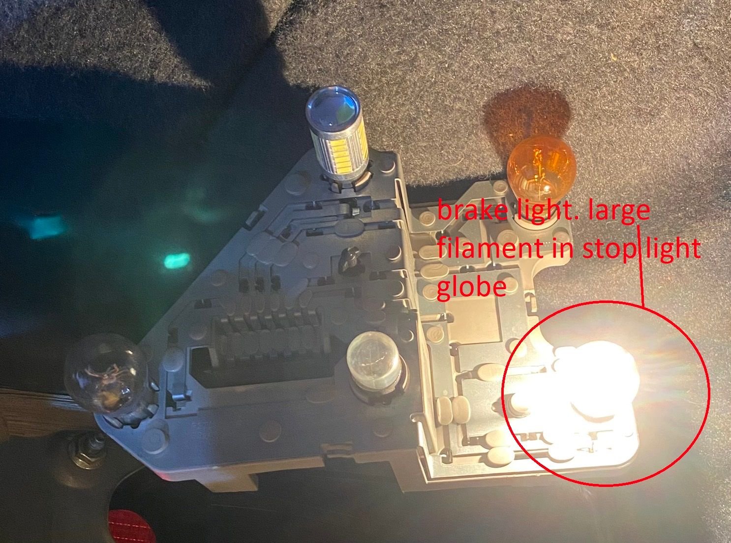

the rear fog light is not the same globe as the stop light.
the stop light globe also has a tail (park) light but the fog light is seperate.
SEE ATTACHED IMAGES
maybe you checked the wrong globes before?
check the tail/brake lights and and make sure the large filament (brake light) is all good.
maybe just change them anyway as if the filament is slightly broken it may appear still good.

tail lights on
fog light on (tail lights need to be on for fog light to activate)
brake light on only
