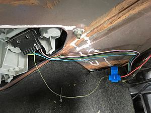

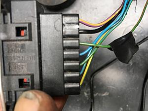

The photos attached show the wire in question for my 1996 3.2 XJ6 X300. It is marked with a piece of insulation tape but is the wire between the solid black and blue.
It is a case of simply connecting into this wire and the required 'firing up' takes place on selecting reverse gear without any extras.
I hope this helps anyone who needs to find this wire for anything that needs power from targeting the reverse selection.
