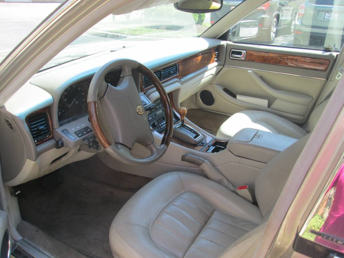

Hello all, I just bought my first Jaguar today an 1997 XJ6L for $1,000 and I'm very excited about it. She's going to need some work done to her but i know that it will feel great once i get her back to original. The reason Im posting this Today is because something unsuspected happened. I just drove the Jaguar back to Virginia Beach from Washington where I bought it from and everything was great good drive about 200 miles. Once i got back to Virginia I filled the tank back up ( it only used half a tank on the drive down) and drove it on base(Navy) to my house onceI got there parked it and went in for a few hours. I just walked outside about 30 minutes ago and the car will start strong , lose RPM's , and then sputter out to death. If anyone could give me some wisdom here that would be greatly appreciated. I've been following the forums for awhile when I was in the looking stage and found a lot of wisdom here. Also I'll be posting updates on some of my minimal restorations. Thank you all very much. Also some pictures of the car below.

Your is specifically a X330 subgroup of the X300 series being a longer wheel base Sovereign like Penelope . Yours looks as though very low mileage based on seat wear . Mine is 110,000 miles with original excellent Nautical Mica ( shading blue to green depending on the light ) and I painted the whole wiper blade , arm , and whole trough behind bonnet platinum white to give her a splash of class . She is the prettiest Jaguar on the whole block , literally . If I had given watchit a male name it would be Admiral ( cue the Boatswain's Whistle )

Yeah it Only has 130,029 on the dash right now it was owned by 2 people I'm the third clean title no accidents , the first owner had it on lease i believe from 1997 to 2001 and that's when the nice lady I bought it from took possession. She was in the foreign service so never really drove it that much only when she was home from traveling. And yes that is very Beautiful I'm hoping to get mine to that condition soon. I'm doing the paint job next week but having a hard time debating on whether or not i want to keep the original color or go with some darker like black or blue. I really love the original color though especially with the British green pin stripes.
