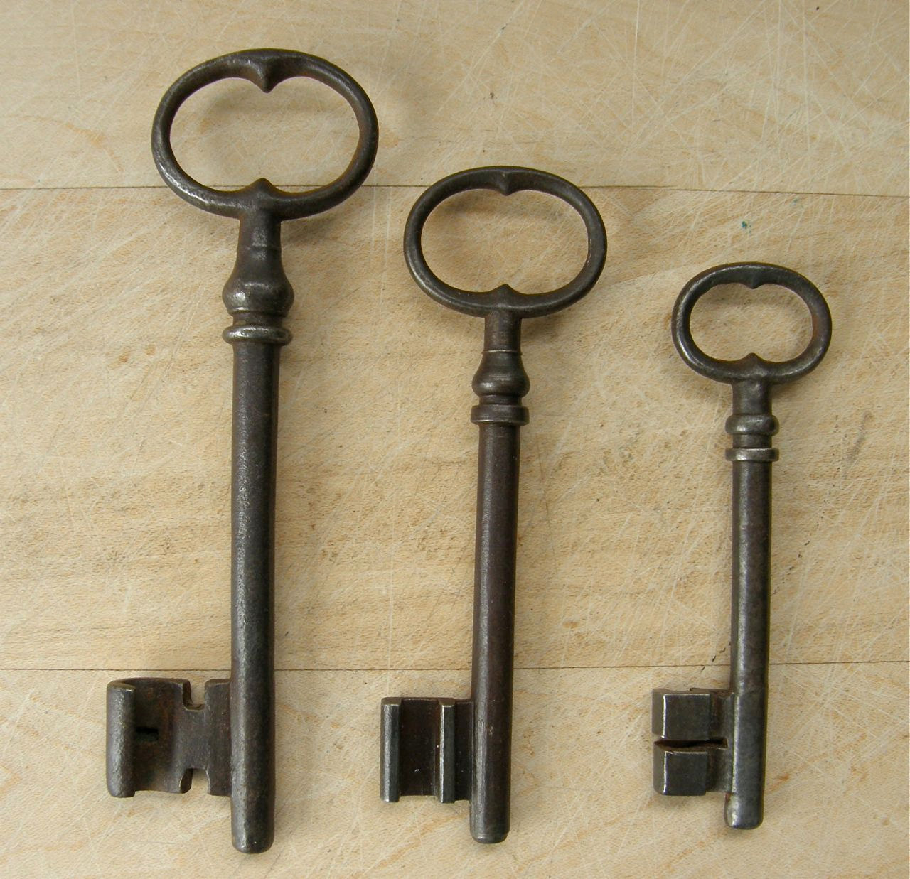

Our keys look like this
Attached Thumbnails Flat Battery - Boot Key Lock Seized-il_fullxfull.367378506_gggs.jpg

Which one is the valet key?
Well then you don't need lock lubricant. The tumblers are so big the lock lubricant wouldn't stay. You pack them with the cart axle grease from the ironmonger.
See how well your local retailers understand their market?

those keys aren't X300, they're Swallow Sidecars ones
