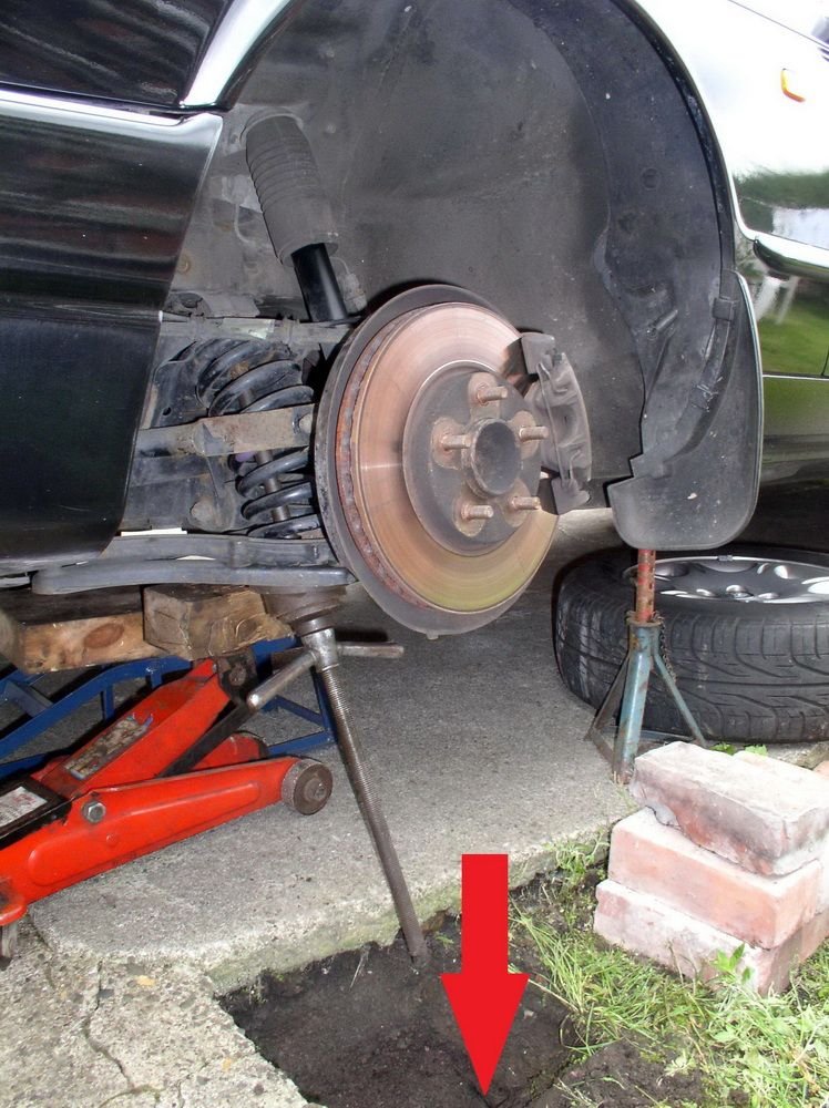

Old Dec 9, 2019 | 12:20 AM
Likes: 17,009
I reversed the vehicle height problem and dug a hole to clear the bottom the the threaded bar!
It does require a surprising height off the ground for clearance.

Gave up trying to get high enough for spring comp and used threaded bar method. Worked ok but sloooow
