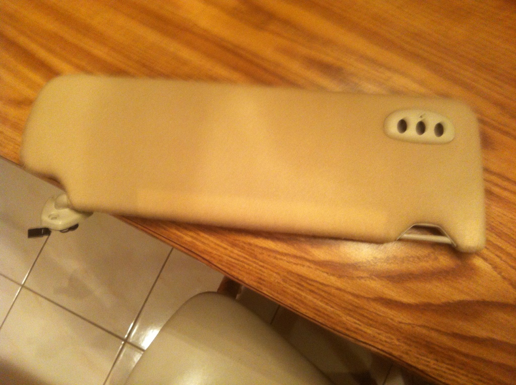

I have a console from an 98 XJ8, it opened the garage doors. It was a simple plug-and-play.
HOWEVER, the dome lights worked in reverse. The lights were on when the doors were closed, and off when they opened. The ribbon cable from the switch pack to the opener module was different, so I switched out both the buttons and the module. Ended up switching everything back, and put a used Homelink module in the driver's visor.
Jaguar Homelink Photos by mgb4tim | Photobucket
