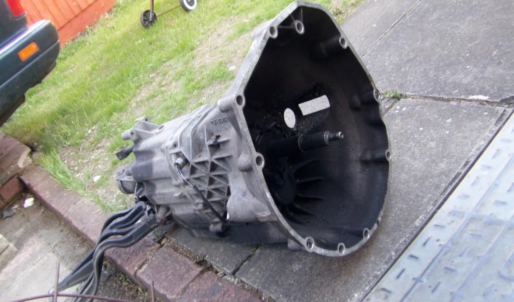

Hi guys! I decided to finally remove that meowing gearbox out of my Jag, following the procedures in servicing manual, I got to the point where I have the crossmember supporting the rear of the box unbolted, the rubber mount unbolted as well, it said to lower the gearbox, so I did, and then the next step is to remove the crossmember and rubber mount completely. There were 3 bolts holding the rubber mount, 2 bolted it to the crossmember and one in the middle bolting it to the box. And 4 bolting up the crossmember to the chasis. Now, am I being retarded or just not using enough force? The manual doesn't say how exactly I'm supposed to remove them, now the crossmember is dangling from the rubber mount, and the rubber mount doesn't want to budge, stuck on the gearbox. I tried wiggling, prying... I just don't want to break anything there... HELP ME

I'm not sure I understand exactly, Did you manage to remove the 3 bolts that hold the mount to the cross member? If so, use a pry bar to lever it, but be careful the whole assembly may come down on your head!!
I would put a couple of bolts back in the crossmember to hold it to the frame, jack up the transmission a bit to take the strain off the mount, remove the mount bolts and then use a pry bar to give it some persuasion if necessary.
Ok, just tried that, at different angles, with longest pry bar I've got, still nothing... I guess I'll get the whole box with it out of the Jag and maybe then I'll figure something out... I can post a video of it if you want, but don't think that'll help much...
Ceers BigBoss! I haven't been around here for quite a while, Jag's been sitting on the driveway since November last year, and been really busy with college and work, but now I've got some spare time, so trying to get that bugger out, and college told me I can bring it in and change the bearings there, in their workshop, isn't that cool? Of course I'll try to snap some pictures, but lately I've been concentrating on videos, to which I'll post links here as well... And no, I'm not filming them with a potato any more, so they should be a bit closer to actual HD quality
Now I'm stuck on unbolting actual gearbox from the engine... And there are 2 bolts at the top of it, which I can see, but the access is rather difficult and I'm really struggling to get them to move... I've got extensions and breaker bar, but the socket doesn't want to sit straight on it because of the shape of tunnel above the gearbox. Even though the end of the box is quite low now, I just can't seem to get them bolts to move... Eh, I think I'll have a short break, find some food in the fridge, maybe a beer, and then try again...

Just when I thought that all the bolts and nuts on this Jag were metric, the ones securing gearbox to the engine turned out to be imperial!!! I tried 13mm but there was too much play, then I tried 12mm but they wouldn't go on. After cursing for rather long period of time, I decided to try 1/2 inch... And guess what... Spot on! I'm still fighting with those buggers though! I've got a bad feeling that I won't get it out today

I've had no issues with clutch, only with the bearings in the box. And the box is still not quite out, as because of college + not very pleasant weather, I had to suspend the works on it. I'm still fighting with the bolt at the top, trying to grind it off with a dremel, it's taking a lot of time, access rather limited, and can't get anything bigger (like angle grinder) in there.

It is really much easier to take the engine and gearbox out together. Yes you will have to remove a few more things, drain coolant etc. but none of that is hard to do. Plus you can use it as an opportunity to do other maintenance and clean the engine/engine bay. I reckon it will take half the time of just dropping the box. You can rent a hoist by the day quite cheaply probably 10-20 euros.

Hi FireCrow, Too Good !!
Please tell me, since you finaly did the job, is there enough place if you just pull the gear box back (without removing it), to replace the clutch disc/pressure disk/bearing in the flywheel ?
I'm going to do the job under the car, in a channel (imagine a narrow deep grave...), so if i can do it just pulling it back and not removing it, it will be easier, supporting it on transverses at the sides of the channel.
The yoke i see in the photo is the only thing to be disconnected from the gear lever, correct?
Did you find out your bearing problem in the gear box?
Please describe the symptoms drove you to bearings problem.
